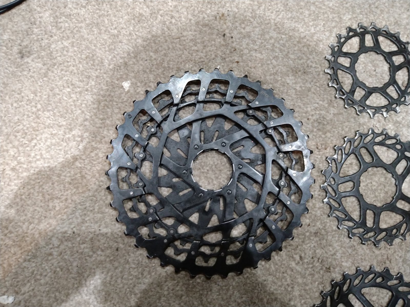

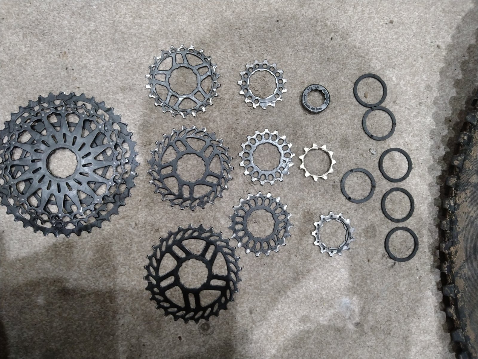

Hi,
New to the site and ebikes, I've just acquired a 2019 Turbo Comp Levo. It came from my cousins estate!
It came with the rear wheel and cassette off the bike and just working my way through things to get it back up and running. I have the SRAM PG1130 Cassette and a FH-521 freehub, I'm clearly missing a spacer or something as the cassette slides on the freehub when installed.
I've tried a spare 1.85mm spacer I had, however that is too big, and won't allow the 11th gear onto the freehub.
My question is what am I missing, I have all 11 cogs (3 fixed) and 6 black spacers, along with the locking ring?
Thanks
Ben

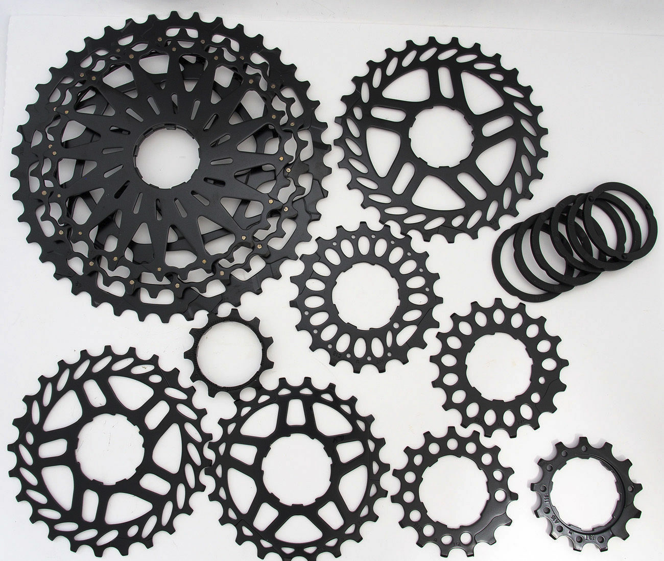

AFAIK you don't need a spacer behind largest cog on this setup. Here are parts of the cassette + lockring (not on the photo):

Thanks @salko, looks exactly what I have, I've seen those images, 6 spacers like I have, but I just wondered if a spacer wasn't photographed.
I can't find much detail on the spec of the freehub though, and notice later bikes were 12 speed, which got me thinking I needed a spacer.
It doesn't look like a new freehub as it has marks on it, cassette was off, and looks a bit worn, but wanted to get the bike up and running to work out what it needs

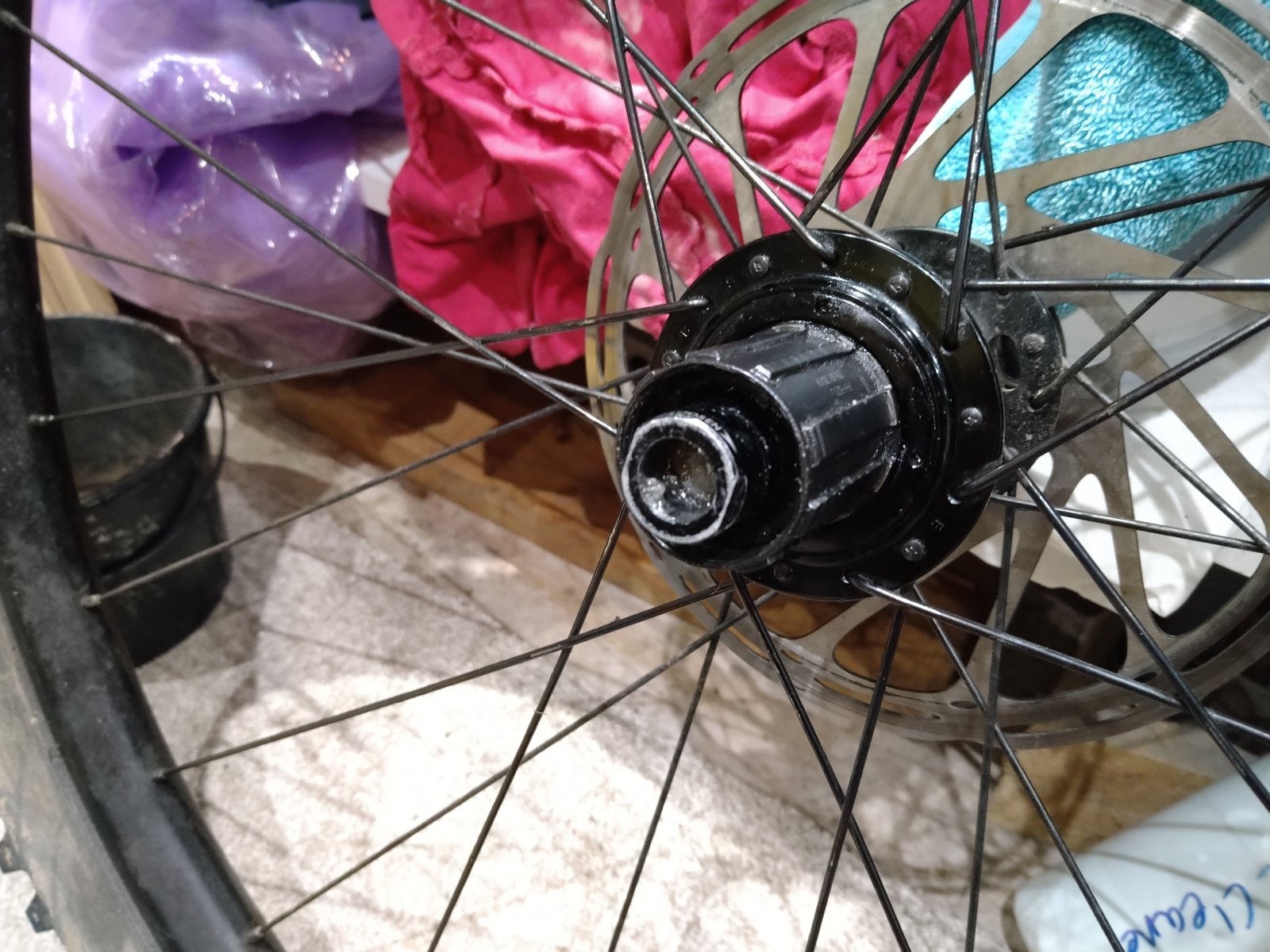

Can you take a photo of a freehub and cassete if we'll see something obviously wrong?
BenP
Jul 11, 2022
Thanks, I'll give it another go and see what happens.

I had exact same setup before upgrading to Eagle so I'm pretty sure there is no spacer needed behind the lagest cog in this setup. Maybe your end nut on the axle is not tightened enough so freehub body has some free play together with a cassette?

to confirm the only spacers are the ones between cogs. Are you sure the cassette is sliding on the freehub ? The freehub iself may be loose on the axle. I would check that the axle is correctly installed. The axle is tensioned against the nondrive side bearing by a cone nut and lock nut on the non drive side. The cone nut should be tightened until you start to feel some resistance of the axle rotating, then backed off a quarter turn...thenthe lock nut tightened against it. Fit the freehub next. On the drive side the adjustment of the freehub on the axle is done with a singel cone nut ( usually silver coloured) and is counter clockwise to tighten. Adjustment is achieved by snugging that up and then backing off (clockwise) about half a turn. The freehub should now have no side to side play and the axle should be freely rotating. Next fit the cassette and cassette locknut ( 40nm) .

Yes thanks as well, I'm going to give it a good going over this weekend, with a new cassette and chain.
I'll post back with what happens, but appreciate the advice and tips, small steps to understand why it was in bits.....
BenP
Jul 11, 2022
Well ended up new bearings in the rear axle and freehub, and new cassette and all back together and working fine, need a new lower jockey wheel as it has a lot of play
