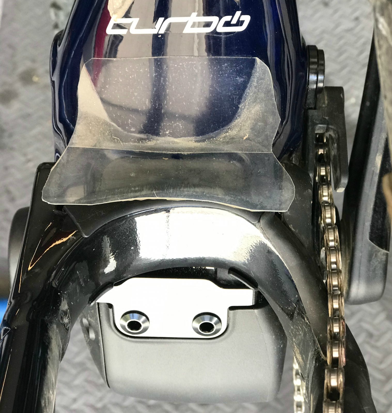

Wanted to give a “shout out” to @Al Boneta at Orange Cycle here in Southern California. I purchased a 2018 Levo there December ’17 and bought a 2019 Levo in January this year to accommodate the new 700Wh battery. Both bikes have performed without a hiccup likely due at least in part to Al’s service skills.

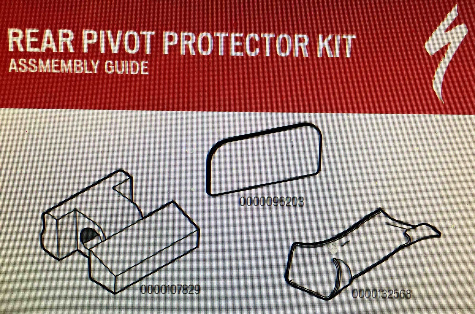

Al contacted me this week to let me know he had some upgrades for the 2019 model that I might like and that they would be covered by warranty: new 4-bolt motor covers (supposedly better fitting and stronger), a revised rear suspension link (to reduced the chances of pebbles being caught against the seat tube), and a new rear pivot protection kit (to keep stuff from getting into the gap in the motor housing). I hadn’t seen the new pivot protection hardware so I’ve attached a screenshot showing the part numbers and a photo of it installed (below).
The inside of the motor housing on my bike was clean except for some dust, likely due to having the v.1 sponge installed together with the crude helicopter mud flap I fashioned to cover the gap:
The new protection kit uses a v.2 sponge with denser foam and plastic parts that clip onto the frame and swingarm to fill the gap. Here’s what it looks like when installed, (mud flap is taped up to show the clips). It covers the gap while allowing the swing arm to move over it - tight ‘n tidy!
Props to both @Al Boneta and Specialized!

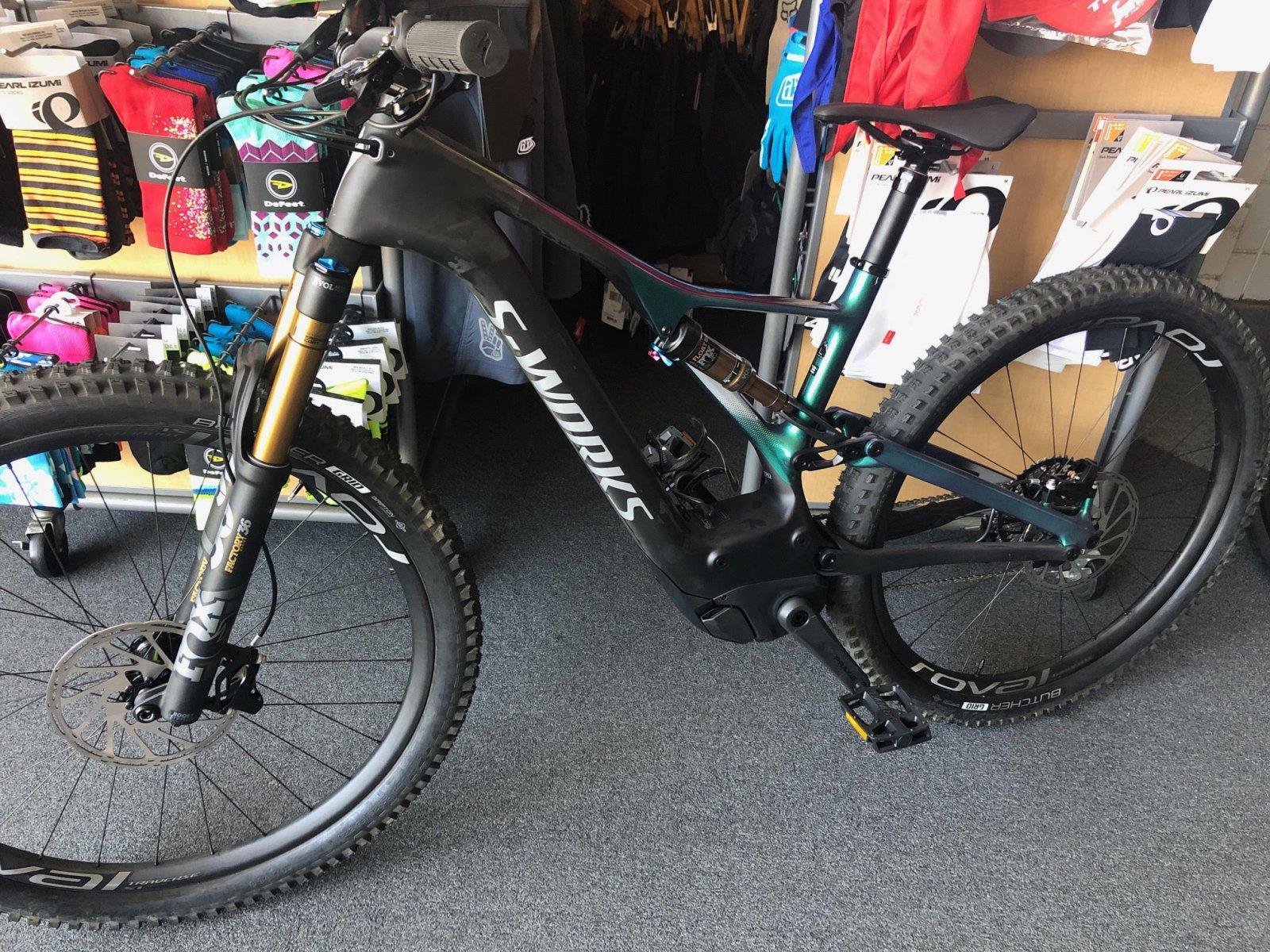

BTW, a very sharp looking Monster Green 2019 Expert Levo (size Large) sitting on the floor caught my eye, so if anyone is looking for one...

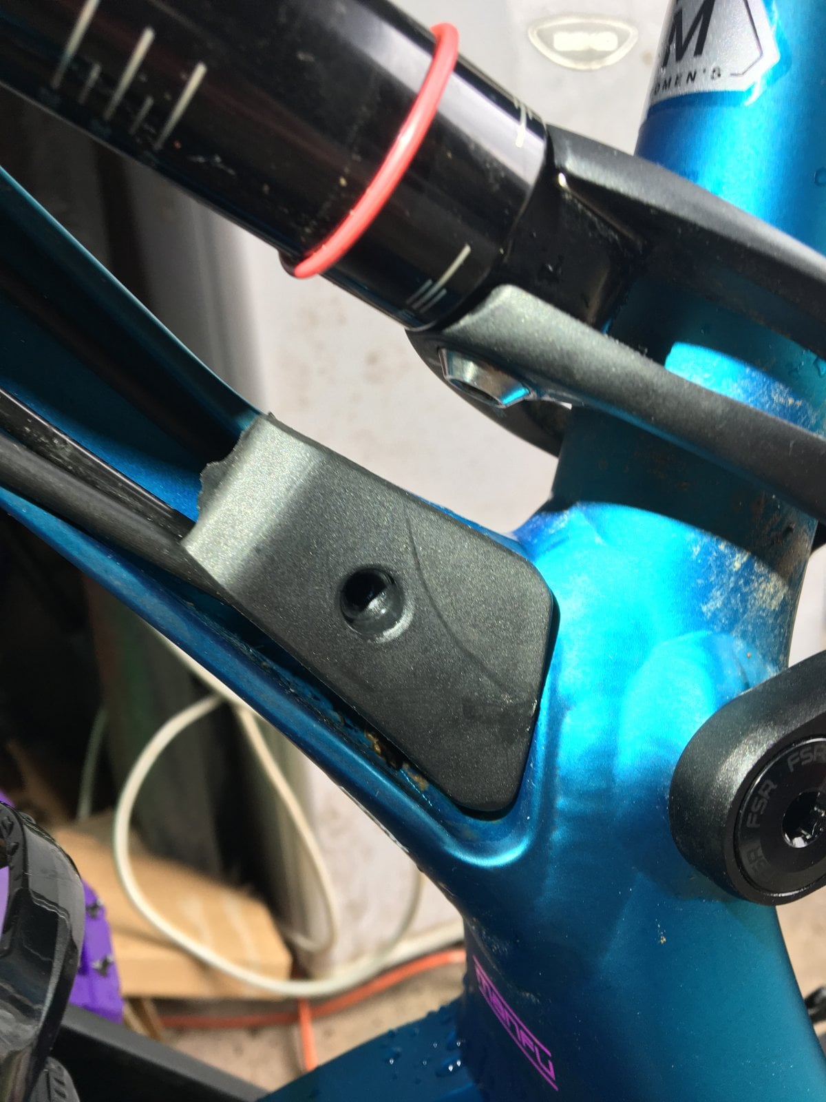

I’m trying to fit a dropper post and I think I need to get this black plastic cover off to route the dropper cable. There’s an Allen bolt which I’ve taken out but the cover still won’t come off - it’s like it’s plugged into the frame. Anyone help? Thanks!
It won’t come off, you need to thread your cable through the top gap, it’s sort of fixed as the other two run through the moulded cover’s back.

Mine just came off when i took the bolt out, also its worth making sure you get the dropper routing right, if you dont get the loop in the right place and just feed it directly up the seat tube you my not be able to get the seat post to go in as far as you need. Somewhere on here there is a specialised document showing the routing of all of the cables

Stupid question , but why on the carbon frame is it solid with no removable bit , if not needed why have it ???
Mine has cable routers moulde I’m on the back, hence not remo
I managed without the loop, but the “oneup” dropper is quite short.
its odd they are different mine has cable routers but the cables just clip into them, they are not through eyelets so to speak.
I wonder why they made different versions!! especially since on the carbon frames there is no "clamp" in that position so there doesnt seem to be a reason to pin the cables down except to just keep them neat
Mines aluminium, they are hydr formed as opposed to moulded CF, probably the difference

do you mean the frame or the fitting? my frame is aluminium the fitting is moulded plastic
