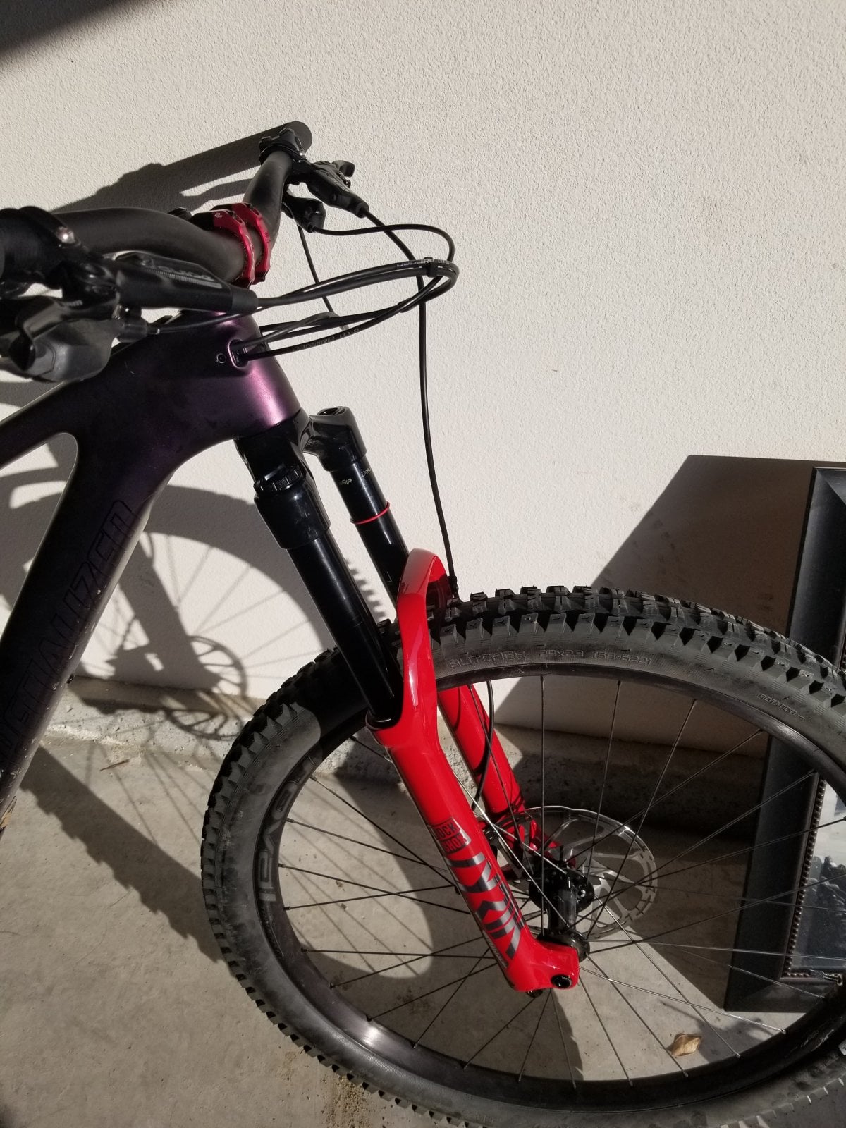

Lyric Ultimate 160mm 51mm offset for me.
Love it!
That, with a Super Deluxe Ultimate on the rear have made it like a completely different bike.

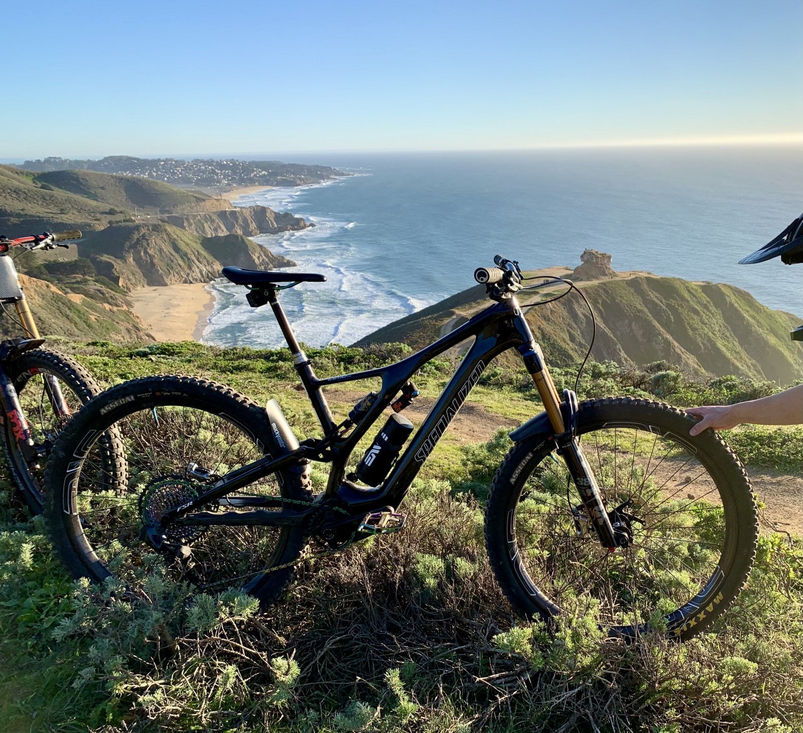

Manitou mezzer . Great fork. Stiff as the 38s (or too close to call), lighter by a few hundred grams, better air spring (IMO) with the dual positive chambers, and adjustable internally travel. I currently have mine at 170mm but can go from
140-180 without purchasing anything else.

I have also updated my Lyrik to ultimate and 160mm. Like it much more now and it is inspiring more confidence... Hope not too much :)

I couldn't get anywhere near the correct sag at max psi on the 34's so the day after buying a Levo SL is bought the 2021 Lyrik ultimate 160mm 51mm offset. They're super plush and absorb anything I hit with them. I'm 240lbs and run 105psi with 28% sag and have room for another 60psi. They're quick to dial in and easy to adjust on the fly. I prefer them over the 36 factory I had prior.
Do you prefer 170mm more than 160mm for levo SL? Do you think of going back to 160mm at one point? Geo wasn't adversely affected or did you use offset bushings? I'm currently running 150mm on mine (lyrik) and debating whether I should go 160mm or 170mm.
i have run 170mm for some time. For my style of riding with lots of steeps and “enduro” trails, the slacker hta and added travel is a benefit. I run a bit more sag on the fork so the overall ride height isn’t that different than 160mm. The bike also feels a b it more balanced given that I am running a ext storia and cc link which makes the rear ride like it has more travel
I am running an offset bushing but it’s to make the bike slacker.
I am actually at 63.6 deg hta right now in a mullet configuration. Really like how the bike is riding right now. Though I will probably go back to full 29er in a few weeks.
If you primarily like mellower trail riding ... 170mm probably doesn’t make much sense. But if you can, it’s worth to experiment

Cool, I ordered a 170mm shaft and will swap it out this weekend. But gotta say 63.9 hta on a levo SL sounds wicked lol. Is the mezzer pro better than lyrik ultimate? Been thinking of getting one instead of my possible lyrik + runt + B1 shaft (not C1) combination.
Personally I think the mezzer is better:
stiffer chassis
More adjustable airspring
Better damper for most scenarios
I did have a 2019 lyrik that I modified with and additional air chamber and push hc97 damper. It was close but the mezzer still win for my riding IMO. Lyrik may have been slightly more sensitive off the top, but I really don’t feel that in the trail

Update: Pike weighed in @ 2,140g after ACS3 conversion w/ 20ml per side Motorex 10wt Fork Oil and black spring.
Currently running 25 psi in bump stop which is very supportive yet fork is super plush. Even at 160mm Pike has been great with no flex noted although am using full travel with hucks to flat (Pinkbike style). May try gray spring, but will try more psi first as I am good right now, but plans call for bigger hits...
Bike still handles and climbs great w/160mm fork. Better imo as I prefer the slightly slacker HTA.
