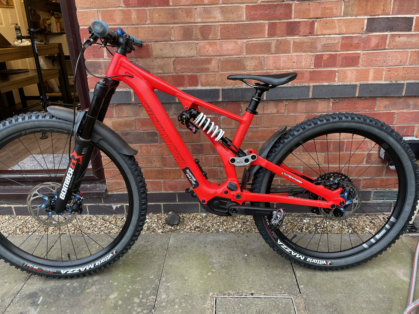

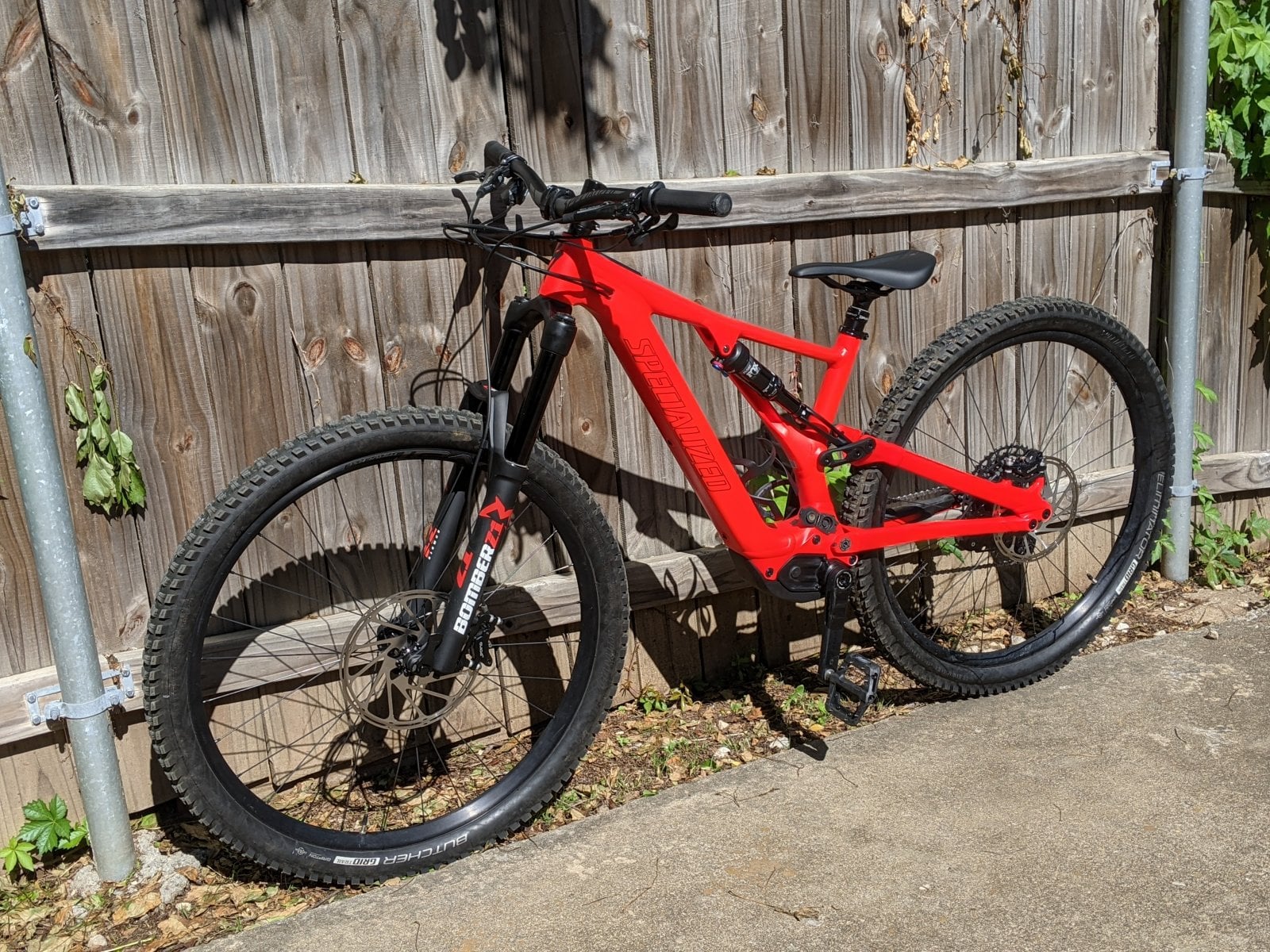

Just installed a marzocchi Z1 coil, 44mm and 160mm travel....had it on my giant but swapped it over to the SL....it's fantastic.
