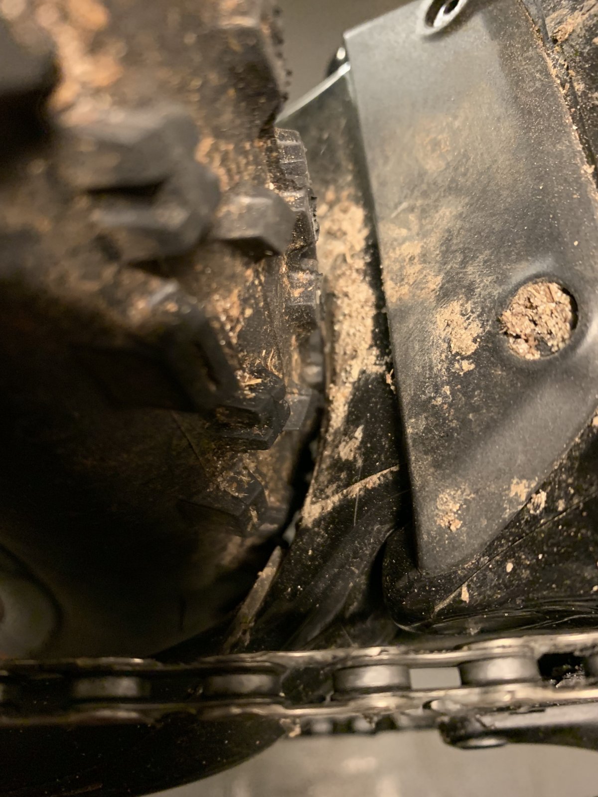

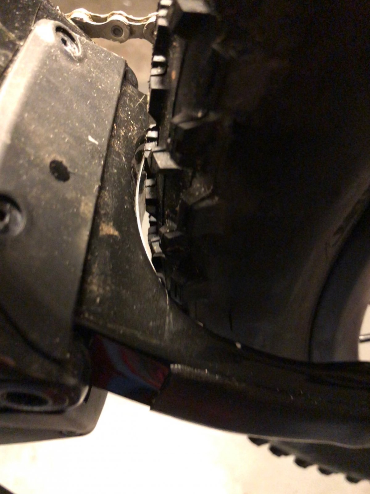

I went the 29" way with my Levo and I love the way it behaves but having a severe space issue, I'm running a Maxxis Ardent TR EXO 2.4 and I have about 2 mm of space up towards the engine. That is with 30 Psi and do I lift it to 40 Psi(for the seldom asphalt ride) it will make contact. My rims are 25 mm internal width and I guess that I could flatten it a bit with a 30 mm internal width but again, maybe I gain another 1 - 2 mm by doing so. Those of you that are running 29" what tires/internal width do you have and how much space do you have up against the engine(Lower triangle, front part)?
This it how it looks right now:

Those rims are not designed for 2,6
2.6 do not need 30 PSI
Without a car i pedal to the trails and back with one pression 13 PSI last 7 weeks.

There are absolutely no issues if you want to run it mullet style, issues are at the back and especially if you have the expert or comp carbon.
Karsten
Thanks Karsten
I figured out that the problem was at the back after reading a bit more. I fitted the wheel from my Trek Remedy to see how I like the ride and so far it feels great.
