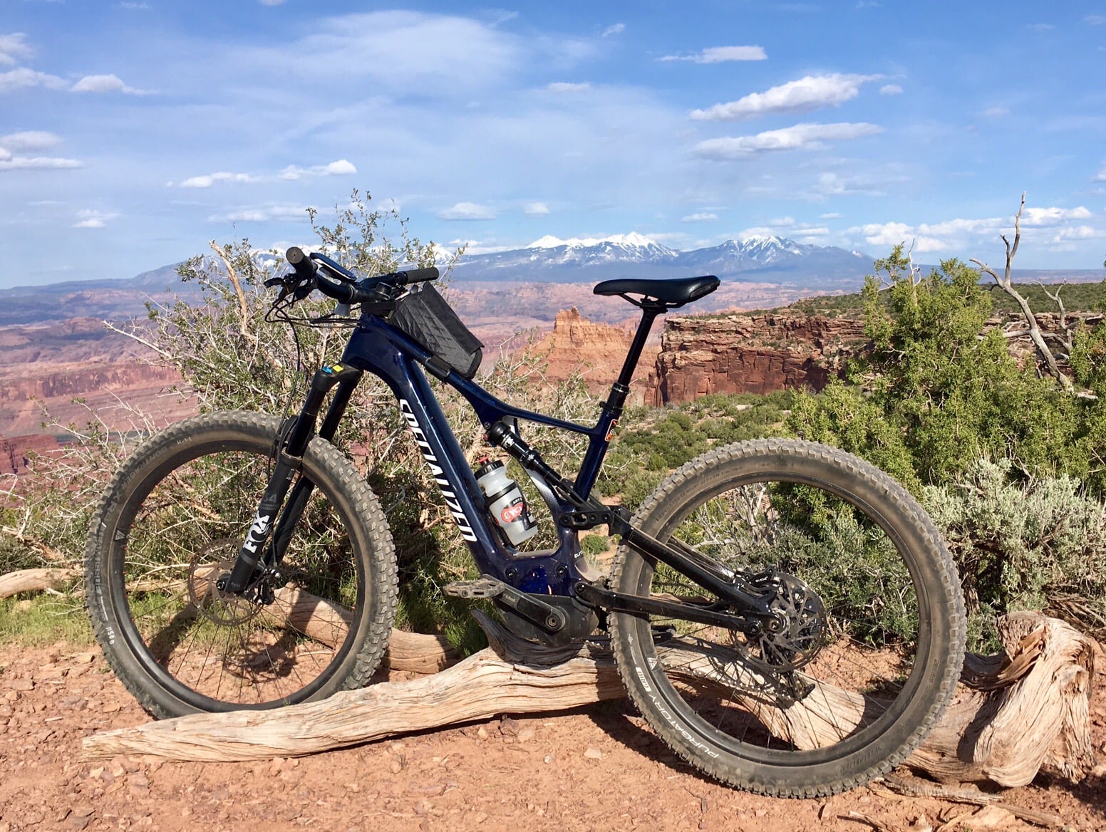

Mrs levity and I run mixed 29F/27.5R wheels on our Levos. We wanted 3.0 rear tires for extra cushion and traction and because we ride is sandy conditions in the desert in winter and a 29x3 won’t fit in back.
Here’s a pic of my ‘19 with a 29x3 Bontrager XR4 in front and a 27.5x3 Purgatory in back. I left the fork at 150mm and set the flip chip in the high position to keep the bottom bracket up and not make the front end too slack. Very happy with the handling.
thank you for this post!!! love my mullet setup on my 2017 with the 3.0 putgatory in the rear. in the market now for a newer levo and happy to hear i can keep it!!!

2021 update - im laughing at the mullet h8 on here🤣 22 levo = mullet + 160mm cranks. (my setup since 2017😎 ride watchalike! i also had wide, goofy handlebars in the 90’s. haha at narrow bars😂
