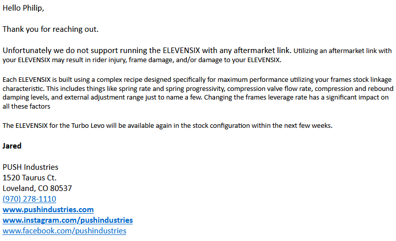

I recently asked PUSH regarding 2022 Turbo Levo and CC Long Stroke kit, requiring a 230x65 shock.
I'm a huge fan of Cascade links. Currently running one on my Dreadnought with a Storia V3 and loving it.
Thinking about the standard Cascade link for the Levo with 210x55 E-Storia coil shock. Seem to have the best vibes.
It's probably just me, but PUSH has had a consistent history of pushing me away. No bueno... (n)
