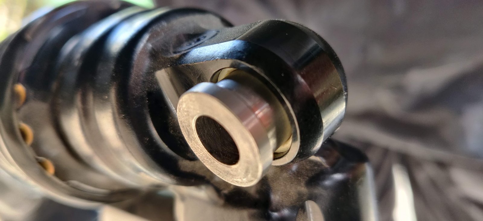

Play evident in the kitsuma after a handful of rides.
And the displaced upper bush View attachment 69110
Based on this I would not recommend, even though the shock feels great.
The supplier claim the play is ok & the bush displacement could be due to frame misalignment... I kind of wish it would fail so I could get a refund.

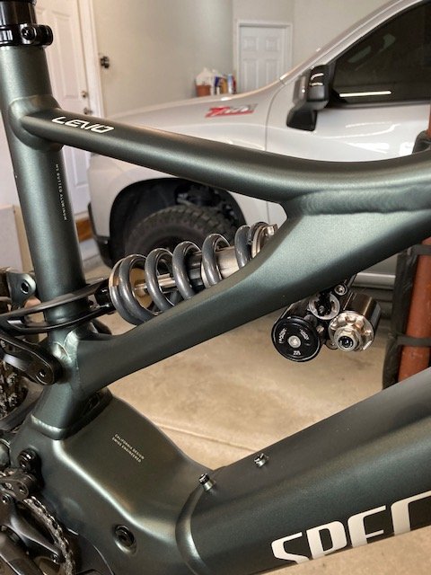

Just ordered an EXT eStoriia 210 x 55 for my 21 Levo Comp....gonna see how this works out. My biggest fear is that the forks will feel horrible after putting the shock on, lol.
I will also say Mike from EXT USA has been amazing to work with and their customer service seems top notch! They are not afraid to spend all the time you need on the phone to help you with understanding exactly what you need for your bike, etc. Top notch!
CRFan1
Dec 2, 2020
173
142
NW Indiana
Just put the EXT 210 X 55 Estoria on my 2021 Levo Comp and this thing is amazing. The ride is very supple yet controlled if I had to characterize it. The EXT USA folks were also amazing to deal with. (y)

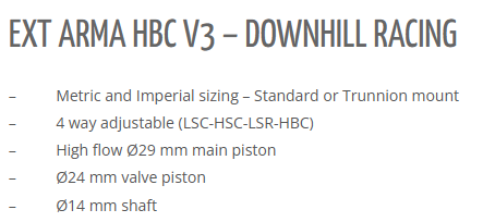

I've been running an EXT Arma all summer and fall, and I'm 100% happy with the change (not gonna call it an "upgrade!). My regular trails have a ton of washboard chatter that the EXT (and a Smashpot in the fork) have smoothed out considerably.

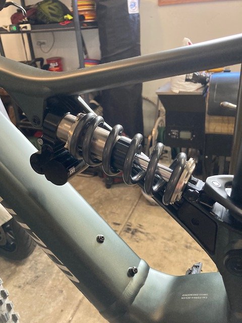

View attachment 78008 View attachment 78009
I'm considering the EXT E-Storia and I have the same bike as you. I had some concerns about reaching the HBC adjuster screw. From your picture, it looks accessible. Can you confirm that an allen will fit while the shock is on the frame. Thanks
Yes, every adjustment screw is acessible. No issues at all. :)

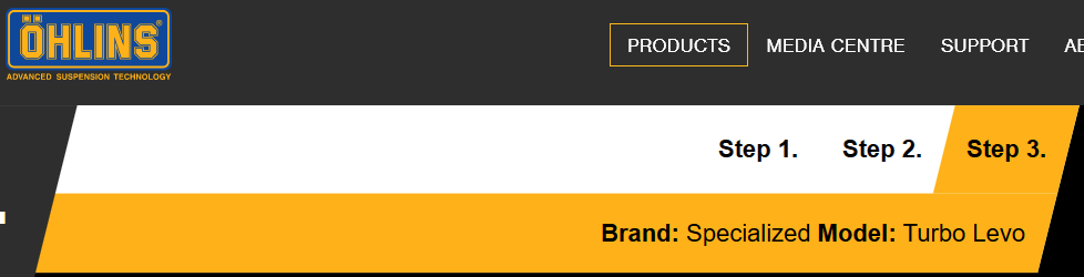

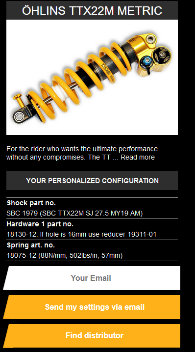

@Bigtuna00 , I don't know if this counts as an official notice of compatibility, but I entered Turbo Levo into the Ohlins website part recommender, and their TTX22M coil made the list.
FWIW, I'm currently running an EXT Arma which I am happy with except that my riding would benefit (I think) from a variable rate coil, and I have not found one that fits around the EXT shock body. That's why I was looking at Ohlins.
I'm 99% sure Ohlins is fine. What makes me hesitant is Specialized used offer Ohlins stuff on clevis bikes, but doesn't anymore. Why did they stop? (there can be many reasons of course)
It would be good to have someone from the company acknowledge it directly. Most all of these companies won't actively filter out any bike. E.g. Fox just has a blurb hidden in a technical article that no one would find if they were just shopping for a shock.
It could be the Ohlins calculator just has a database of eye-to-eye+stroke for as many bikes as they can...or it could be a *real* recommendation. I'd like to be sure for this list (as sure as we can).
