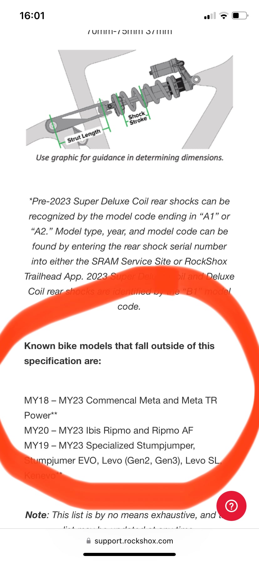

I do think so but, this side is weird because of the structure.
„Known bike models that fall outside of this specification are: ……. „
For me this part relates to the previous Coil Version, am I right?

Yes, the new RS SD Coil supports Levo:
Is a RockShox Super Deluxe Coil or Deluxe Coil rear shock compatible on my bike?​
Coil shocks work best on bikes that have a more progressive leverage rate. Some bike manufacturers may not recommend using a coil shock due to a frame’s linear leverage rate or particular fitment issues. Consult your frame manufacturer to confirm. An air shock may still be preferred due to your frame manufacturer’s suspension kinematics.
2023 Super Deluxe Coil and Deluxe Coil rear shocks were designed from the ground up, in part due to the additional stress yoke/strut designs can put on coil shocks. As such, we have qualified 2023 coil rear shocks for use in these applications. There are 2 known bike model exceptions to this: Commencal Meta TR Power and Specialized Kenevo. These two bike models are only compatible with a Super Deluxe Air shock OR a MY23 Super Deluxe Coil shock WITH a steel shaft.
The old / previous generation RS SD Coil should not be used in Levo:
Pre-MY23 Super Deluxe Coil (A1-A2)
Pre-2023 RockShox Super Deluxe coil shocks* are not compatible with yoke/strut lengths that fall outside of the below specification:
Shock Stroke Maximum Strut Length
40mm-45mm 118mm
50mm-55mm 90mm
60mm-65mm 72mm
70mm-75mm 37mm
*Pre-2023 Super Deluxe Coil rear shocks can be recognized by the model code ending in “A1” or “A2.” Model type, year, and model code can be found by entering the rear shock serial number into either the SRAM Service Site or RockShox Trailhead App. 2023 Super Deluxe Coil and Deluxe Coil rear shocks are identified by the “B1” model code.
MY18 – MY23 Commencal Meta and Meta TR Power**
MY20 – MY23 Ibis Ripmo and Ripmo AF
MY19 – MY23 Specialized Stumpjumper, Stumpjumer EVO, Levo (Gen2, Gen3), Levo SL, Kenevo**

Dont get me wrong, but the post above says, that the steel version is only necessary for the kenevo. Thats why I am confused about all these different infos. But the post above is from the official Sram webside.
"2023 Super Deluxe Coil and Deluxe Coil rear shocks were designed from the ground up, in part due to the additional stress yoke/strut designs can put on coil shocks. As such, we have qualified 2023 coil rear shocks for use in these applications. There are 2 known bike model exceptions to this: Commencal Meta TR Power and Specialized Kenevo. These two bike models are only compatible with a Super Deluxe Air shock OR a MY23 Super Deluxe Coil shock WITH a steel shaft."

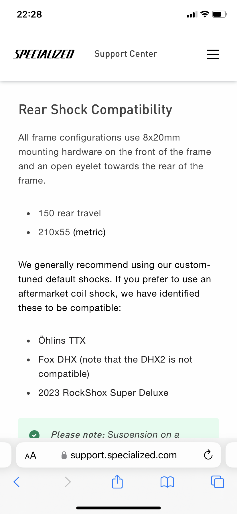

I contact Rock Shox and they say this:
Hey Andi,
Thanks for reaching out, and I hope you're having a great week!
We don't currently offer a custom-tuned 210x55mm shock for the Specialized Turbo Levo. Because of this, it will be best to use part number 00.4118.455.004 (Rear Shock Vivid Coil Ultimate RC2T - (210X55) Reb55/Comp30, Adj Hydraulic Bottom Out, Lockout 2 (Spring sold separately) Standard Standard - C1).
