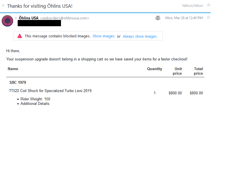

I think this email from Ohlins-USA may count as an official endorsement of using their coil on our Levos. I went through the online purchase process but didn't do the credit card part.
RebornRider
May 31, 2019
648
665
NorCal USA
That's an automatically generated email because you left something in the cart. Means nothing. Why not just email Ohlins and/or Specialized and ask??
Why did you assume I hadn't?
No response yet.
Also, it's not the email itself that's significant. It's the item listing.
Added, FWIW ...
