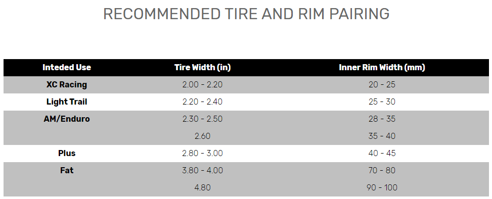

They only come in 2.3 though. Question is, anyone fitted a 2.3 rear to a 35mm rim and if so how did it feel / perform ? Thanks
9,158
9,646
I'm not going to comment on the tyre itself, but I believe that you will find this chart from WTB to be helpful with respect to the tyre width vs rim width question. The 2.3 width tyre (58mm) to a 35mm rim width is inside the "optimum performance" band.
Page down to the second chart; it covers mtb tyres.

Thanks Steve, that’s helpful. I’m finding on my own ‘googling’ research that some are saying 2.4 is the minimum recommended size for a 35mm rim, others say 2.3 is fine, hence my question earlier
The Maxxis USA site has a chart of recommended sizes: Minion SS | Maxxis Tires USA
So 2.3 width on 35mm rim is in their recommended range, but at the end.
