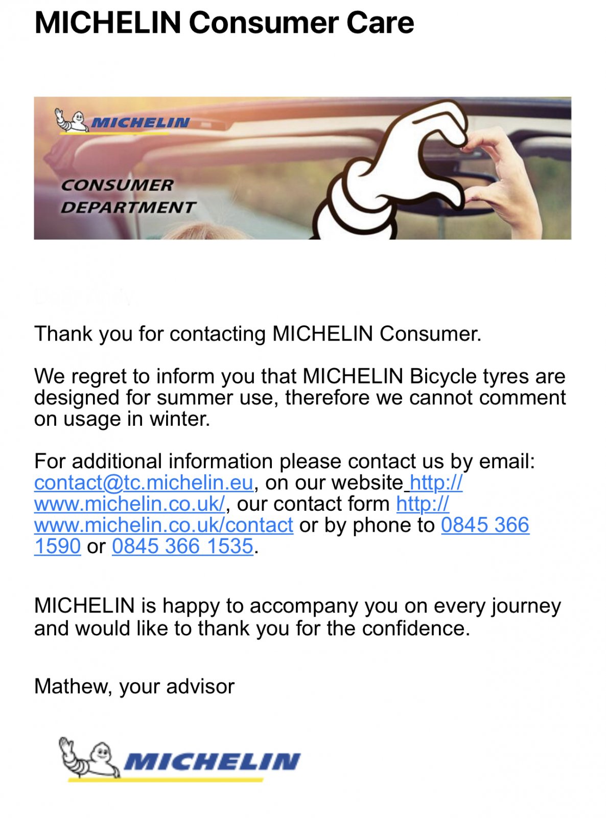

Quite an amusing reply I got from Michelin when asking them what the rolling resistance differences between the Wild Enduros and the E-Wilds are:
14,166
21,072
I had to put the reply into google translate and it said "Michelin Tyres are not suitable for use in the United Kingdom" .. :)
I'd say the Wild Enduro's have slightly less rolling resistance than the e-wilds - but then they're thinner and I've not used the e-wilds for a while.
