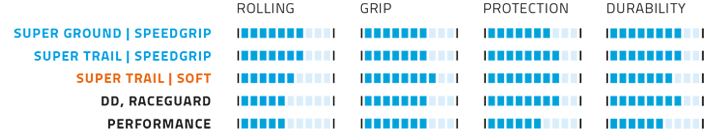

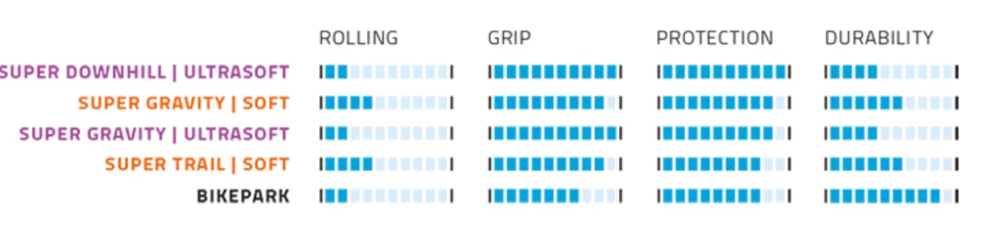

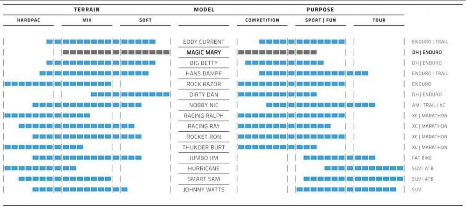

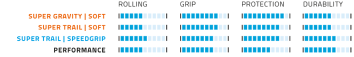

It’s not easy this tyre thing, I placed an order for MM/BB from Germany so they should arrive next week and I’ll be able to get out again but you really do need two sets of tyres to manage all occasions I think....
This is one of the best guides pinning some of the best tyres down
I didn’t realise that not only does softer compound reduce durability but it also reduces battery power since it increases rolling resistance so on those larger days stuff like Magic Mary/Big Betty might not be great, but then the DHII are great for XC but the rear crumbles when hit with rocky terrain etc (my dhr is destroyed after one big day of abuse).
This will say Magic Mary is crap on hardpack (this like road, rocks??) but for mud, shorter techy stuff there isn’t much out there that will beat it. I like rocky stuff so assuming how Rock Razor scores high I’ll assume it factors rocks and then Big Betty isn’t as good as Nibby Nics according to this which seem a good all rounder mincing tyre so I’ll get onto that.
I’d ordered ultra compound which looks a mistake if I’m after an all round tyre setup:
Magic Mary
So this kind of suggests ultra will require double the cadence to or in other words just take more energy.....this might be pie in the sky but I do know people with Eddie’s for example who have said they took a big hit with rolling resistance and now selling them.
Big Betty
So personally I’d be after less soft compound and more roll on the back so probably the super gravity as you get that extra protection although thr super trail would be handy too...
But here’s the catch, I do bike parks and XC, Ultrasoft will probably give the best grip and braking traction so that would make these sessions more enjoyable but for XC I’ll need a different combo to withstand the rocks
Nobby Nics
So Nobby looks more promising for XC and bigger days out, the soft one is one I’d pick, it’s the best all rounder that can handle hard stuff also.
Hands Dampf
Less durable and more rolling resistance than Nics...better in the soft stuff, worse in the hard....so for XC either might do but I’ll side with Nics.
So moving onto the front XC tyre!

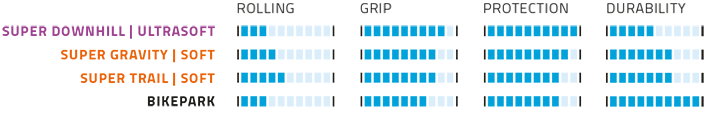

Magic Mary
Big Betty
Nobby Nics
Hands Dampf
Maybe the Assguy?

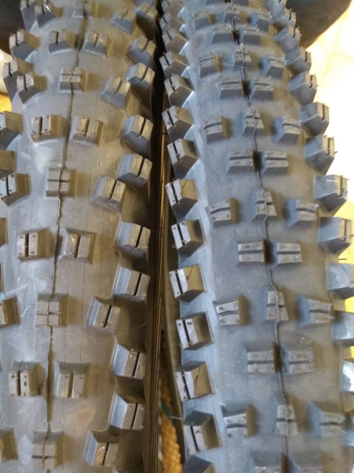

By the way, I have a pair of WTB 27.5x2.6 tyres new and unused. They came on the bike I bought for my grandson and I swapped them out for narrower, lighter tyres.
WTB Vigilante 27.5x2.6 TCS Light High Grip
WTB Trail Boss 27.5x 2.6 TCS Light Fast Rolling
Vigilante on the right.
If anyone has an interest send me a private message.

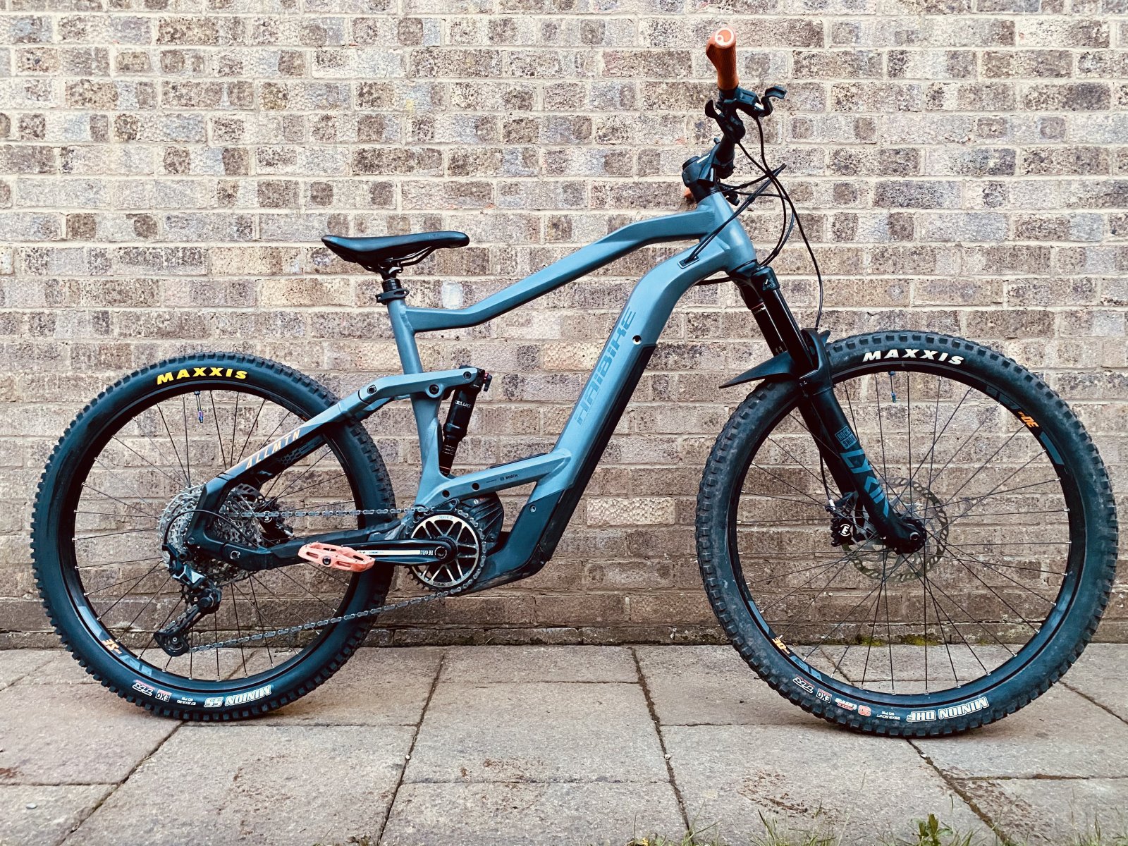

Just taken off my rear 2.8 DHR and changed it for a 2.3 SS. I’ve said it before on other threads but the DHR at 2.8 just felt far too grippy for me, slow, large & cumbersome. Chose the SS for the low rolling resistance and wanted the smallest width tyre available for my 35mm rim. It also seems to tick all the boxes for the varied terrain we ride. Also, when buying the Allmtn, I liked the appeal of the mullet set up for a playful rear end. It didn’t feel playful with a big fat grippy 2.8 tyre
Just went for a quick spin, admittedly only on tarmac and gravel paths around my neighbourhood , but it instantly felt a vast improvement. The bike feels properly balanced now with a wider 2.5 up front and a skinnier 2.3 at the rear. It never felt right having a wider tyre on the rear. Acceleration felt quicker, the ride feels firmer, and now I have a huge smile on my face
Of course the real test will be out on the trails on our weekend warrior adventures, can’t wait ???
