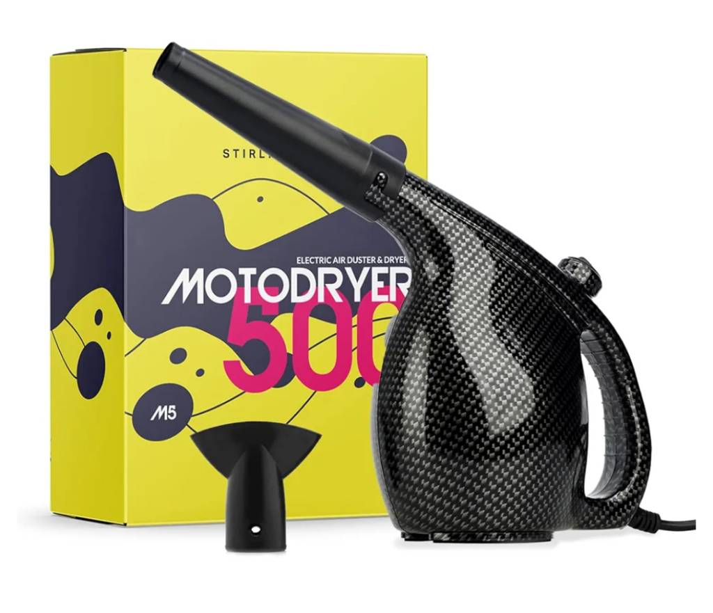

I also bought one of these a few weeks back that I'm finding really useful in drying the bike, does a much better job than I do with a towel. It's got great airflow which is quite powerful, has a few attachments to direct the air in different ways and the length of the lead is not bad. My only gripe with it is the power button is a press and hold.

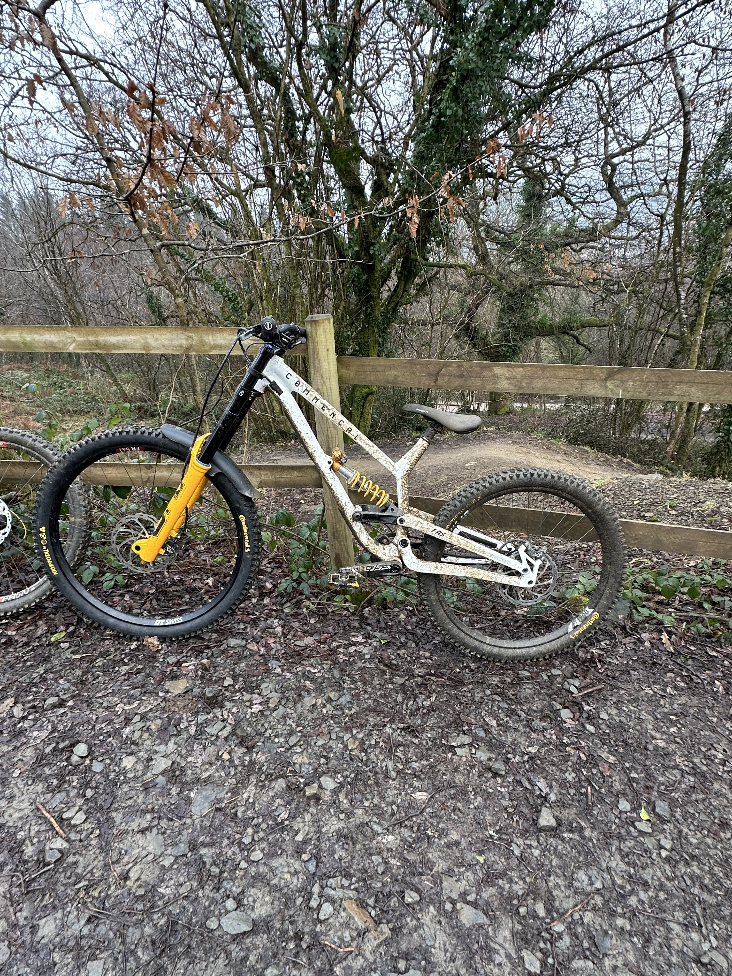

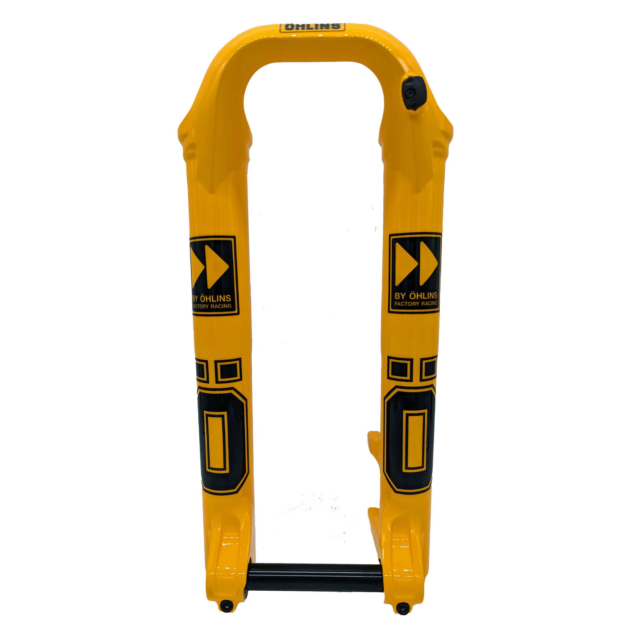

A lovely pair of yellow Ohlins factory race lowers for my DH38s, courtesy of the other half as my Xmas gift 😜.
They’re being fitted by J-Tech when they have the forks to do a custom tune in the New Year and I’m weirdly excited to see how they look on my KSL and my (analog) FRS.
Well they didn’t get to go on my ebike yet, but they look awesome so have a photo anyway 😜.
J-Tech have done a cracking job with the custom tune on the fork and shock, I don’t think I’ll ever bother riding stock suspension again as it’s just an exercise in aggravation (I find setting up suspension incredibly tedious).

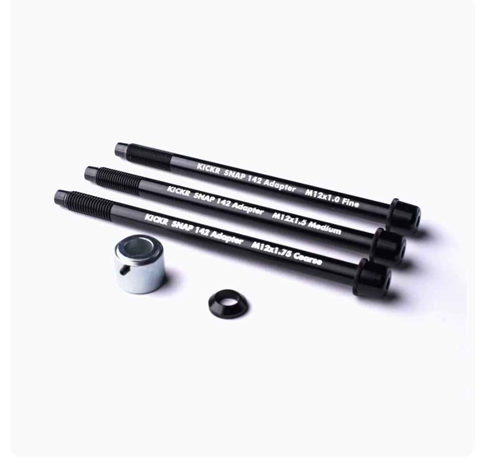

Hi! Here are 3 rear wheel axles, same length, same diameter but 3 different threads, 1/1.5/1.75.
I assume 1.25 is the thread pattern (if it's the right way to name it...).
