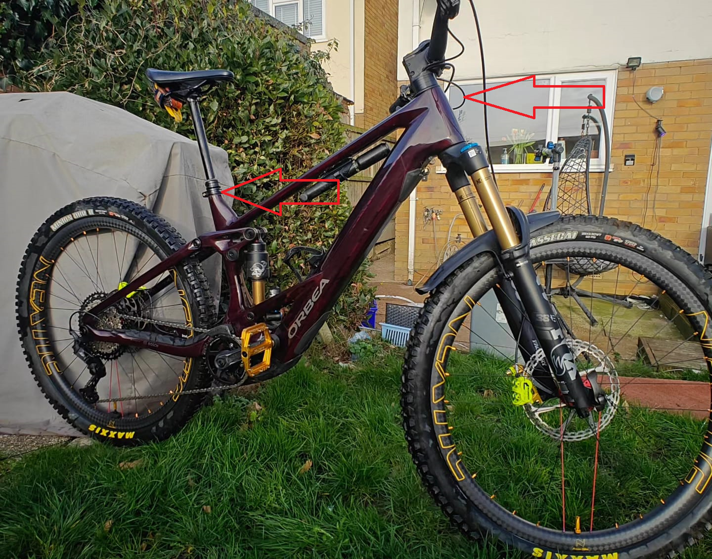

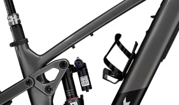

Hey beautiful people, I have a mount accessories (you know 2 bolts) on my bike, I just bought the oneup pump ... but there is absolutely no clearance with the bottle cage (dumb dumb) so it goes in my backpack which defeat the purpose - my fox38 is also apparently not edc compatbile f...it only mini which is useless to me.
I though of using a B-RAD Mounting Bases from wolf to lower the cage not sure it is lower enough nor really secure for heavy riding.
Not sure what I could use in that place, what do you use/bought?

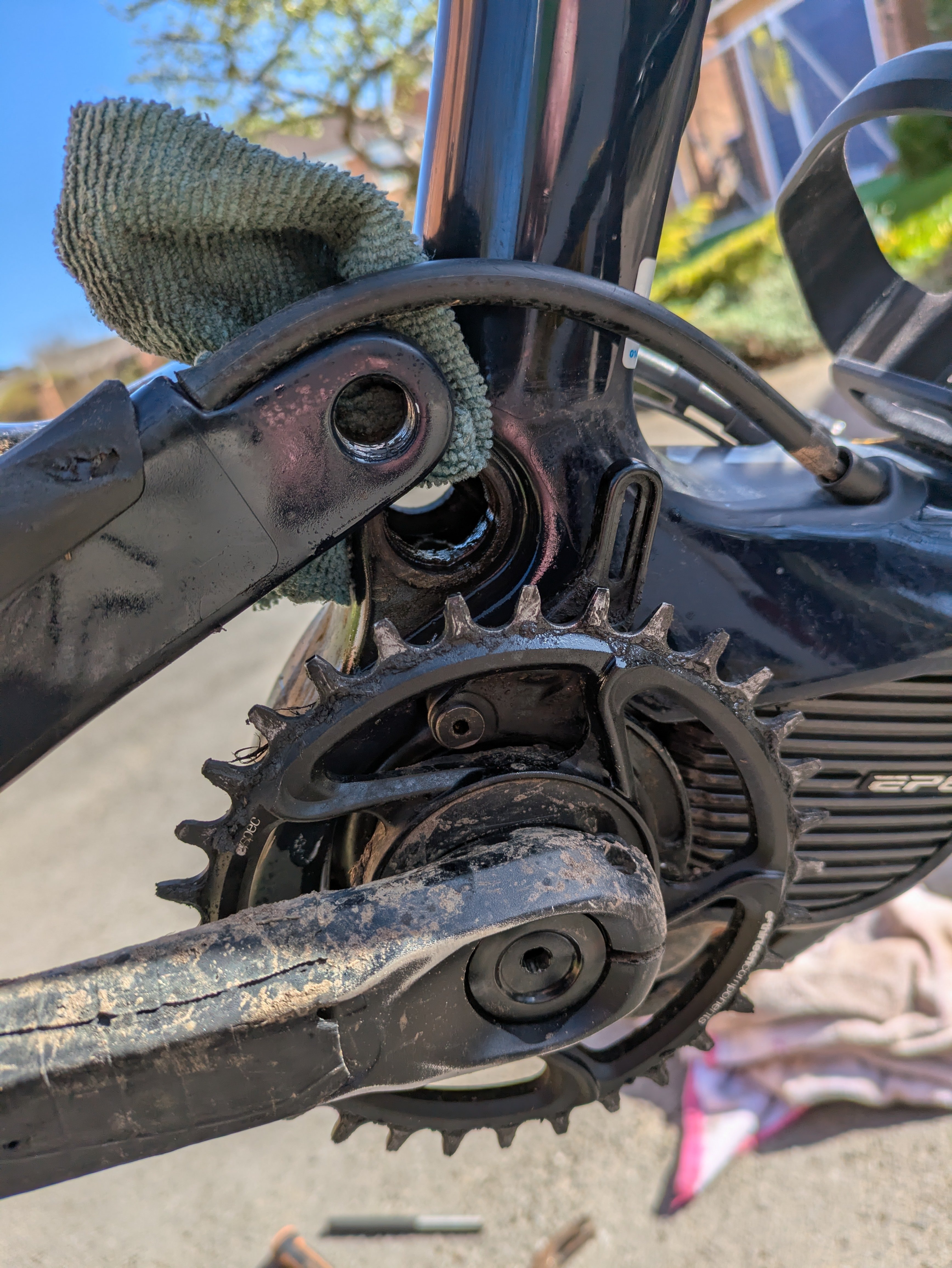

Had to tighten the spider lock ring as it had worked its way loose
Had to use a screwdriver and hammer as I didn't have the tool
If it comes loose agian, it will be getting locktited
You may want to replace the spider lock ring or castle nut with a new one. Because the nut is made of alloy the threads wear and stretch after being torqued a few times.
Some blue lock tight will help …but eventually it won’t.
I keep a few spare castle nuts, plus the torque is slightly increased on the new ones.
New castle nut with blue Loctite (243) with a telltale. YKIMS (y)

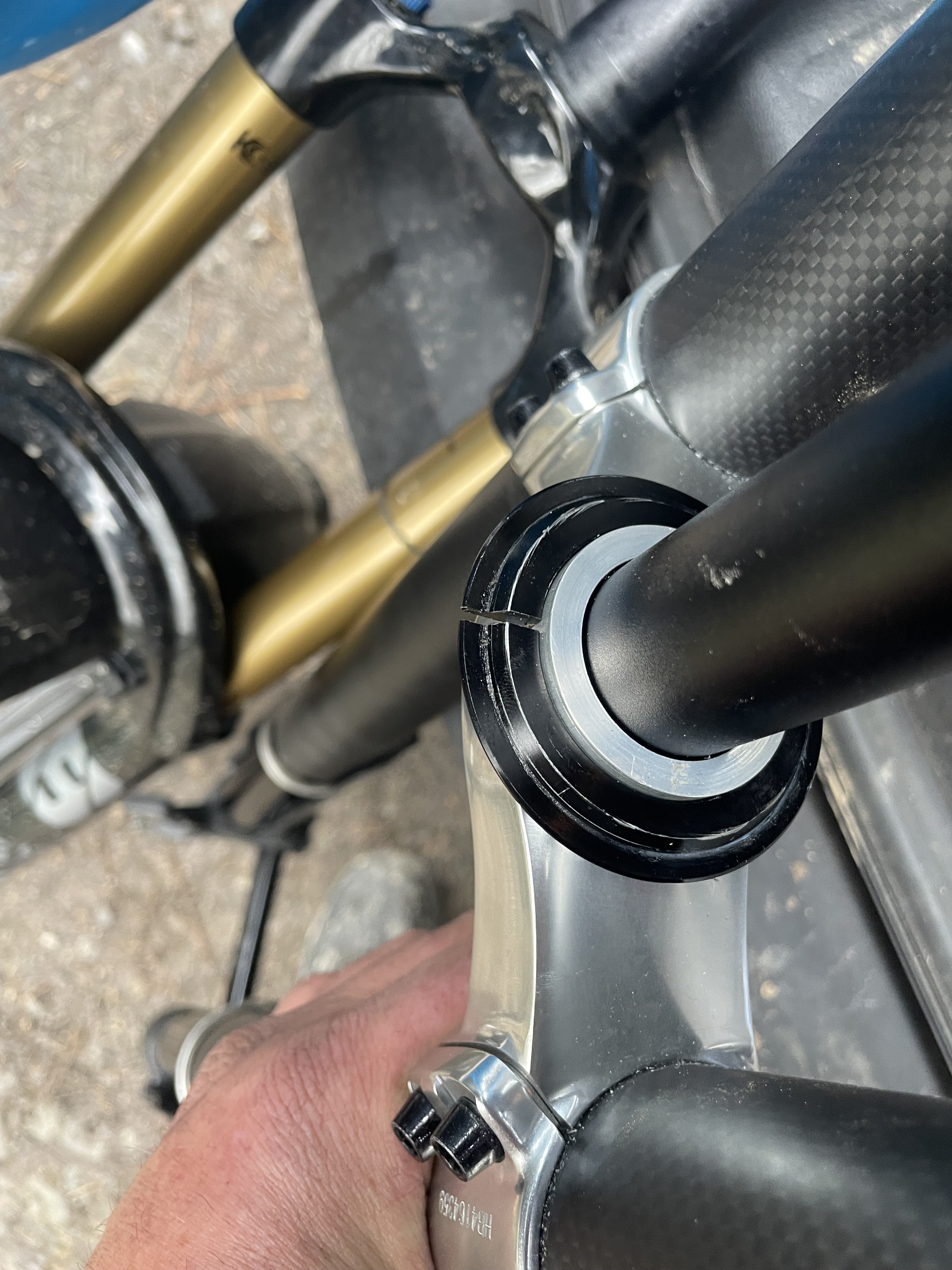

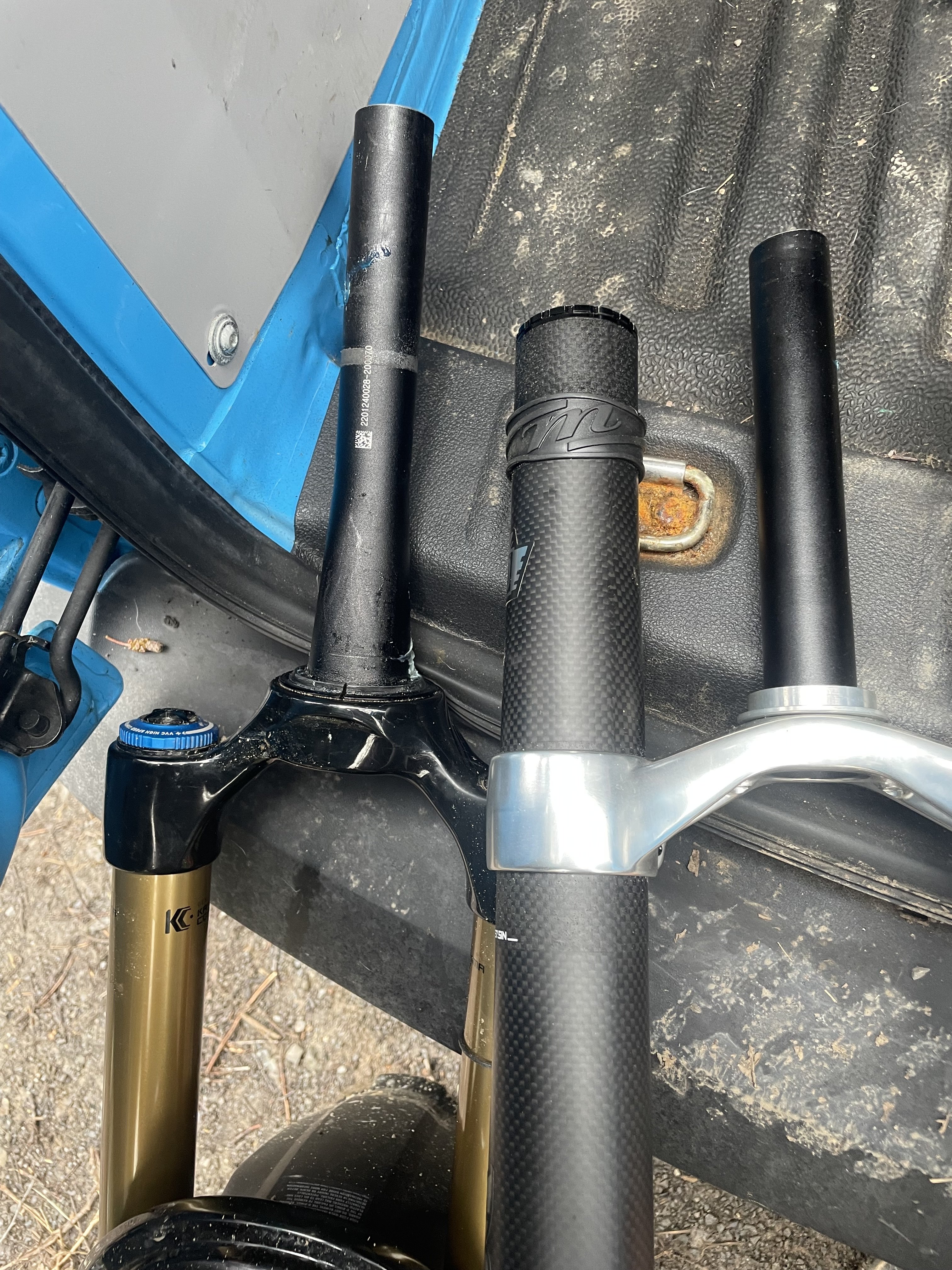

Rode my bike for first time in 2 months 🫤
Bpw as usual…
Friday afternoon cut short by punctured rear tyre - tubeless sealer wasn’t up to the task🙄
Long walk down the hill🤬
Saturday rode afternoon, again @ Bpw, good times had😎
Saturday I started being brave with attempting some smaller drops on trails, now I’m getting back into practice after ~ 7 months avoiding rough trails thanks to breaking my heel….
Still hurts.
Today again rode all day, flattened battery stopped fun😢

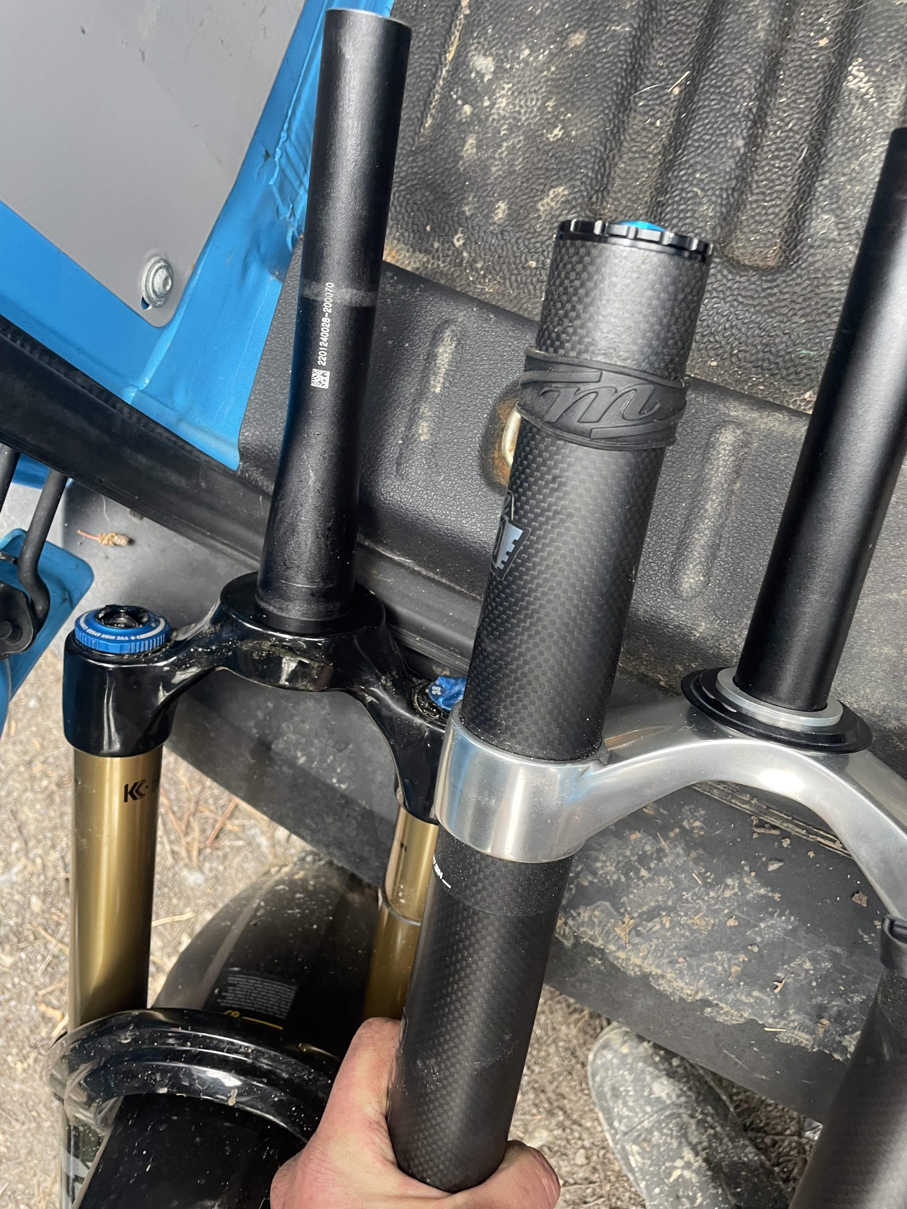

Also today I tried and failed to swap forks on the Norco, have fox38’s currently but they’re slurping and I’m not a fan historically 🤷‍♂️
Also I have manitou dorado twincrown / upside-down forks that I’ve dropped travel from 203mm to 180mm (as deemed safe by Norco) so decided it would be a dinner time task at the park!
Unfortunately I’d fitted a 1 1/8”-1.5” crownrace adaptor BUT the Norco….
Uses 1.5” top and 1.8” lower headset bearings so no dice🫤
Tried the crownrace from the Norco-fitted 38’s but wasn’t happy about stacking adapters so I’ll be making a solid alternative this week on one of my lathe’s 👍
Nothing is ever easy 🤬🤬🤬
I have the pump mounted under my bottle cage. I also have the 76 projects pump mount that would work for your top tube mounts.
I don’t have the LGE size bike like you do so I’m limited in mounting options (M-Rail). My PACs (2) would carry the OneUp pumps with tools and tire plugs.
In 4+ years I only needed a pump once (lucky I guess) so I eventually carried a Co2 cartridge and small tool kit for each pac. CushCore for the rear wheel.
If I was traveling further from home, or longer distances, then I would carry a proper pump and tool kit.
I can, and have, limped home on a flat, with CushCore, a few times. A Co2 kit is much easier, and slightly lighter, and cheaper. But I wouldn’t depend on that for a longer ride.
Yeah on the Orbea it works as the bottle cage is very low. Don’t understand why they put it so high on the slash+.
I just cannot have a bag in the saddle, I need the clearance, especially as I am using the anomaly SwitchGrade that allow me to completely change the incline of the saddle - great for climb to DH.
So far I have found the Crankbrothers - S.O.S. TT17 but it looks burly and not sure my leg would not catch it during the ride in some position.
I am using all the time a backpack, especially as I ride alone (medikit, now edc pump etc). I was very sad to not being able to use edc inside the fork as it would habe ease the weight on my shoulder!
Uswe backpack are awesome but once it reach a certain weight, well it feel it.

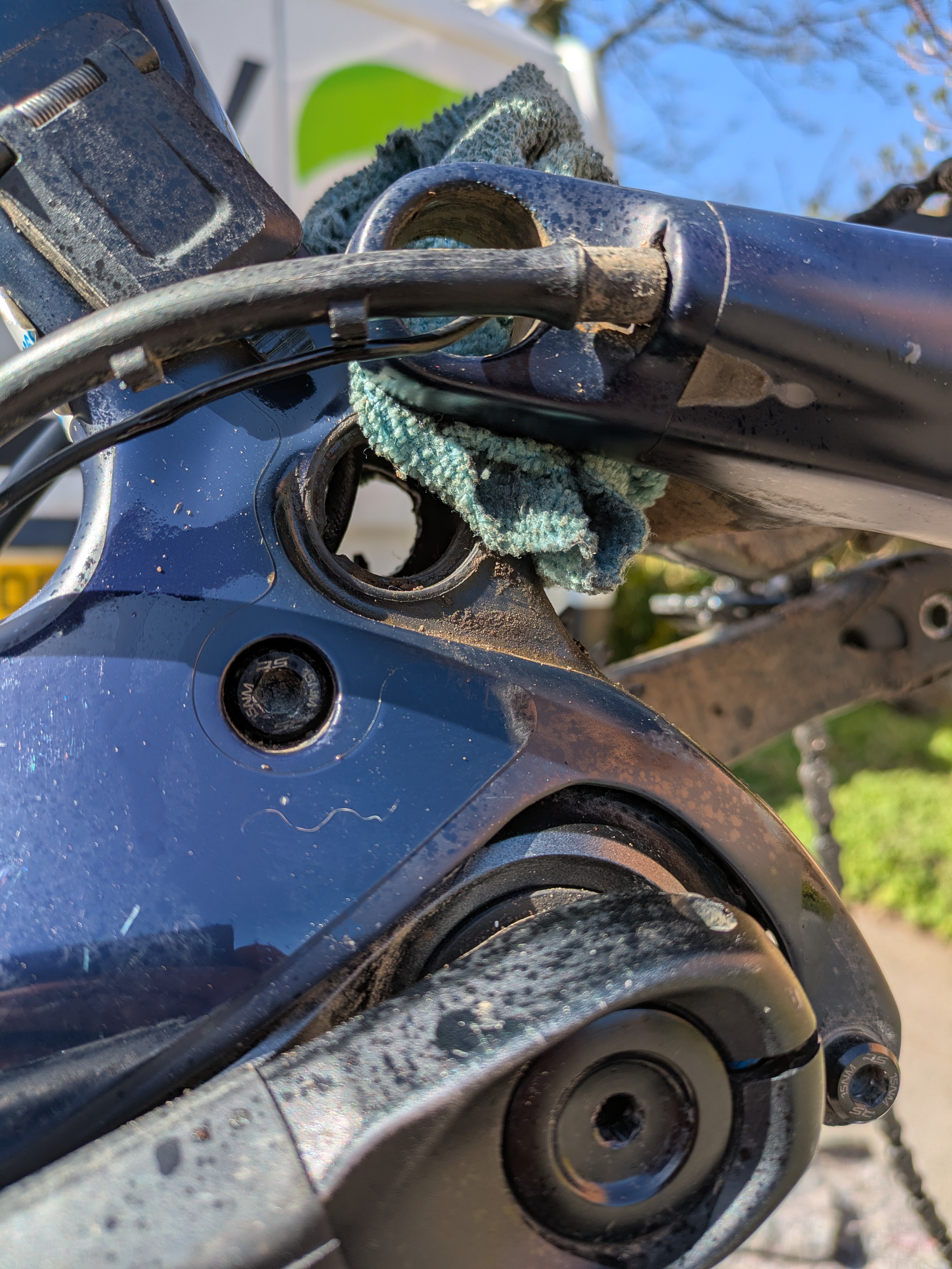

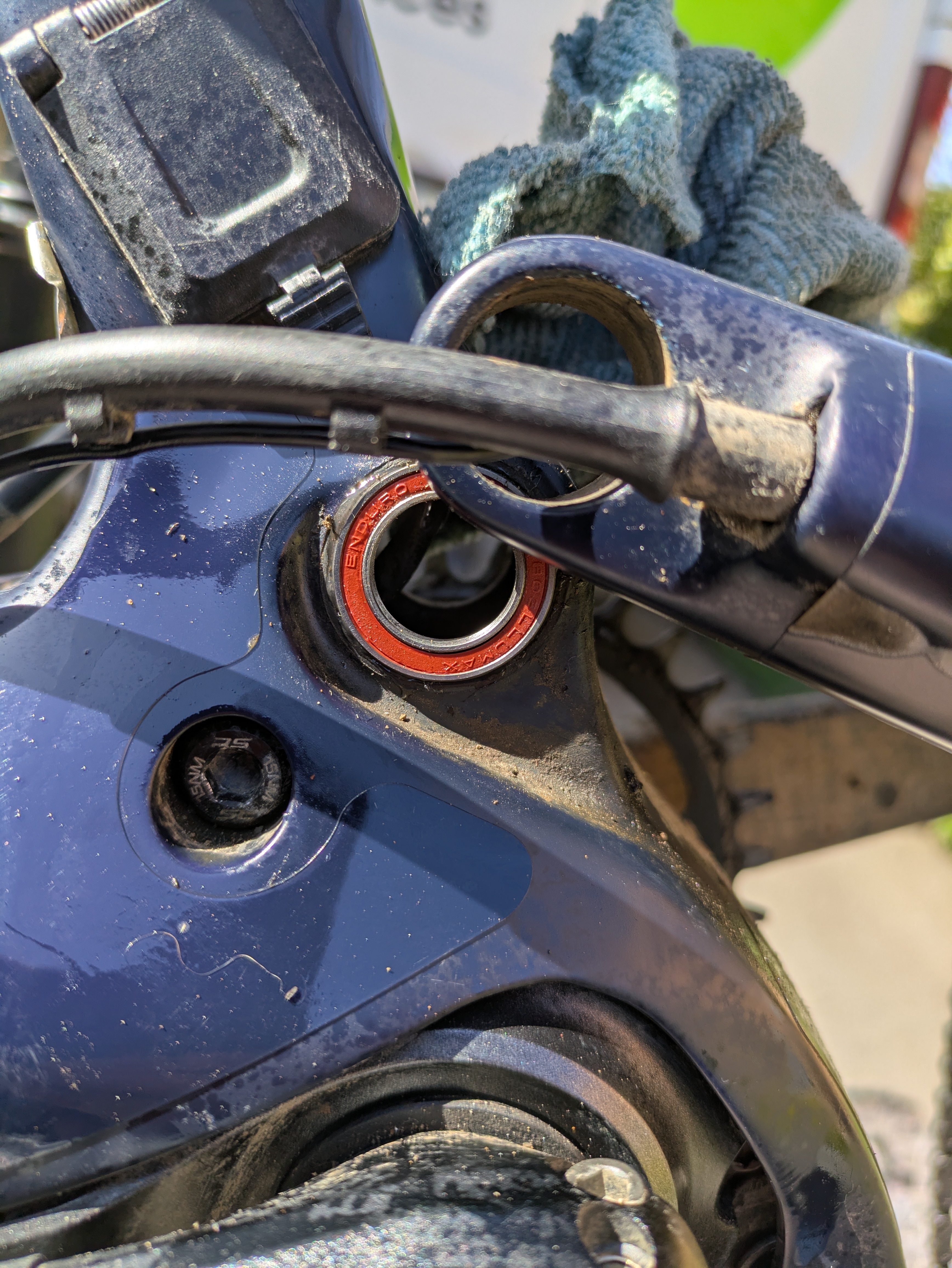

hey, is there some sort of video out there for #3?
Stihldog
Handheld Power Tool
Jun 10, 2020
4,097
5,800
Coquitlam, BC
This may have been the video to trigger me into making this a routine maintenance for my Bosch motor. At least once a year for the bearing seal and grease and every 4-6 months for the grease for just the grease.
Also, if you like Morgan Freeman or David Attennborough you’ll find the commentary in this video very soothing. 😉

Ako vymeníte mazivo v krytých ložiskách?
The bearing seal kit, with grease, is not for a sealed bearing. It’s an additional seal, or covering, for the main crankshaft bearing (2).
The kit protects the sealed crankshaft bearings from possible water ingress.
