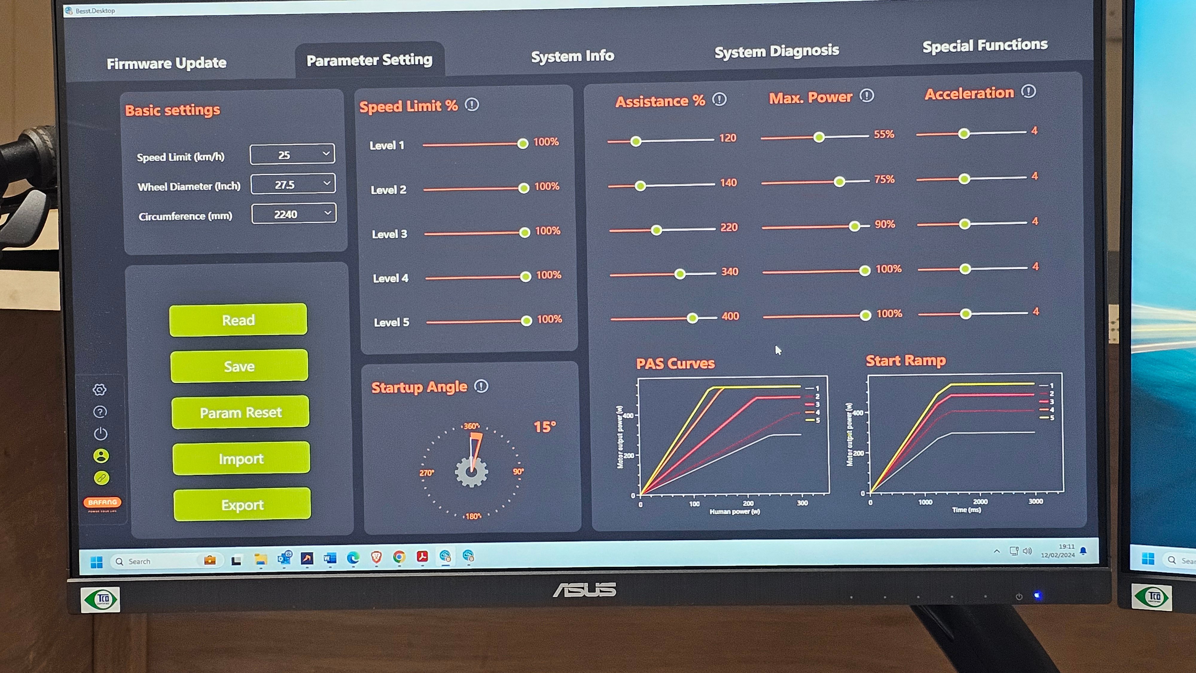

Great video Neeko. Made it look easy. If I get a beest tool, how easy is it to get a log in?
Apologies for the delay Jimmy.
I have been told by others that it is getting increasingly more difficult to set up an account with Bafang to use the BESST Tool.
I set mine up near 2 years ago, in anticipation of building up the Dengfu E10. But it wasn't straight forward.
Whilst I'm a bit guarded about my own account details. I have seen some who have passed on account details to besst tool owners.
Alternatively, some distributors of the BESST Tool have provided their own account details to allow the buyer access to the software.
GBK (Green Bike Kits) did at one point. But I'm not sure if they still do.
It's worth asking. So I'll update the thread, if they say yay or nay👍🏿

That would be good. Ordered a tool off ebay tonight. I'm interested in increasing the power of the R mode to 500.

Hello Jimmy. That 500 you mean support level parameter, right? It is sensitivity to pedalling. If you set to 500% it will be more like on/off. As even with low input to pedals you will be getting max set power from motor. Some people like it this way, some not.
With K1 Flash you do not have any issues with passwords.

Yes, Assistance percentage, they have renamed in latest Besst. I have to start naming it assistance. Default Bafang setting is 340%, Vitus put it on 400%. With this settings you wont get more power though.

Can't wait to see the video comparing the BESST pro and Go+. If Go+ will do everything the BESST tool will do it'll save the login headache.
In Go+ is still missing Assistance level - and this is what is the best about M510. You can set it as Bosch. Many people were complaining motor has high power and you do not need even to push into pedals.

Hey, I mean the assistant percentage. From your video R seems to be at 400 and can be increased to 500.
Yes. I am now running the E-Mythique level 5 (Race Mode) at 500% with acceleration set to 6. Naturally, the over-run feature has increased. But This Is only for the highest level of assist👍🏿

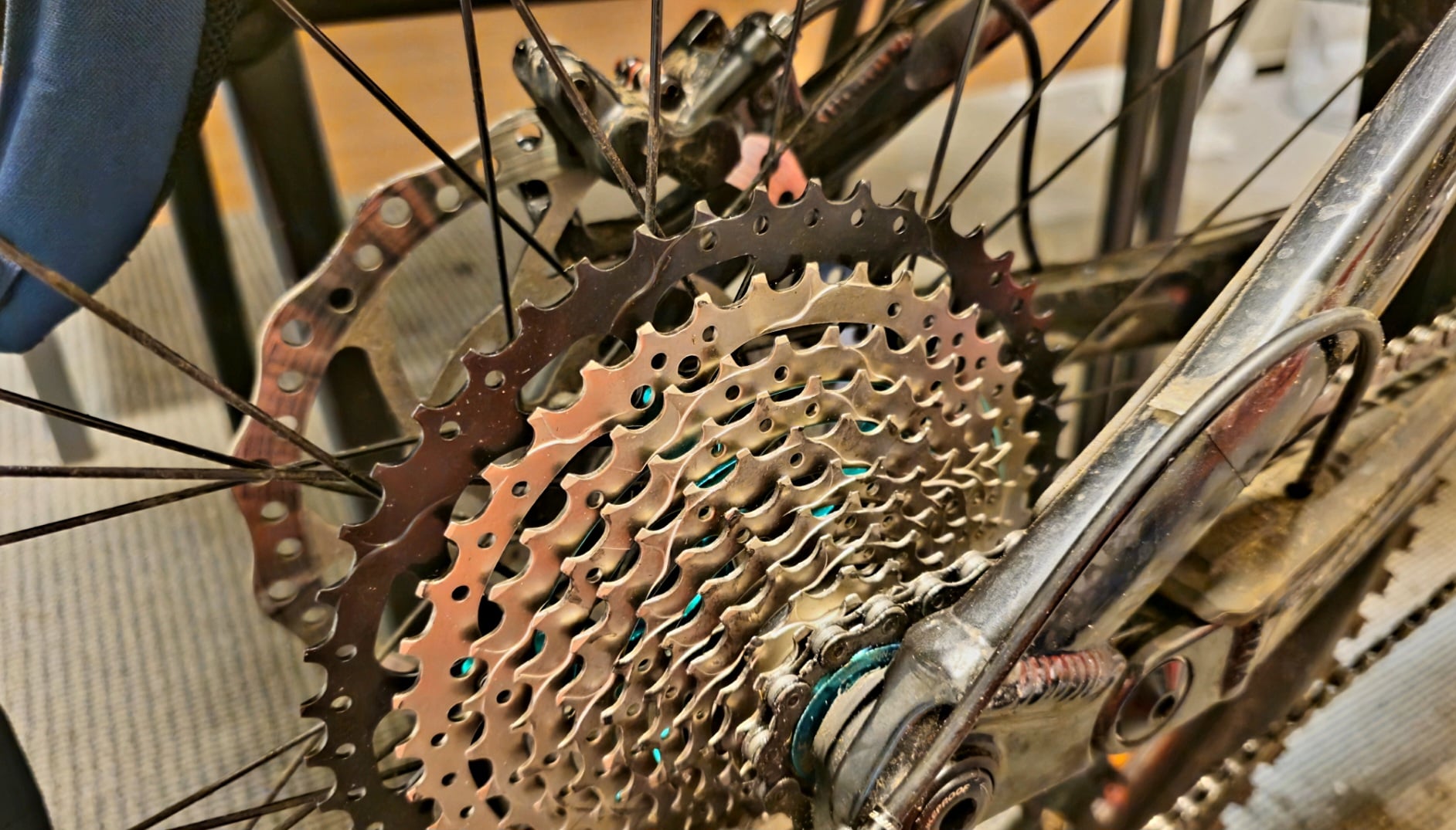

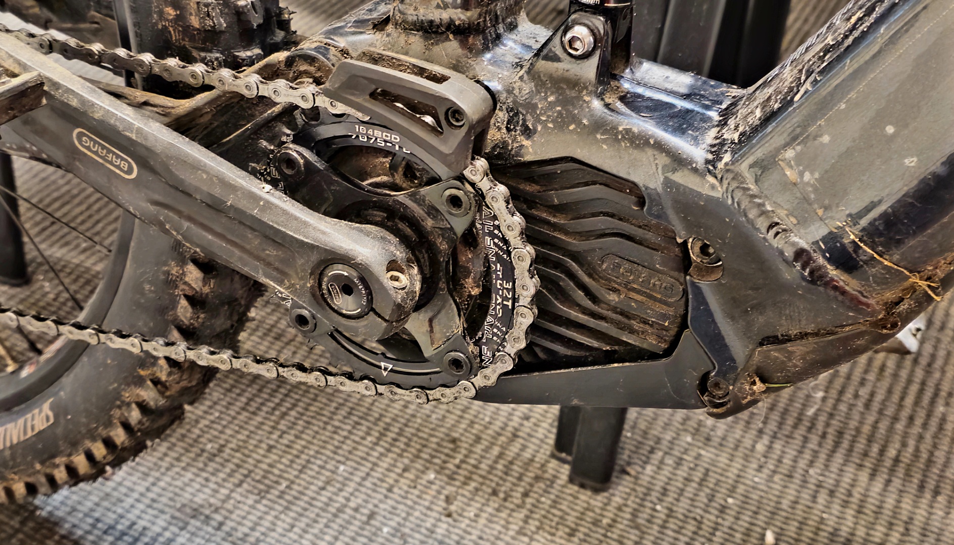

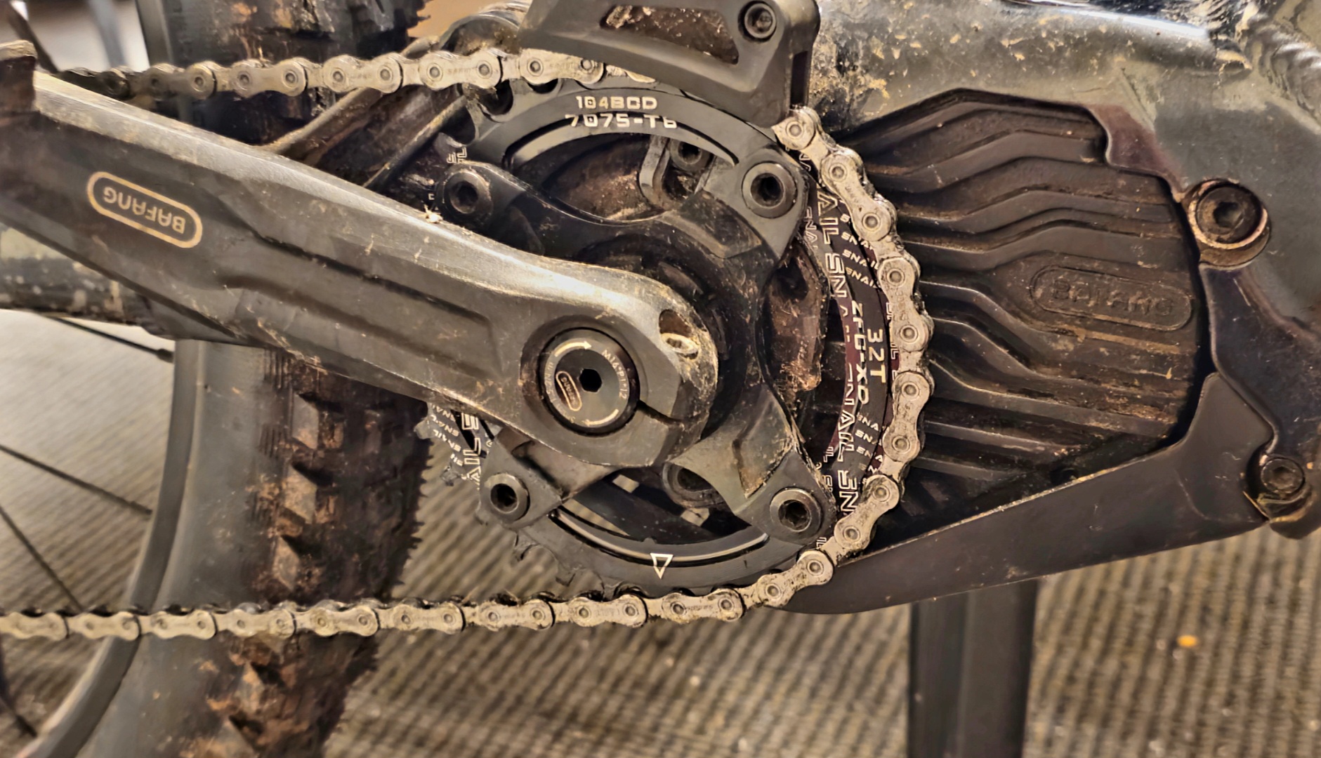

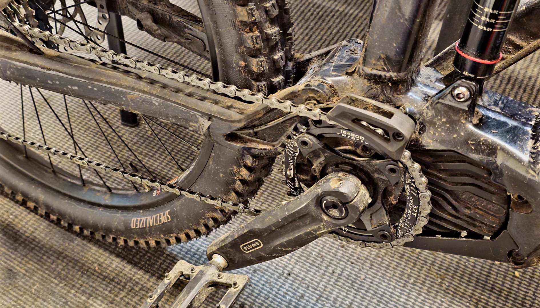

A 32t chainring works better on the E-Mythique LT compared to the 34t.
I'll obviously use a better chainring, as this one cost me £7 (alloy chainring NOT STEEL). But the mechanical advantage (in conjunction with the parameter amendments of the M510 motor), have definitely improved the bike's performance. Both responsiveness, low end grunt and workable cadence to achieve motor power.

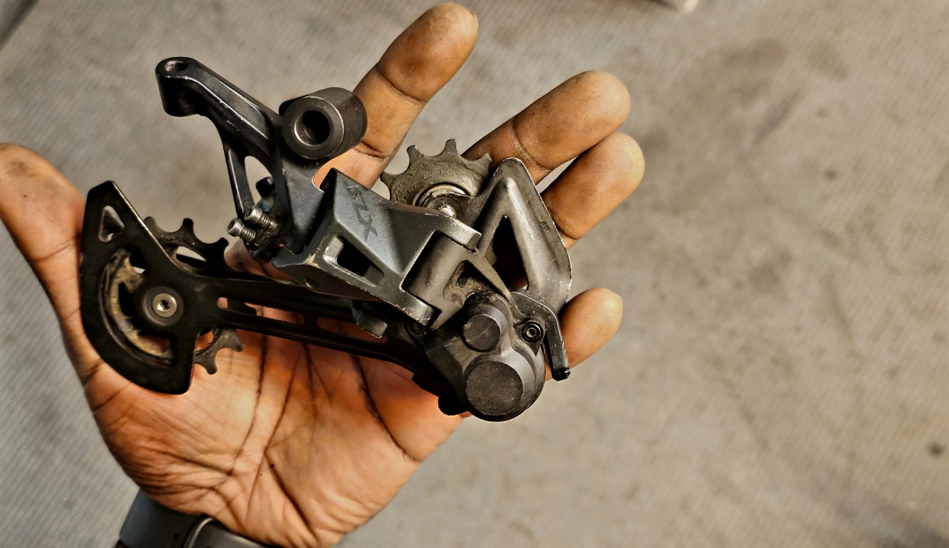

Obviously, swapping the drivetrain has helped aswell (couldn't get along with the Microshift stuff).
Nothing to fancy. But a work horse of a derailleur for ebikes.
Anywho, I'll happily share my findings and experiences with you all so ride safe everyone.
FYI,
118 links for the chain✌🏿
14,314
21,444
How so ?
The motor already cuts out at a cadence of 120.
It already responds poorly at higher cadences compared to other motors, dropping its power delivery rather than increasing it.
The motor works best in the midrange. Dropping the chainring size means you're at a higher cadence more frequently and you're also using all the smaller gears in the cassette more frequently which will lead to considerably faster cassette wear.
Might be ok on a Levo SL or a M820 bike.

Sorry Nicho, but this just sounds like your usual BS where you spout out useless information and never back anything up with any facts - it's tiresome.
...As always Zimms, it's a pleasure to bump paths with you the forum....again!!
It's up to you if you want to believe that I'm bullsh**ing you. I won't waste your time (or mine), convincing you otherwise.
Because 'clearly', you have access TO THIS!!!
So perhaps I'll take my leave from this thread, thus preventing a further........exchanging of option.
FYI, it's "Neeko"😒

It's difficult to say at this point @skismith . Usually, I prefer to have concrete data to verify any facts if I'm comparing.
The only Bosch Gen4 emtb which I have (which is rideable as I'm awaiting for parts on a side project build) is my Whyte E150 which has been set up as a mullet E160.
Myself and my two cousins did do a weekend ride recently and with my E-Mythique, Megawatt and E160 which we swapped between all three. From what they claimed, it was more circumstances on the trail which they noticed strengths and weaknesses between the M510, EP801 and Bosch Gen4. But discrepancies existed between the three bikes and I had no way of measuring either motor and the performance.
E.g. all three bikes use 36v 630wh batteries. The Bosch Gen4 battery seemed to have the least amount of percentage left after our ride. But the bike was predominantly used in EMTB Mode. Whereas the EP801 was used in Trail and the M510 ranged between level 2, 3 & 4. Notwithstanding, the tyres, gearing, wheelset, hub engagement, weight of each bike, geometry etc, all varied.
If I were to simply go off feeling and base my opinion on which motor was the best using the Megawatt, E-Mythique and E160 for consistent predictable power, I would say the EP801. For raw power, perhaps the Bosch Gen4. But I couldn't say that the M510 powered by a 36v battery was that lacking, that it wasn't able to keep up. Especially, when you're in the right gear and cadence.
But again, too many discrepancies between the bikes. So at this stage, I can't provide concrete or factual evidence to validate that the M510 (powered by a 36v battery) can contend with the Bosch Gen4, Brose, Yamaha, Shimano etc.
What I can say is that changing the parameters of the M510 motor on the E-Mythique and going to a 32t chainring, has improved the bike's performance. Considering, my XL bike weights a bit over 26kg. Giving the bike a mechanical advantage and raising the acceleration and assistance for all levels of assist and reducing the startup angle, has allowed the bike to engage quicker from standstill and maintain speed and watts without any sudden spikes or dips in terms of power, speed and battery consumption.
Essentially, I've made the bike more efficient👍🏿

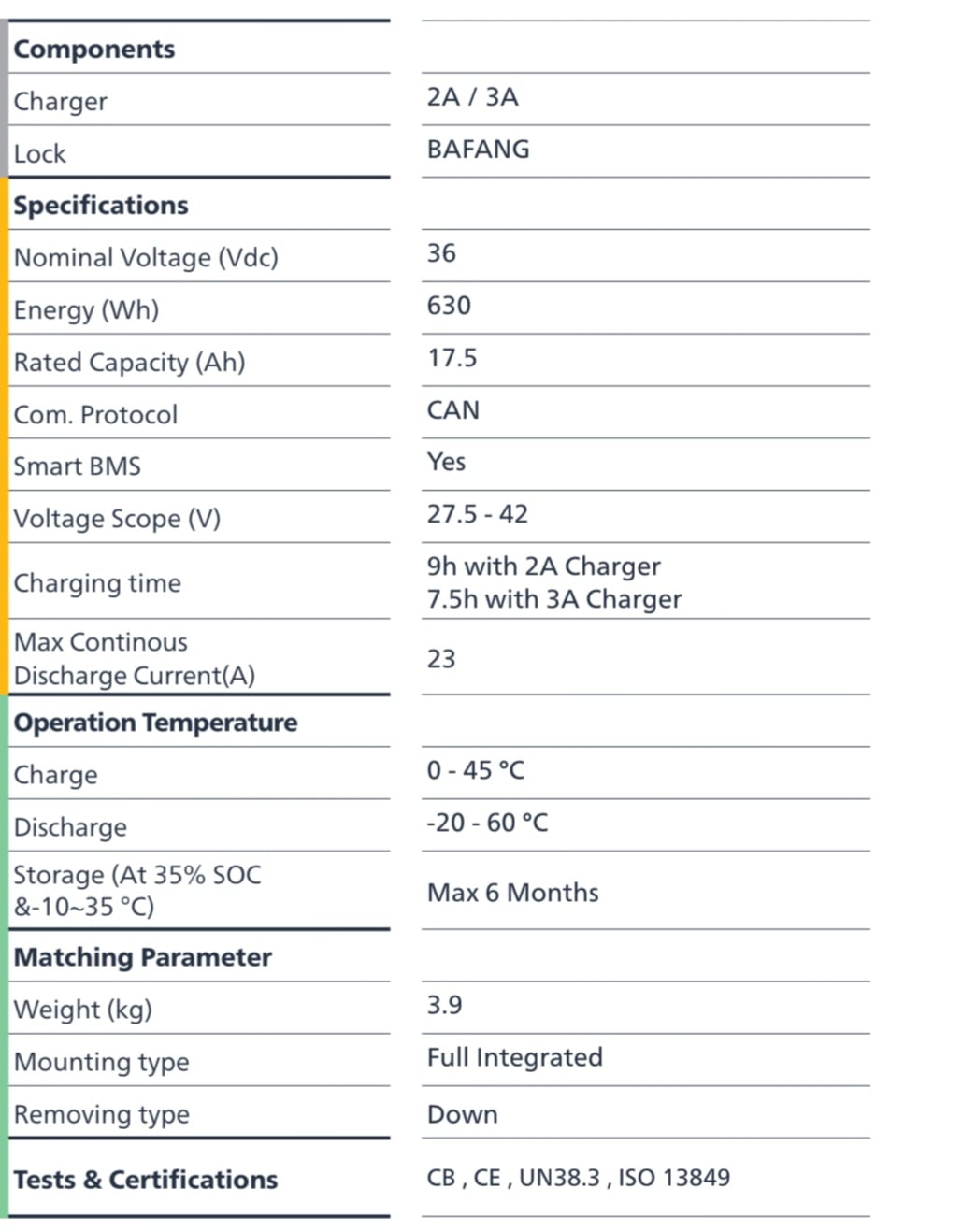

Some good info there, I’d be interested to know if the 36v version m510 has the same performance as the 48v . The current required for the 36v must be significantly higher as battery voltage drops due to range. This must impare the the 36v motor more .
Neeko DeVinchi
Dec 31, 2020
1,043
1,387
More than likely @skismith . Increasing voltage usually increases efficiency in terms of flow of energy from battery to motor.
Although on a personal note, I am curious whether the BTF16 630wh battery can still discharge at -20°😅
