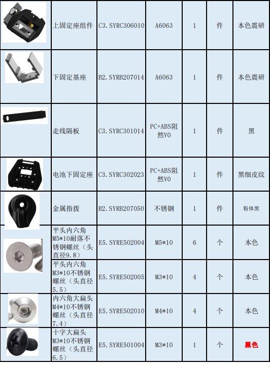

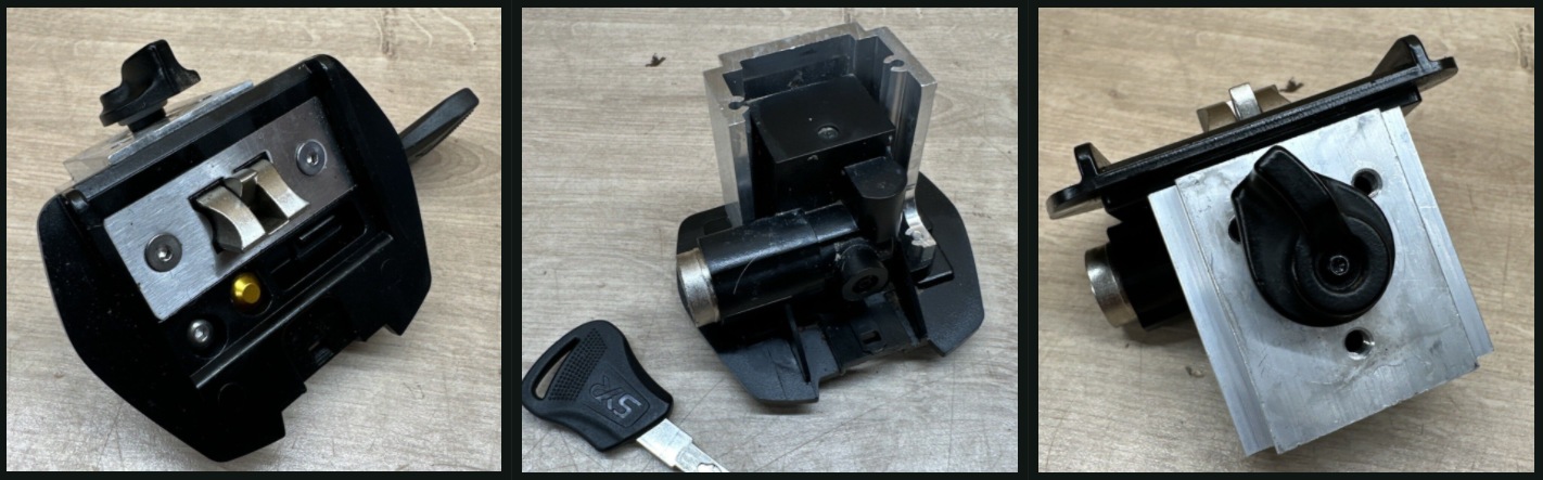

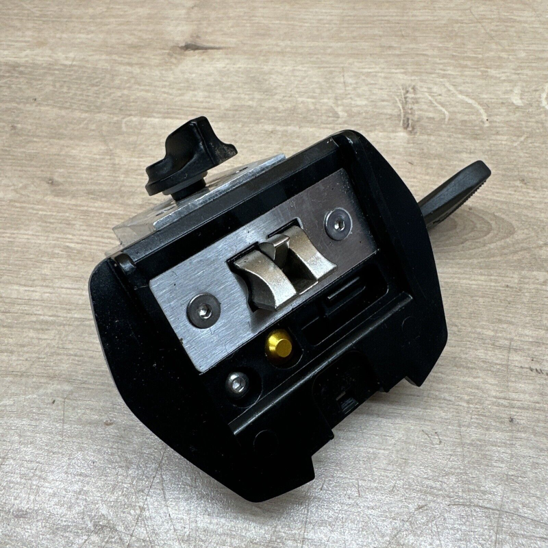

Speaking of battery, what would be the best way to go about getting another set of keys for the battery release? I accidentally left the battery keys on the bumper of the car and drove off. 😡
I would love to convert it to a simple tool release, but there doesn't seem to be an easy way to do that. For now I just can't remove my battery until I can find another key.
As an update to this, I contacted a Bafang supplier on Aliexpress and ordered a new upper battery mount. All I did was tell her the battery model and she was able to find the correct one. She sent a pic to confirm. It took a while but I received it and everything was good. It uses a completely different key blank than the other two lock I have. I guess there's no "standard" in that department.
I drilled the old lock out and swapped the new upper mount in. Went as expected except this time I locktited the crap out if the crew that holds the little knob on!
I really was wanting to convert to a "keyless" battery removal so if needed I could remove the battery on the trail. I couldn't find an easy way to do this. I was worried about removing the pins in the lock because there would be no detent keeping the cylinder from turning. After installing the new battery mount I realized it was pretty stiff turning the lock until the locking pin disengages the battery. So I removed the upper mount and pulled all the pins out. I reinstalled the mount and have about 30 miles on it with no problems. I've done several 3-5ft drops with no problem. The key slot hasn't turned a bit on it's own. After I get around 100 trouble free miles on the mod I'll convert the wife's bike and document the procedure.

I went through Anna Chen at Changzhou Fieldebikes. Great to deal with. The upper battery mount was 12 dollars but I ordered a DPC245 V3 and a wheel speed sensor kit along with the battery mount as spares. All parts were $92 US. They air shipped it and shipping was 24 dollars. Adding the Alibaba fee and tax it was 130 shipped to my door. It took them 5 days to ship the order and about a week and a half for it to get to me.
Thanks. Sounds like good package. I am also looking into a spare display right now but remember reading some issues with the v3 version. Did it overwrite the original settings? Have to look it up again.
With regards to the keys, my local shop was able to provide me a copy for 5€ each
