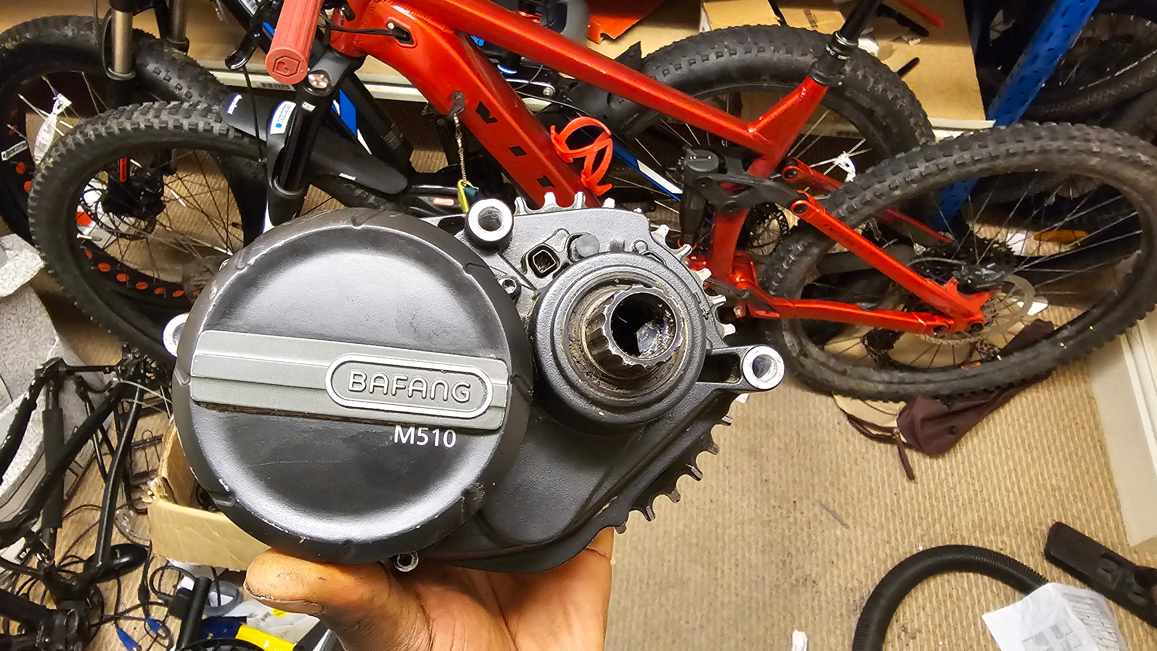

I'm currently fixing the 13th E-Mythique for an owner who's travelled far to get this bike working.
Withn 30sec of using the Besst Tool, it explained that the motor's controller had failed.
Unfortunately, this person had already purchased a new display and battery totalling £400 (which is around the same price as a new motor).
The look on the owner's face when I showed him that the motor was the problem, he looked like his heart had just sank.
Thankfully, a new controller and new motor are on the way. So (as always), I'll get this chap back out on the trails...one way or another.
To add context to this particular bike, this is what the owner told me,
"He had ridden the bike up Lake District. It was a muddy day. He had washed the bike. And after wiping it down/drying it, inserted the battery. He heard a spark once the battery was fully seated into the frame. He immediately thought "that didn't sound good". He attempted to turn the bike. Nothing happened. He unplugged and replugged the display. The bike didn't turn on. He removed the battery and checked if the battery was on. The battery showed a green light indicating that it had charge. He repeated the steps of plugging connectors and battery. The bike still wouldn't turn on. He then opted to buy a new display a week later. The bike still wouldn't turn on. He then saw the batteries being advertised on Ebay and bought another one. THE BIKE STILL WOULDN'T TURN ON!!!"
By now, I'm sure the above story for E-Mythique owners may sound familiar. I won't lie, the story continues as the owner even contacted Bafang directly. Spoiler alert, they didn't help him. Despite having a genuine receipt confirming that he is the original owner and the bike isn't 2 years old.
So for any of you who spot these ebikes on the second hand market, be warned. For you will have to treat this bike no different than a diy ebike. And know how Bafang works. Otherwise, be prepared to spend more than what the bike cost initially.
Rant over!
Neeko DeVinchi
Dec 31, 2020
1,042
1,387
No.
The spark sound the owner heard when connecting the battery was what shorted out the motor.
If it was water ingress, the motor internally would show signs. Mechanically, it's fine. But the controller ignition board is fried.

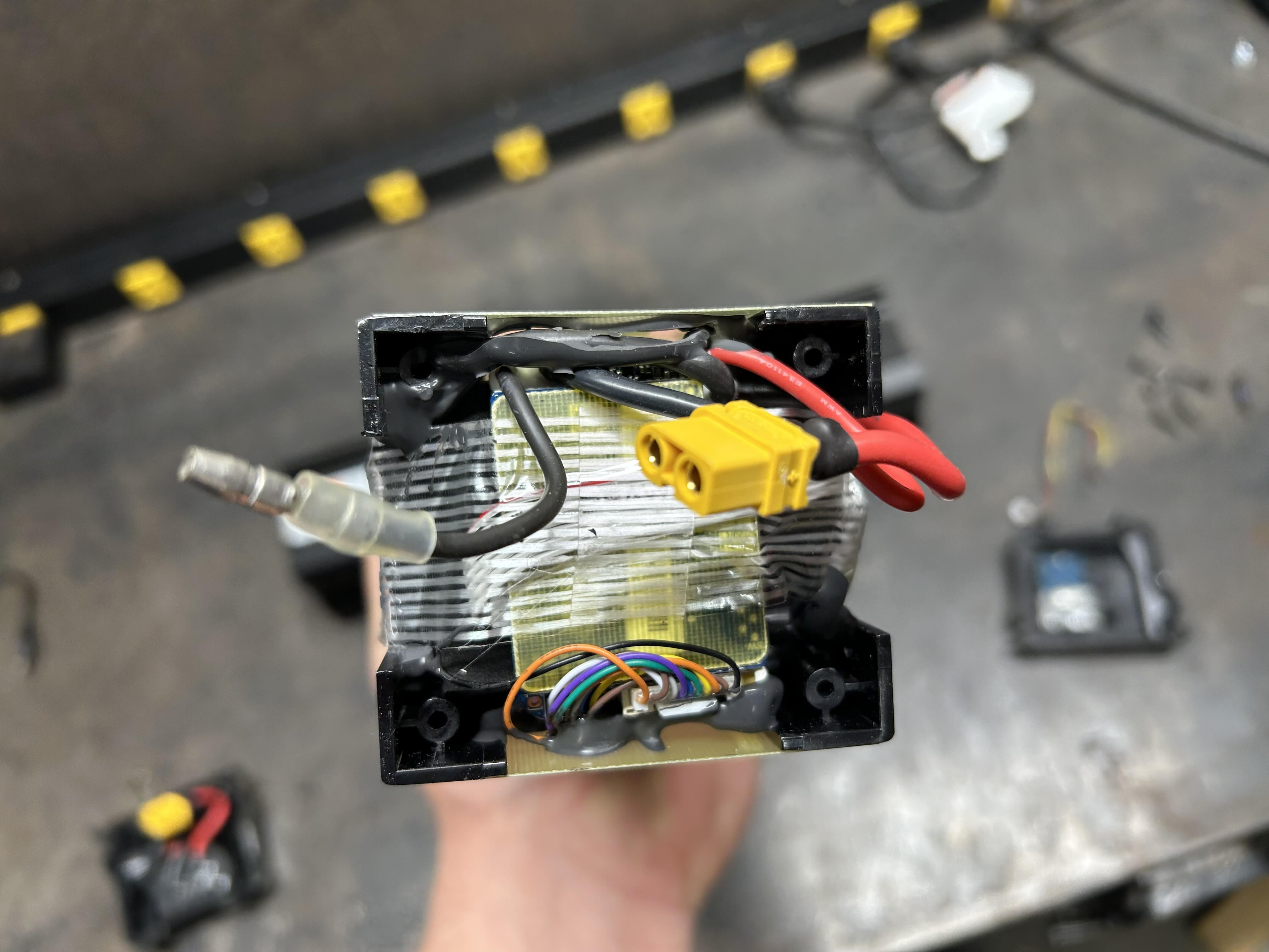

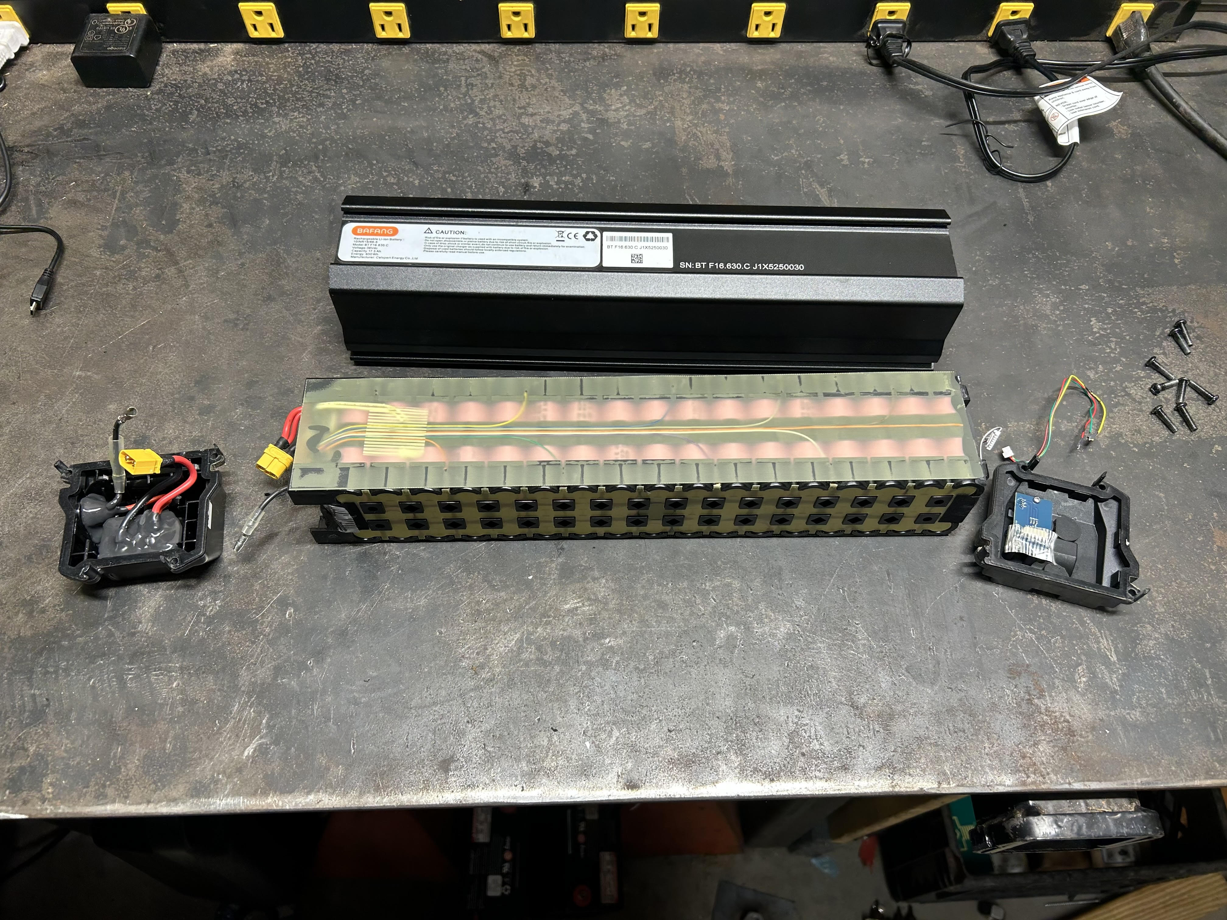

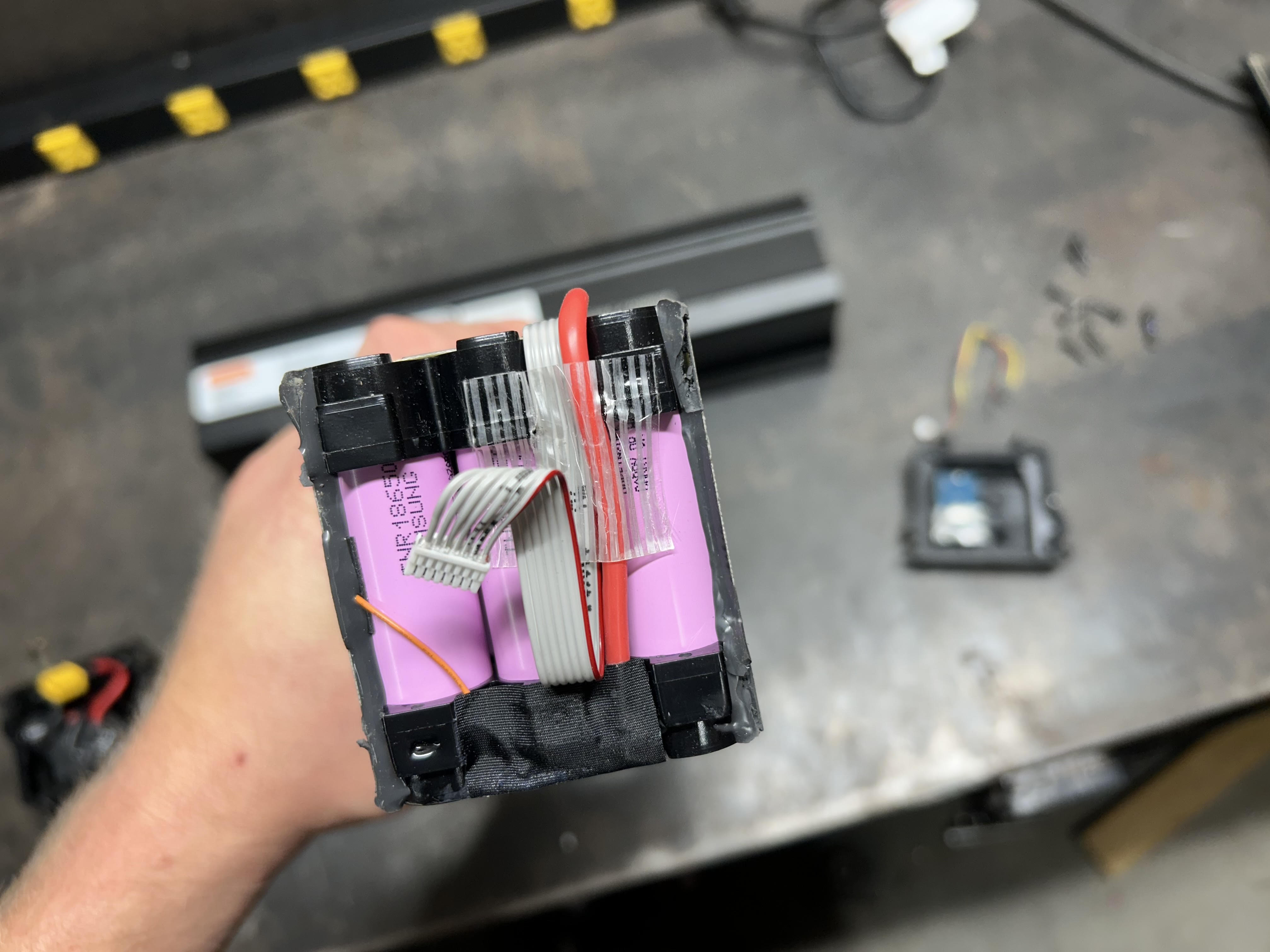

I finally got around to taking my bad battery apart and checking it out. There's not really much you can do to the batteries, they are largely epoxied into the case. I saw nothing obvious wrong with it so I tried something on a whim. I unplugged the ribbon cable to the button on the top of the battery. I rode 2 miles around the neighborhood yesterday at 650-700 watts and all was well. I'm going to do a trail test today.
Dec 3, 2023
37
39
Europe

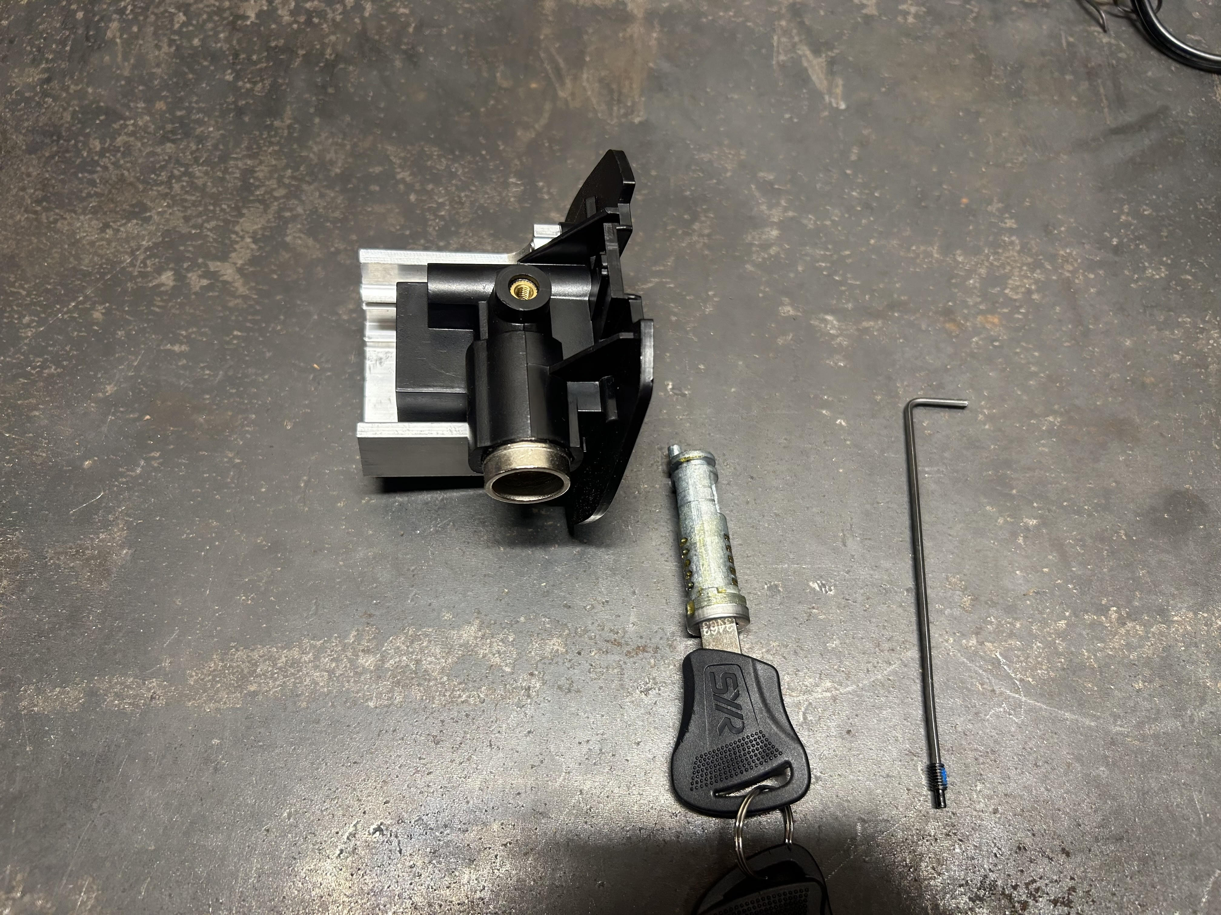

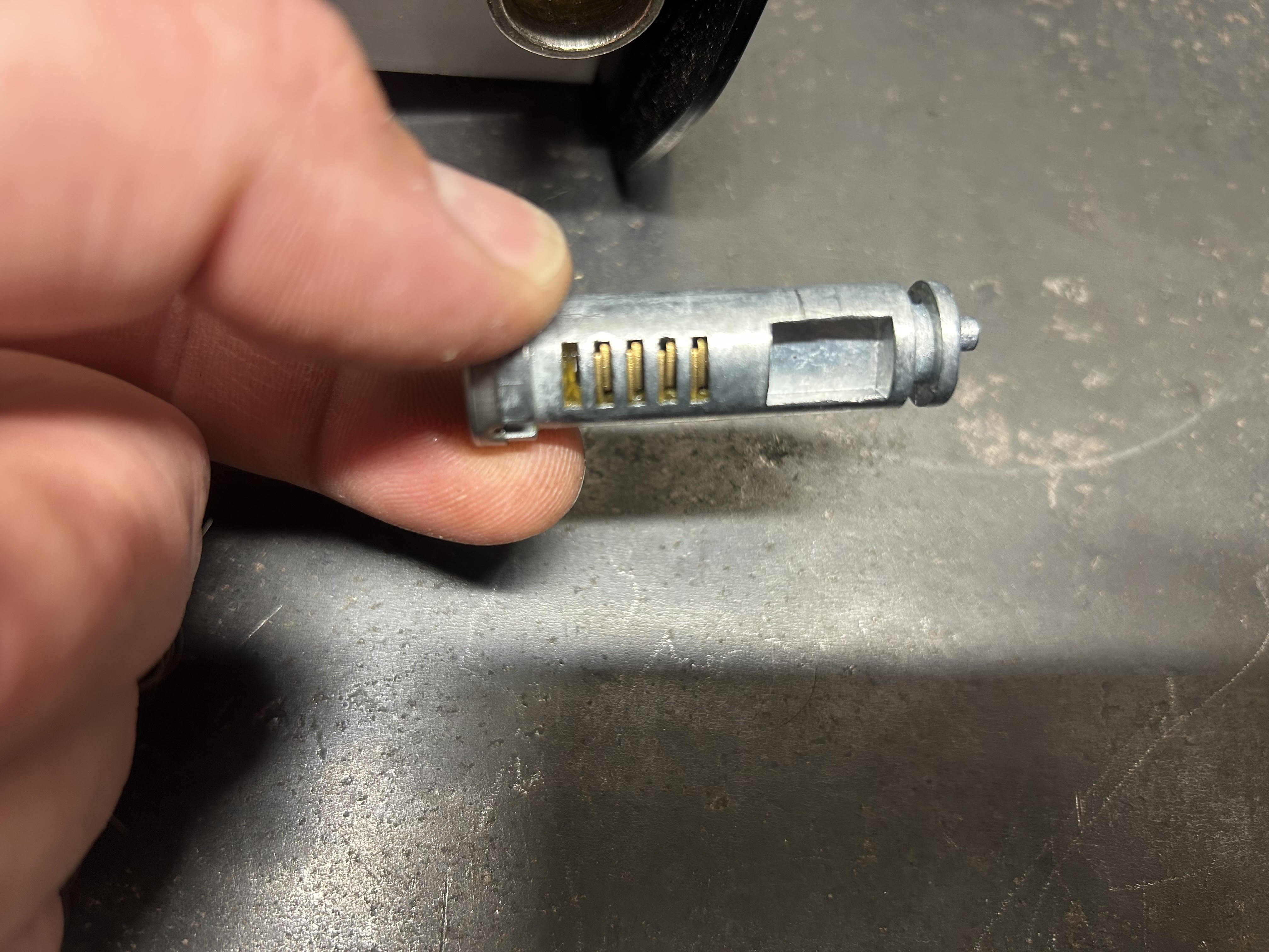

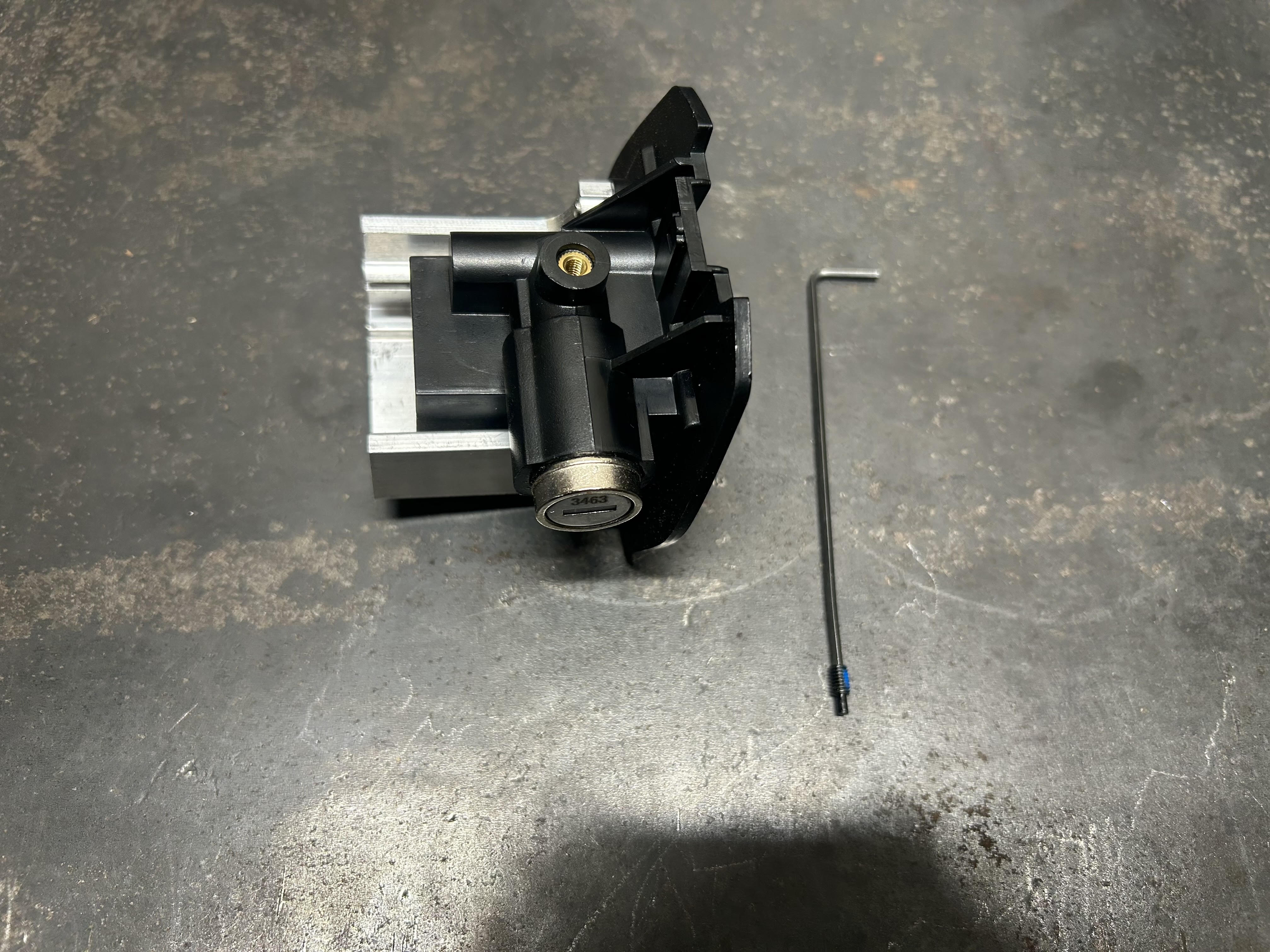

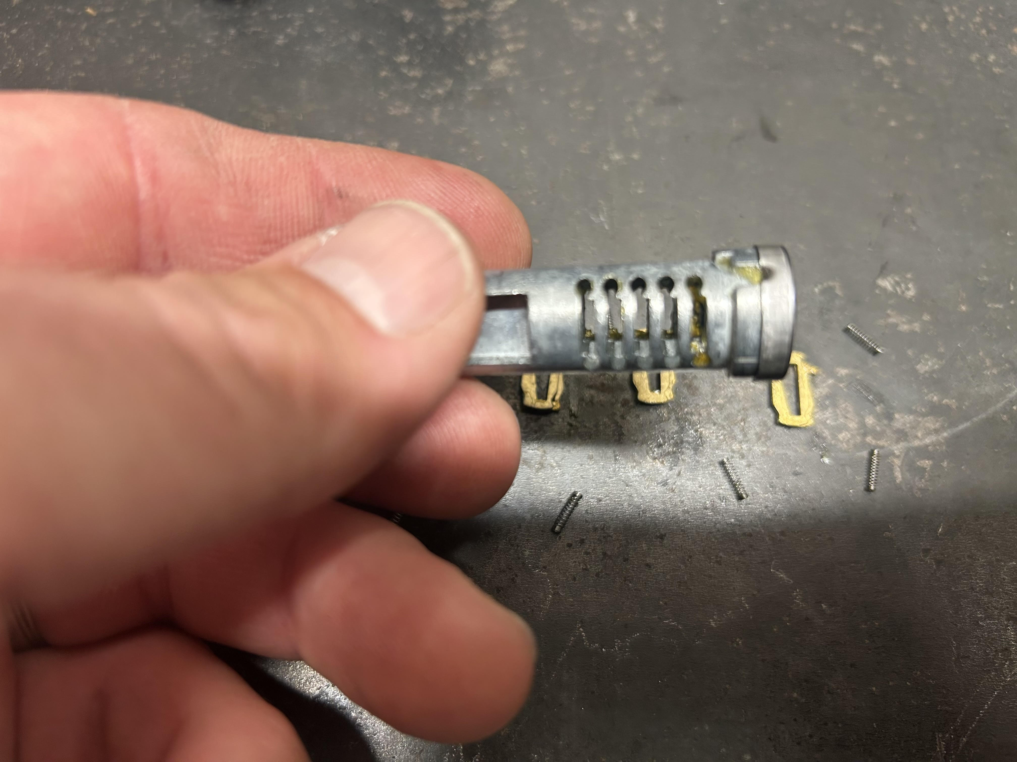

I just fixed my wife's battery mount so the key was no longer needed to remove the battery. I did this to mine several months ago and have not had any issues. I took some pic so show in case anyone else wanted to try it.
First remove the upper battery mount.
Next remove the cylinder retaining pin.
This allows you to insert the key and remove the cylinder
Now you can remove the key and get access to the wafer pins
CarolinaCrawler
Jan 30, 2023
278
286
North Carolina

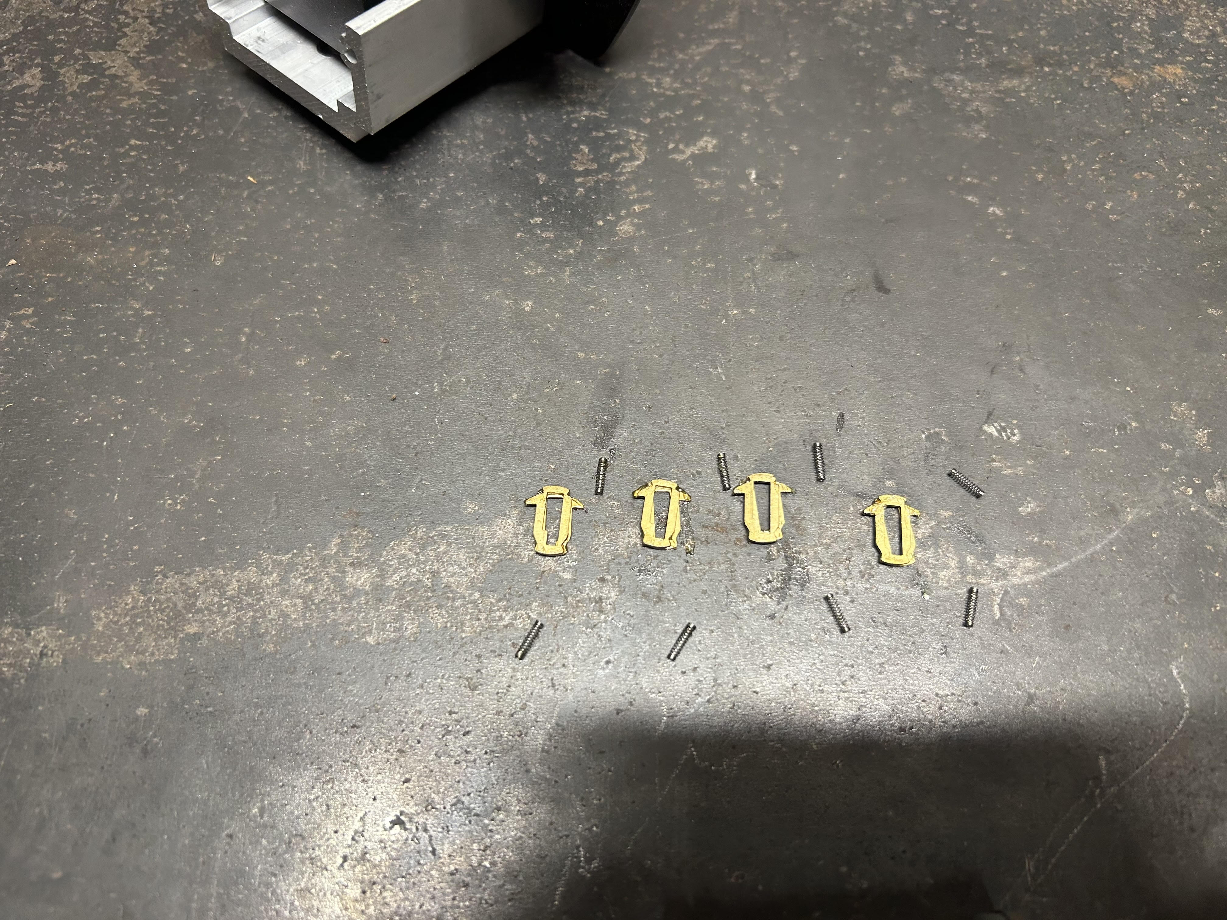

Now you can remove the wafers and springs

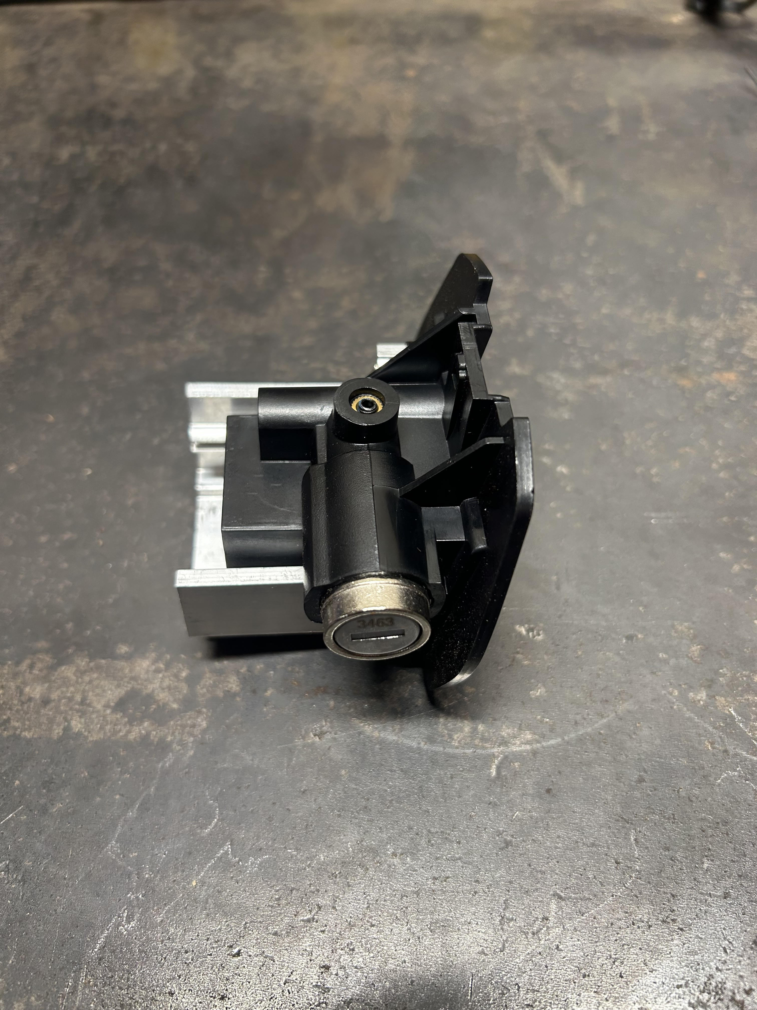

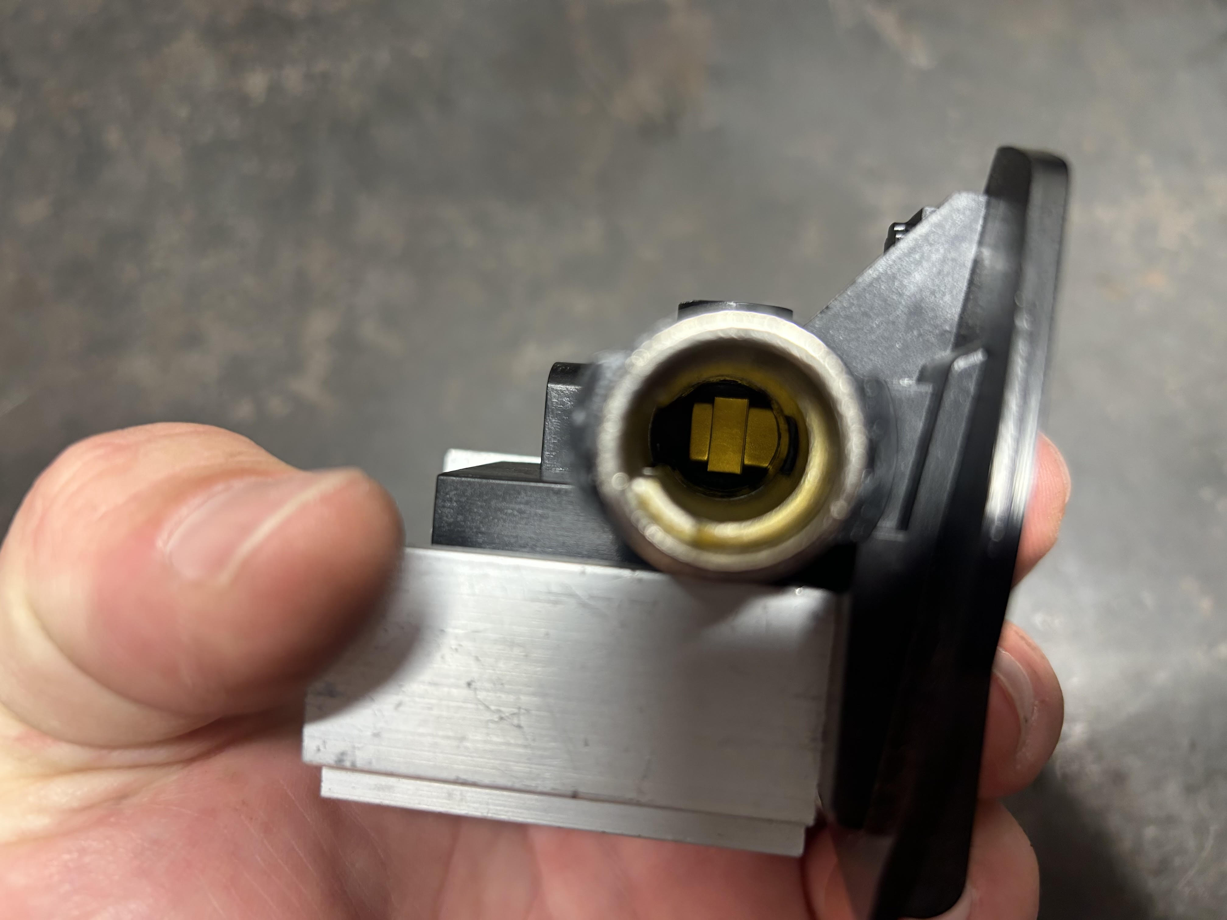

This leaves the cylinder empty
Now you can align the bolt and reassemble.
I was worried at first that without a detent it would unlock by itself. I had no problems of this sort and now it can be unlocked by any key or flat screwdriver. It has saved me more than once on the trail.

Do you know what went wrong? Cells, electronics or connections?
It had to be a connection somewhere. The battery got to the point where it would shut off when it was bolted locked. There's a "slam" latch that holds the battery in and then when you turn the key there's a bolt that engages and locks the battery in place. When I would turn the key the battery would shut off.
I took it apart a while ago and didn't see anything obvious wrong so I just ordered another battery.
