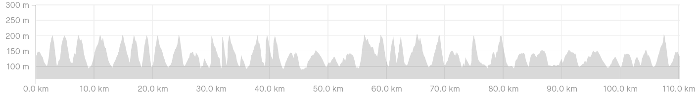

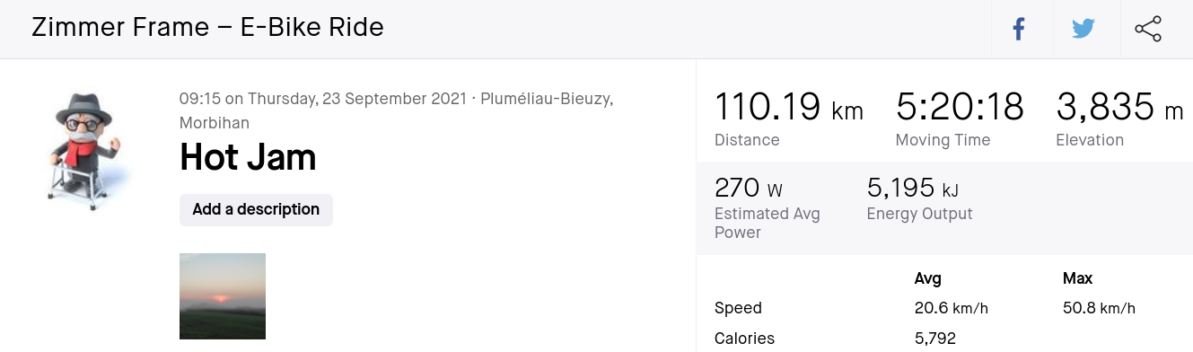

4: You can in theory tune the motor with Go+ (with an upgraded display) or some other tools if you buy a "box" - there's a thread on bafang tuning. In reality, you probably won't need to. There are many other factors like rider weight, speed, type of terrain and especially vertical meters climbed. You can also turn it to no assistance if you feel fit/strong/crazy. Assistance will also stop at 25kph, so another way to get more range is to push past that. In the middle assist mode you should easily get 1500+ meters climbing. In Eco 2000 to 2500m. With any e-bike if you power off or "ride the wave" at the cut off point you can get lots more, you just need to pace yourself and not go crazy and tire yourself out on the descents too. It's physically exhausting though. An example on a 630wh Bosch Bike :
lots of up and downs rather than a nice mountain :-(

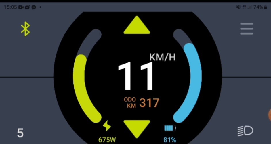

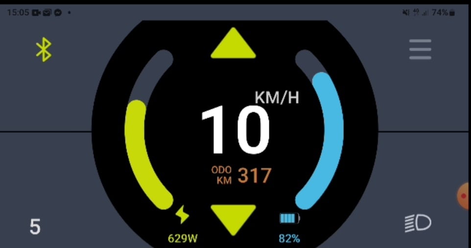

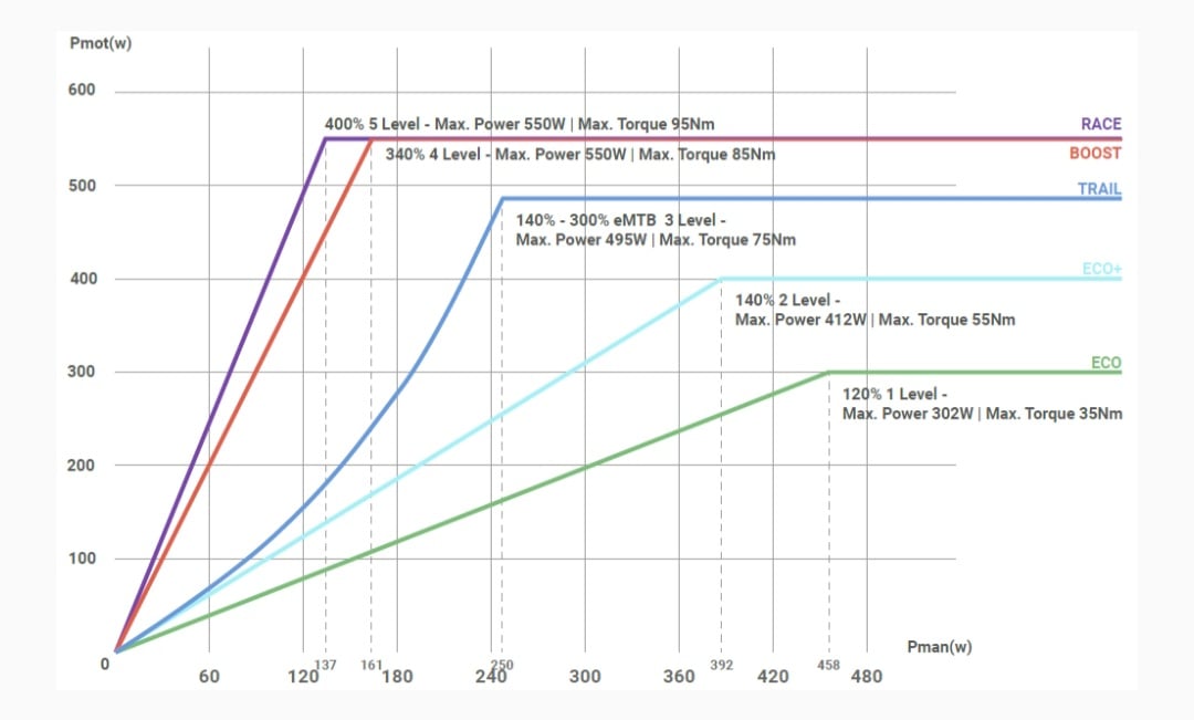

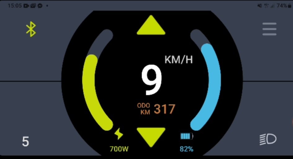

Vitus state that their custom firmware on the M510 only allows the motor to achieve a maximum power of 550w.
Ordinarily because it's using a 36v battery, I believed them. However,
the Bafang Go app showed the motor achieving 700w when in the highest level of assist.
With subsequent climbs achieving above 550w.
Don't get me wrong, I'm not complaining. But it's strange why Vitus declared 550w peak output.
Have any of you noticed this?

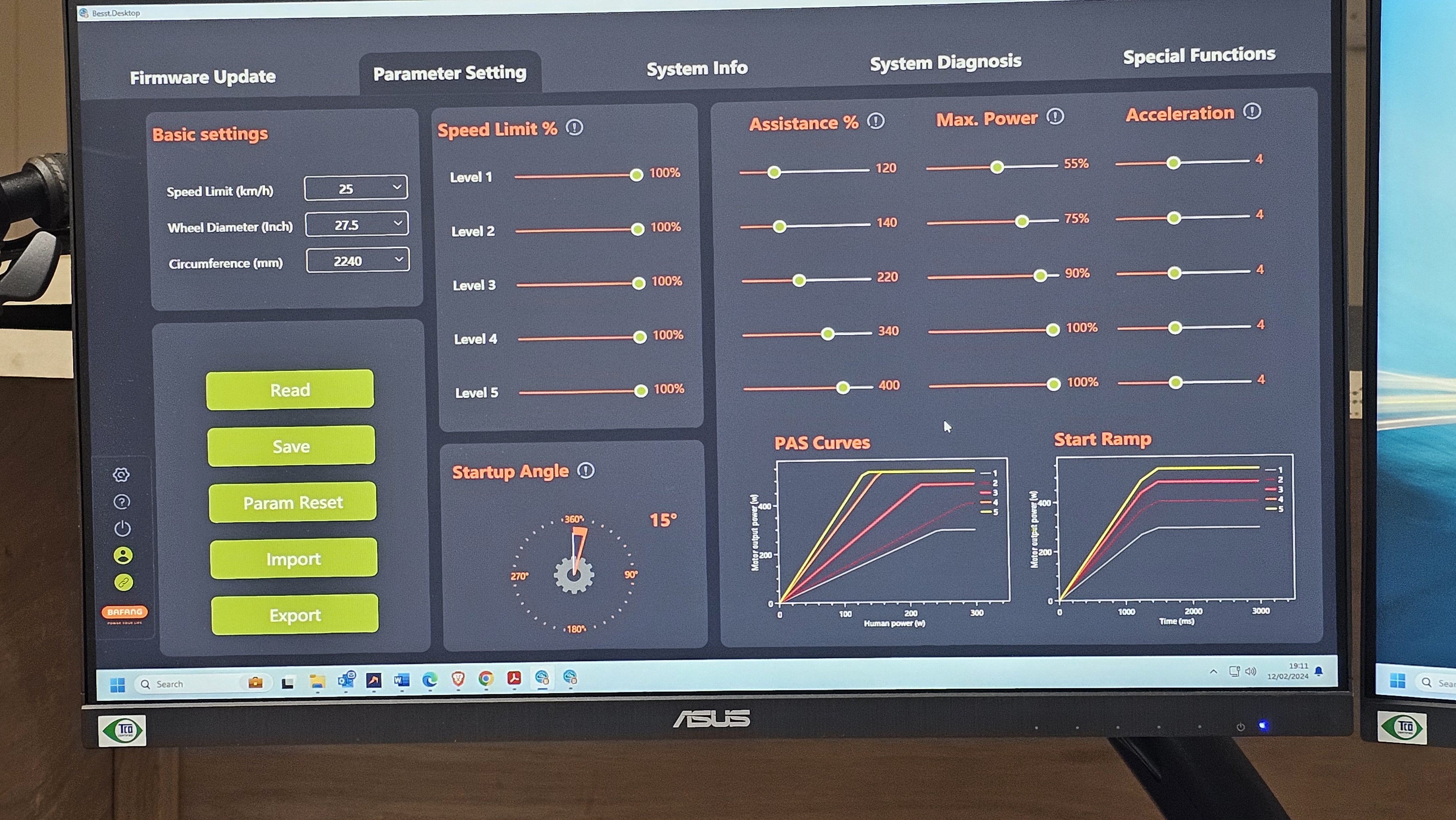

I would love to know why when the torque is increased to the pedal the output seems to decrease. Then if you ease off the pedals it seems to bring in the power. If your really torquing on the pedals (standing and climbing hard) and adjust from E to T there is no concernable difference in motor power output.
I'm slowly playing around with each setting. Moreso, the startup angle. I recall you mentioned before that thr motor responded too slow in eco, eco+ and trail. I have found that by reducing the angle to 10°, does improve pedal response from stand still. I wouldn't mind experimenting with the 32t chainring. But atleast we know that the startup angle is the main culprit behind the lagging motor response.
As for power, yes. It is possible to increase the power further by raising the assistance percentage, as the maximum power is governed by the assistance tab.
I'll share my findings as time goes on👍🏿

Hello Neeko.
I would say they mean mechanical power at the wheel. And it really match also according numbers. 48V and 14A is peaking 730W - electrical power. Effectivity of controller and motor is cca 0.8 , with Bafang less. ;) Also Bosch motors have less on the wheel.

I've refrained from comparing the E-Mythique Lt to the E10 (too many discrepancies). But I'm still tinkering with the E-Mythique Lt. So I'll share my findings.
Amending the startup angle to 8° has DRASTICALLY!! improved the bike's performance👍🏿

8° and 15° shouldn't be such a difference. And hard to spot.
Old controllers have only a "levels" 0 to 16. One level was something like 8.5 degree (cca). So now is a question if they have now better pass sensors which can detect to degree accuracy. ;)
Neeko DeVinchi
Dec 31, 2020
1,042
1,387
I'm pretty sure the torque sensors on the M510 models are the same, regardless of the generation.
Amending the startup angle from 15° to 8° is noticable, as the motor can engage quicker from standstill. Think of it like a rear hub with more points of engagement👍🏿
