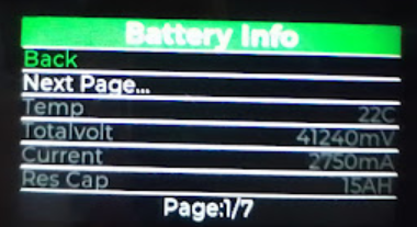

Edit 2 : 2 months in, Battery now shows 16,779 mAH.
(Note : Charge cycles displayed on the Bafang isn't 100% full charge cycles, but just how many times it's been connected to a charger)

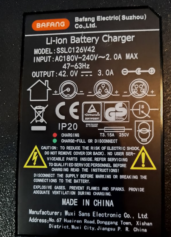

The bike is spec'ed with a 2A charger, but mine came with the 3A charger, so hopefully they all do as it's faster !

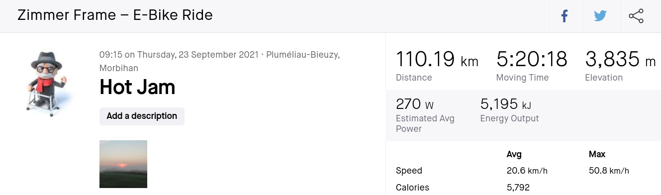

  4. is there any possibility of tuning the output of the motor? I can push 280W for 1h (average constant power on a constant climb, 10km at 10%), so I would tune the Eco mode in order to get just a little bit of help (i.e., I push 180/200W, the motor pushes 150W) so that I can reach the top of the climb with very limited effort (180/200W means I can breathe and speak normally). In that way, the 630 Wh battery would last for at least 4h of climbing (150W x 4h = 600 Wh).

3: The motor has a torque sensor built in, it measures the torque you put in then applies a relevant amount of assistance. Your understanding is more or less correct, though I wouldn't try and interpret the numbers too much. Initially, eco might seem like too much because you're not used to any assistance. After a couple of weeks you'll have adapted and will have a higher average speed and it will feel fine. You'll probably start using the other modes and your riding style will evolve and adapt to different terrains, so going up might also become fun like going down (though obviously not quite the same).
4: You can in theory tune the motor with Go+ (with an upgraded display) or some other tools if you buy a "box" - there's a thread on bafang tuning. In reality, you probably won't need to. There are many other factors like rider weight, speed, type of terrain and especially vertical meters climbed. You can also turn it to no assistance if you feel fit/strong/crazy. Assistance will also stop at 25kph, so another way to get more range is to push past that. In the middle assist mode you should easily get 1500+ meters climbing. In Eco 2000 to 2500m. With any e-bike if you power off or "ride the wave" at the cut off point you can get lots more, you just need to pace yourself and not go crazy and tire yourself out on the descents too. It's physically exhausting though. An example on a 630wh Bosch Bike :
