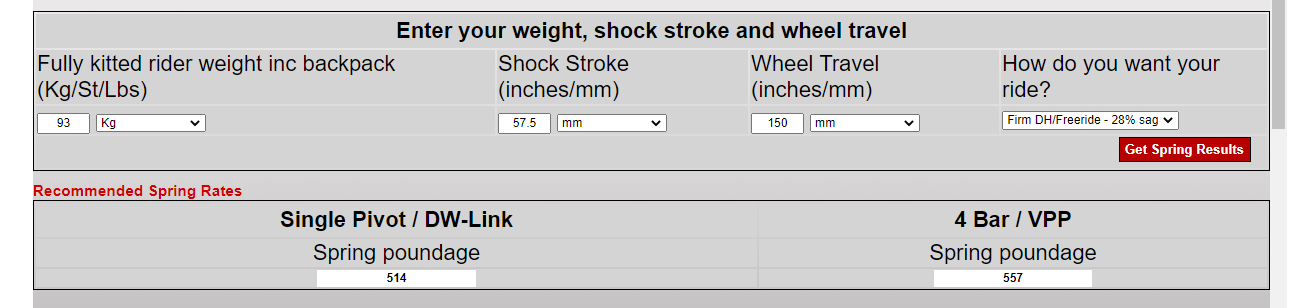

@Doug Stampfer it would be useful if you could compare what your importer spec'd compared to the TFTuned spring calculator.
Doug Stampfer
Jul 7, 2018
738
756
NZ
The TF tuned calculator seems to recommend a 480-514 - I'm 86kgs & they say to add another 5kgs for ebike weight (which I can't see how that matters as thats unsprung weight but they're the experts) so 93kgs
I'm running a 600.
Doomanic
🛠️Wrecker🛠️
Jan 21, 2018
8,874
10,691
I'm a similar weight to you and I'm running a 550.
I got slightly different results to you though, did you get the stroke and travel correct? 57.5mm and 150mm.
Doug Stampfer
Jul 7, 2018
738
756
NZ
Hi all. Yes sorry Doom I got 514 for 28% & 481 for 30%
I don't think I'd be changing anything now. I realise the coil was OK it was just I was so used to a squatting basic shock that the change was very different & takes a bit of getting used to.
I thought unsprung weight was the weight below the suspension therefore not relevant to the suspension setting, not the weight sitting on the suspension however just did a google & you're correct, they've changed it on me without telling me!

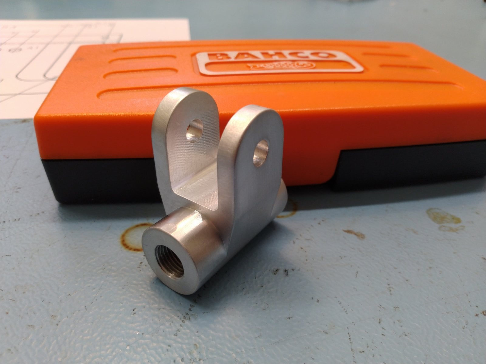

God, I miss the days that I had access to CNC lathes and mills.
I once designed and machined a progressive linkage for my Proflex 856, upping the travel to 125mm to match my RST Hi 5 dual crown forks.
