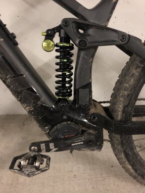

So just had first ride on Jade X, left reb all the way in and its SICK!
Biggest noticeable thing on decents was how much harder I could brake without locking rear....huge improvement! Pedaled the whole ride in full open, no dramas at all, tried the full lockout for 10 sec and was like being on a hard tail.
The 500lb spring was really nice and plush for my 95kg ride weight, disnt notice any bottom outs.
The shock is plush as a plush thing!
No regrets in the slightest after maiden ride, have only had six rides in total on the Rail 9 and am beating KOM's even in winter ?
Planning on upgrading to DVO Jade X. Did you get a 230x57.5? and did you need parts for mounting? Cheers!

Yep 57.5, haven't needed any extra travel so far.
I've got a 9 so did need mounting hardware as it has the trunnion mount shock. The 7 has thru bolt shock but not sure if it needs different hardware or just correct shock bushes sorry.

I've got a 230*60 Jade X on a Rail 7. I reused the original shock hardware but had to modify the spacers. The low friction bushes on the Jade X are wider than the OEM Rockshox so you need to take approximately 1.1mm off each spacer. Ideally, you'd use a lathe but as I don't have access to one I very carefully linished them down to the correct length.
Incidentally, the Jade uses different lower spring cups to limit travel so it's very easy to adjust, assuming your dealer can order them in.

@Doomanic is DVO selling the mounting bolts and spacers needed for the Rail 7? If yes, which size do I need? With my diy skills I’m not really confident on reducing the thickness of the spacers ?
Thanks to both of you, I appreciate the quick replies.

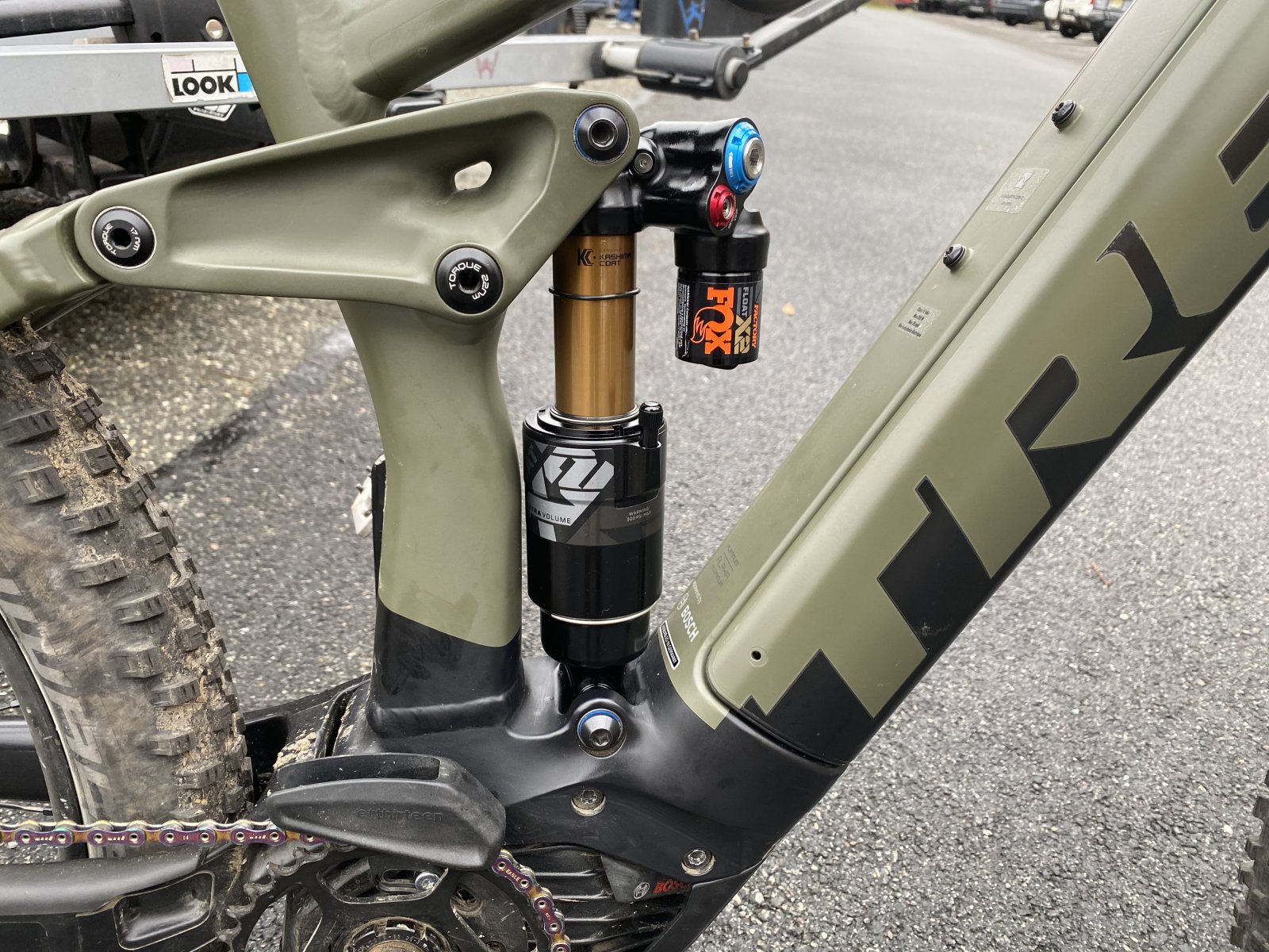

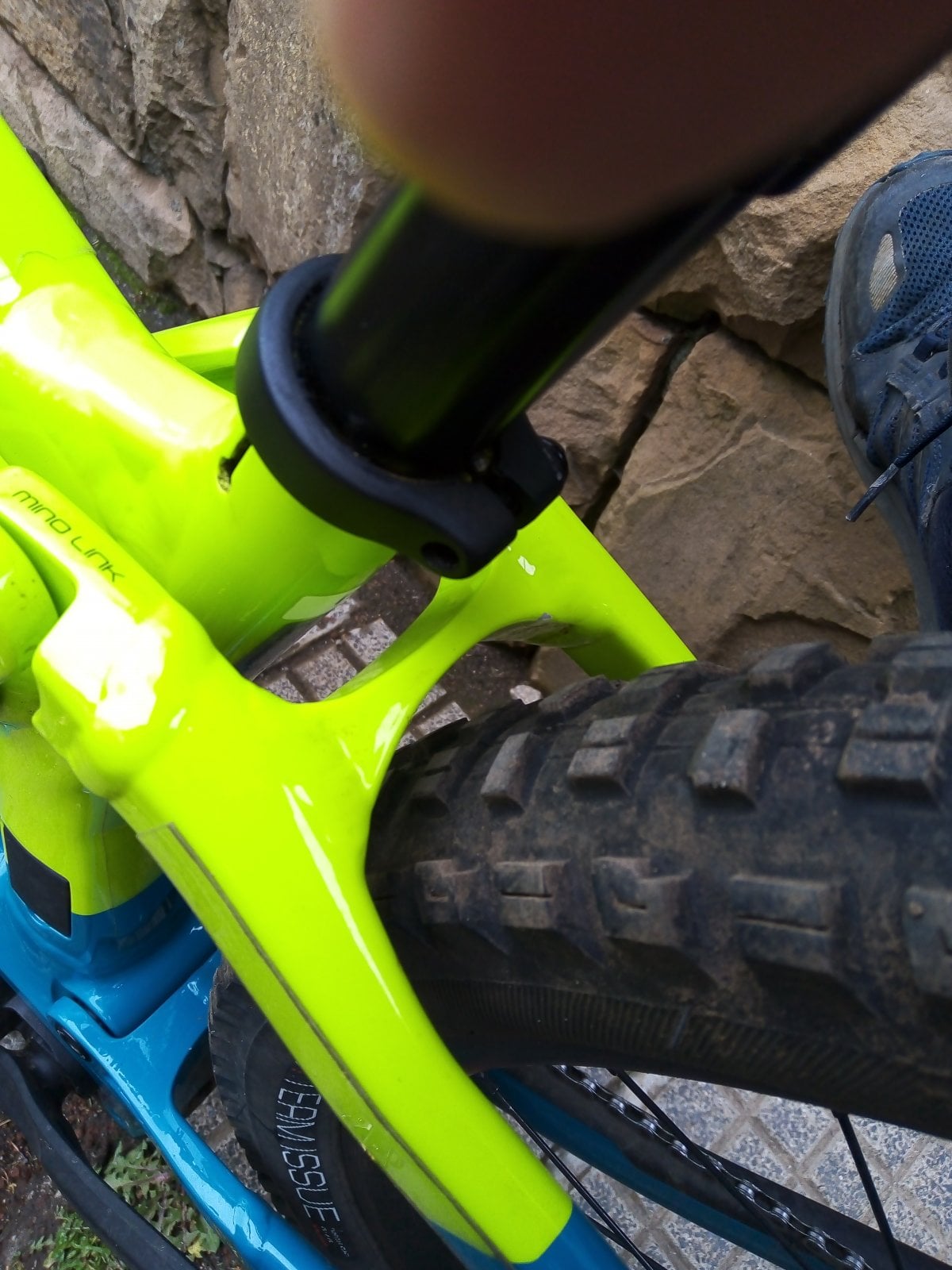

Bought a Fox DPX2 230x60 and just installed on my Rail 7 Medium. Just swaped all hardware from the oem rock shox

Can you post a pic of the shock at full compression?

Nothing, used all the hardware from the Deluxe, even the bushings. If you don't want to remove the bushings, you should cut the lips of the Fox plastic bushings, with them, it's to wide.

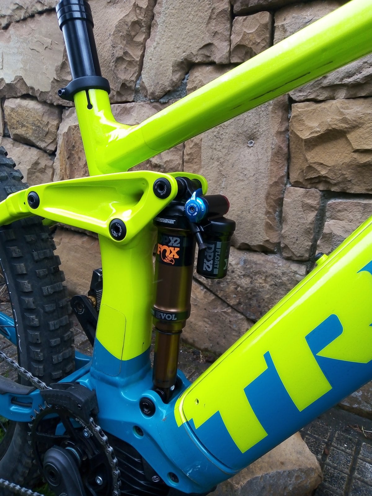

Fox Float X2 230x57.5 on medium Rail 5. Re-used all mounting hardware from Rockshox shock bike came with, including the DU bushing from both eyelets.
No clearance issues with down tube when shock is fully compressed.
Did you get the Trunnion mount X2 for this? I cannot see in the picture. I have the re:activ so has the yoke on the bottom, so presume will need some hardware for the bottom?

Non trunnion mount just as is the original shock my Rail 5 came with.
