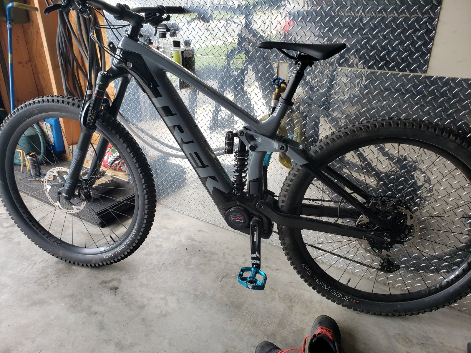

Guys with the coil shock do you feel like the suspension bottoms out to easily due to the shock being so linear? I have the Jade X and everything is great on it but i hit some chunky high speed trails and it almost seemed like it was to low in the travel to often? could just be in my head or how the Ebike rides
Nope, the Rail is reasonably progressive (certainly in the zone for working with a coil). How much sag are you running? Maybe i'm slightly different as my shock has a hydraulic bottom out.

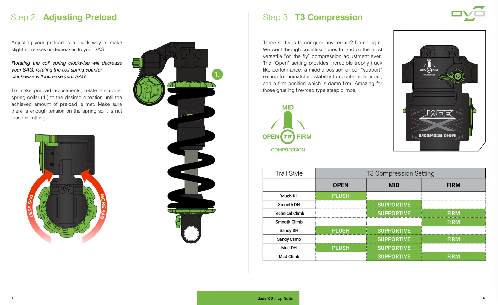

I would also suggest reaching out to the guys at DVO, I worked with Ronnie and he help work on settings on the D1 Boost and Topaz 3 from my previous eMTB. Everything recommended by him did the trick. From my experience with DVO suspension, that the switch can be flipped to firm and is still ridable.

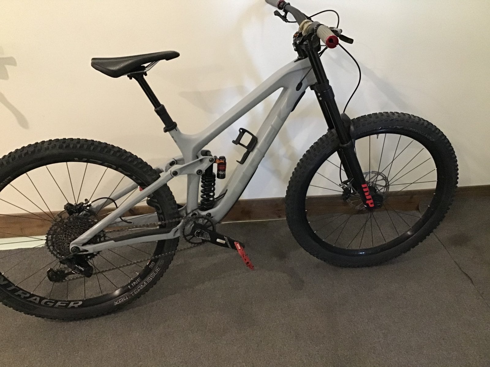

Can confirm the EXT Storia does fit, but needs the shorter piggyback option. (45mm rather than 55mm).
Bike was running 230x60 for a bit more rear travel, had to put a spacer in, so it's now 230x59 to ensure it doesn't hit on hard bottom out.
do you have a picture ... Im thinking of going with Storia for my rail...

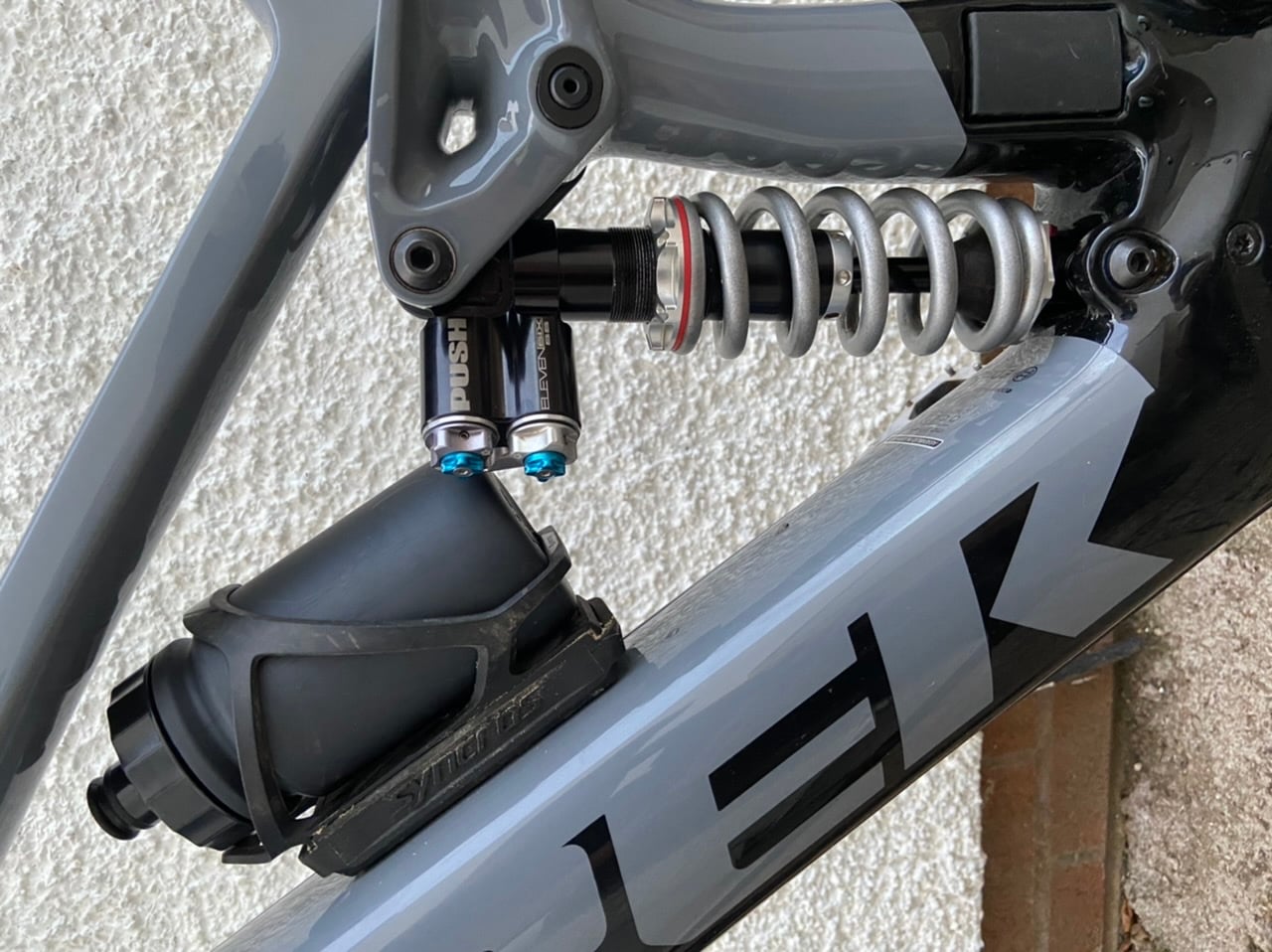

For those interested. A Push 11-6 SS fits. Mine is 230x65mm & it ‘just’ has enough seatstay brace clearance against the back of the seat tube. I have put a 1mm spacer in it just to ensure if Indont fully bottom out on a hard flat landing & have a contact.
I think it equates to approx 166mm rear wheel travel. It also just fits a bottle now too, which is a win :)

Got a picture of it? I have a 230 x 60 on my sb150 and would like to put it on my rail 9.9. What hardware/spacers did you use?
