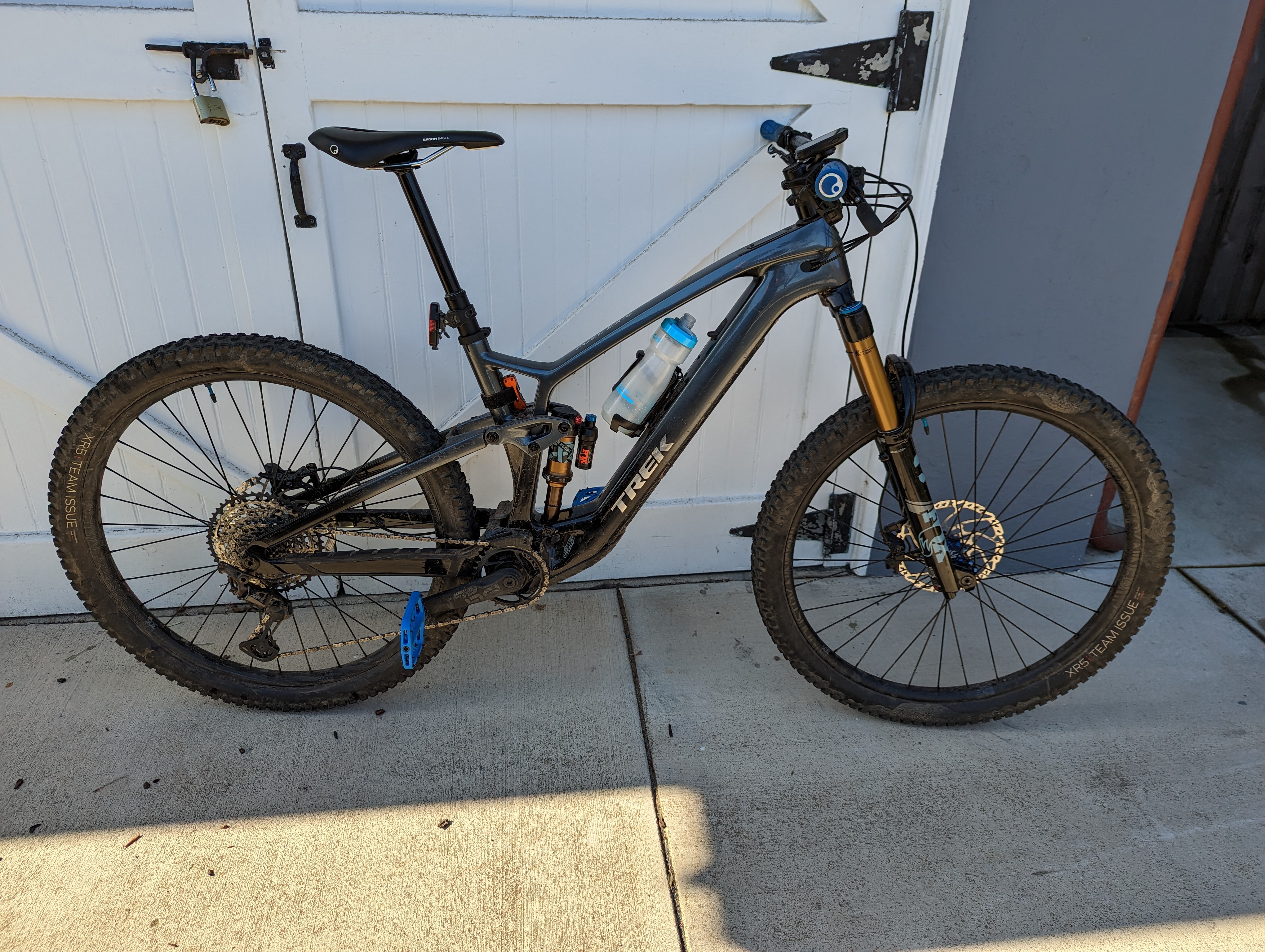

I am not finding work to be of much interest today.....
Started off as a 9.7 in November. Plan was to ride it stock for a while to do incremental upgrades as needed. Plan lasted about five minutes. Current build.
Fox Factory 38 fork at 160mm with one token.
Fox Factory Float X at 162.5 mm
Industry Nine 305 wheels
One Up 210mm dropper with Wolf Tooth LT lever
PNW bars and stem
Ergon Fat grips
Ergon seat
PNW plastic pedals
Bont tires are not bad. Shimano brakes worky for me. No need for me switch drivetrains- like my bikes electric and my shifting mechanical.

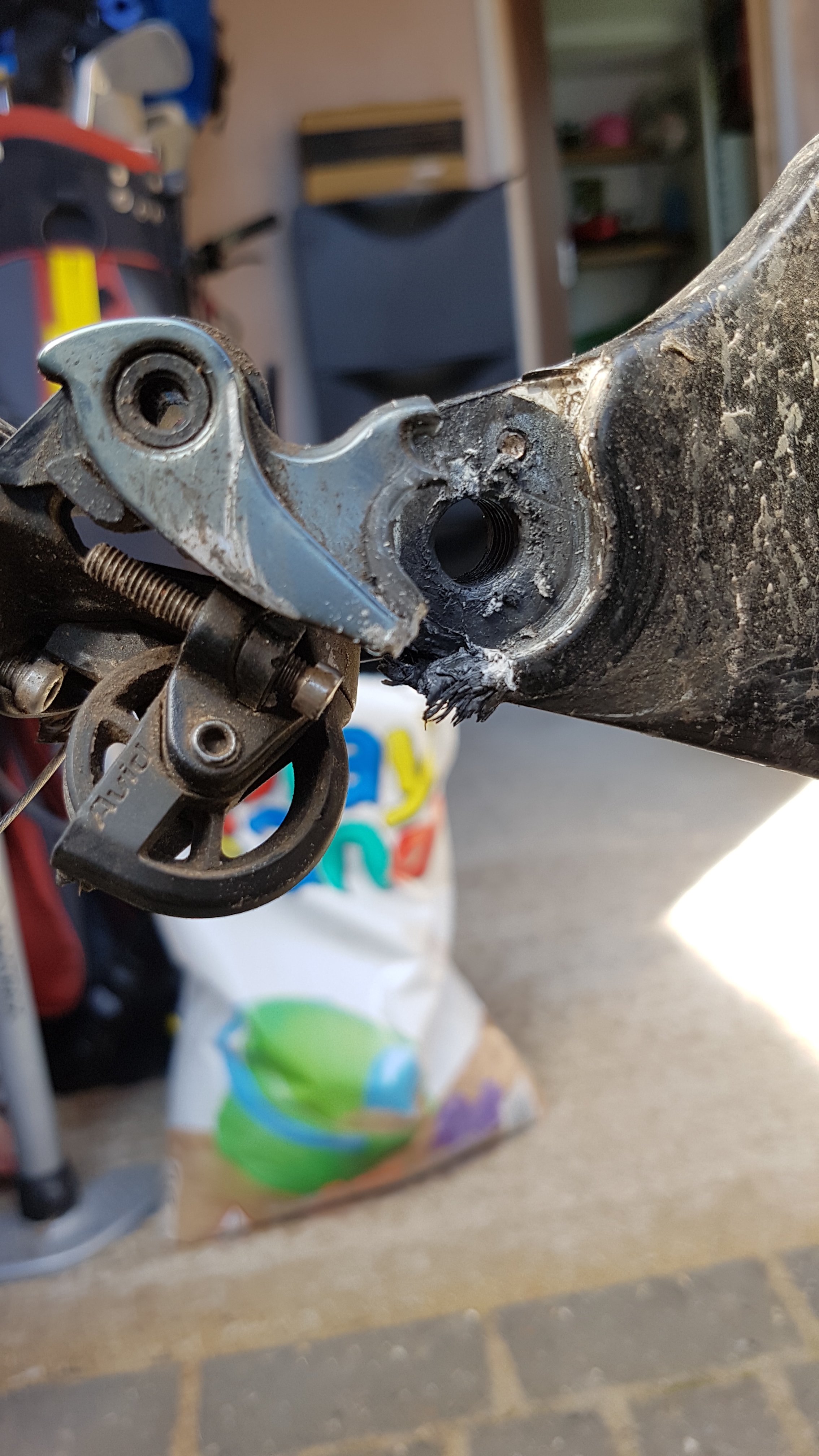

It's not those kinds of loads that will shear. Those will pass to the stays. But if the derailleur rotates upwards like in the case you get a stick in the wheel something have to give and it is designed to rotate up, but now there is a shearing shim clamped to the frame with 35nm.
Not disagreeing with your point, but I would note that a hanger doesn't protect your bike from the stick-in-wheel scenario you describe 😦
This is the seat stay of my Norco Sight. I "repaired" it but it shifts like crap now, I really must bite the bullet and buy a replacement.
