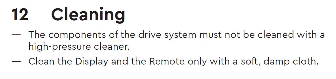

Today I hosed mine off for the first time using a spray nozzle. It was easy to miss the display and the cable ports. It worked well.

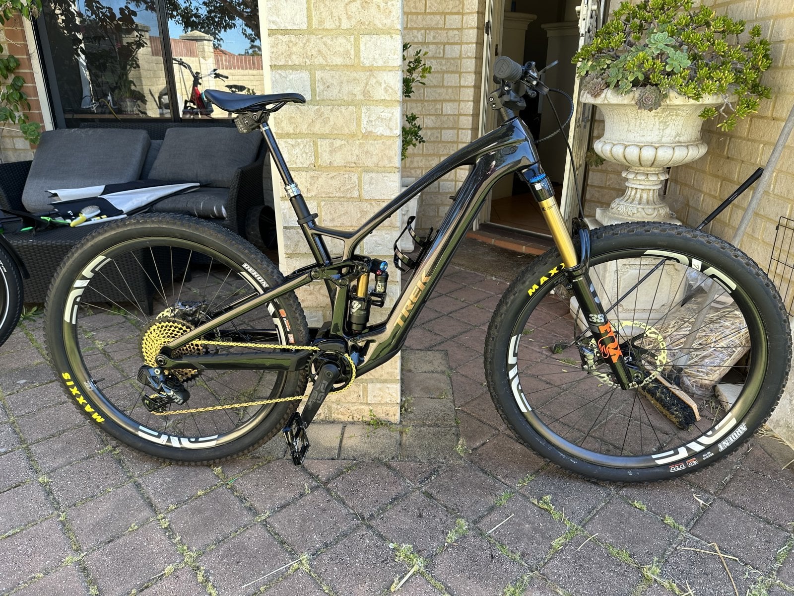

170mm Ohlins Fork, 150mm Ohlins Coil, DD DHR2
19.28 KG.

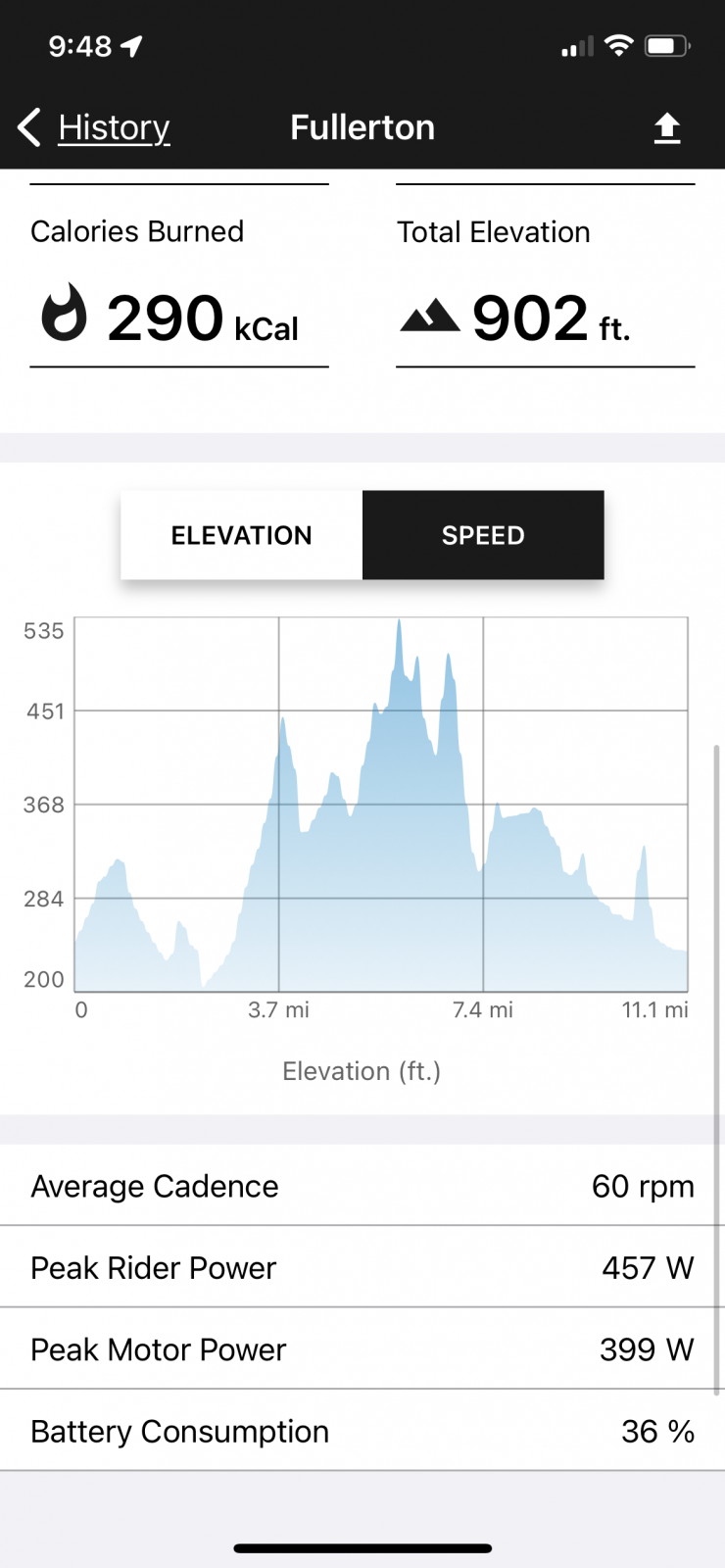

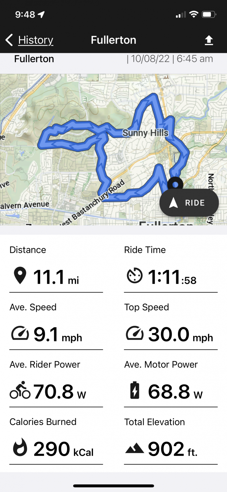

Did a ride at Fullerton loop here in SoCal. 65% left from full charge using mixed settings using stock presets.
12 years ago it takes me 2:30 hrs to finish on a regular bike because of my health issues. With the EXe it allows me to keep up with my friends and enjoy it instead of stressing my body. So far no issues, bike is smooth. Hopefully it stays that way.
