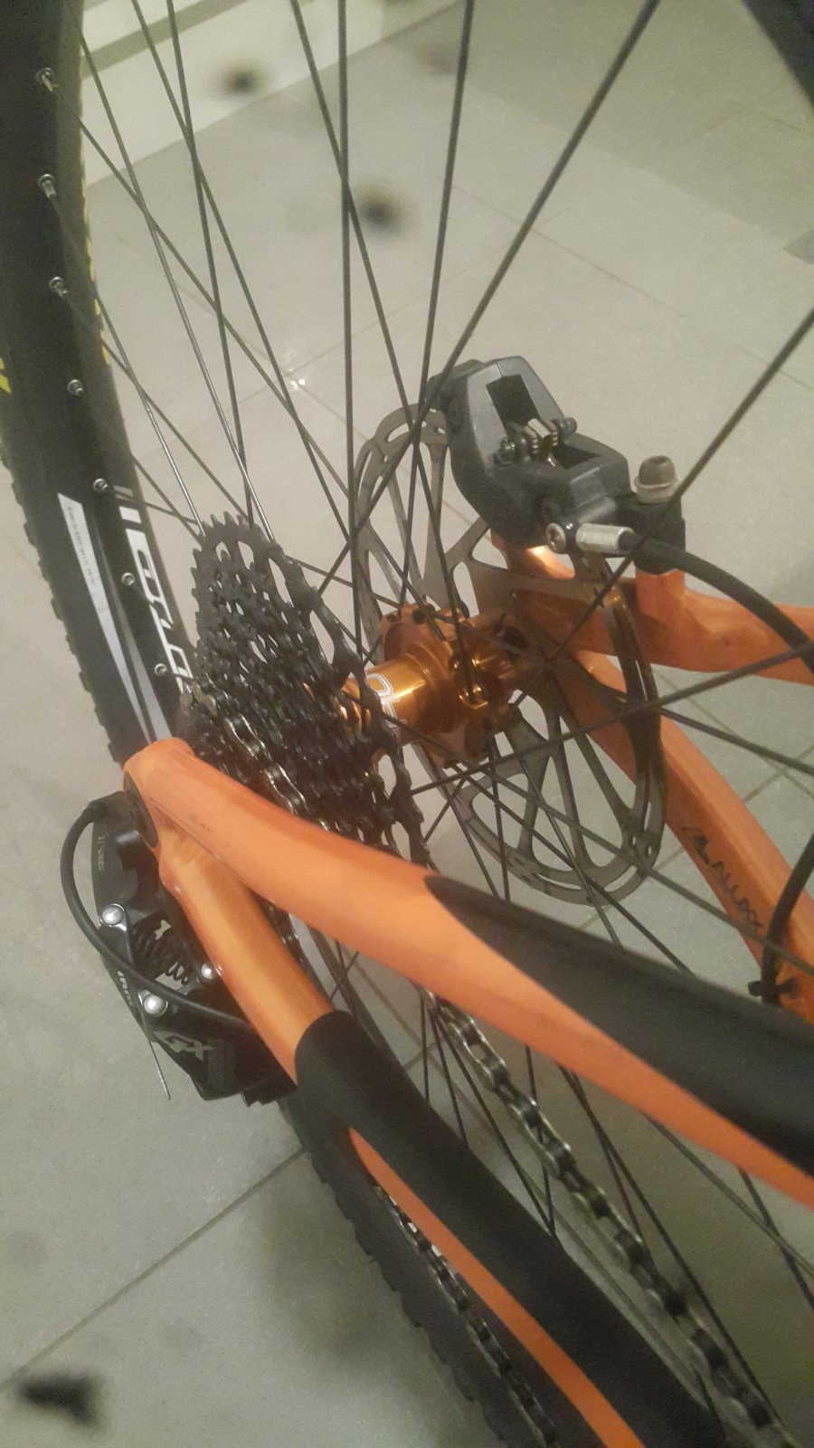

Finally got the new wheel rock n rolling. Also replaced the 1x12 system with a sram gx 1x11 and new px1 chain. Thought the smaller gearing would equal less torque on the hub in low gear. The new shifter also allows for 5 clicks in single push. I hated the single click.
Also running a maxxis DHRII same as the SX
friartuckshop
Jan 2, 2019
102
51
Auckland New Zealand
How does it ride? Fast engagement I bet. Also the orange is a pretty good match,looks good
The Flying Dutchman
Jan 16, 2019
340
556
Wellington NZ
Only went up and the street for a test run haha which went well
hub feels crisp, fast engagement and the hub has a loud sharp sound....which I like
Also the lateral wheel flex was considerably less than the giant
Went to ride it this morning and noticed the rear tire was flat o_Oo_O
Still figuring this tubeless thing out.
Will rebed the value this evening and ride:
