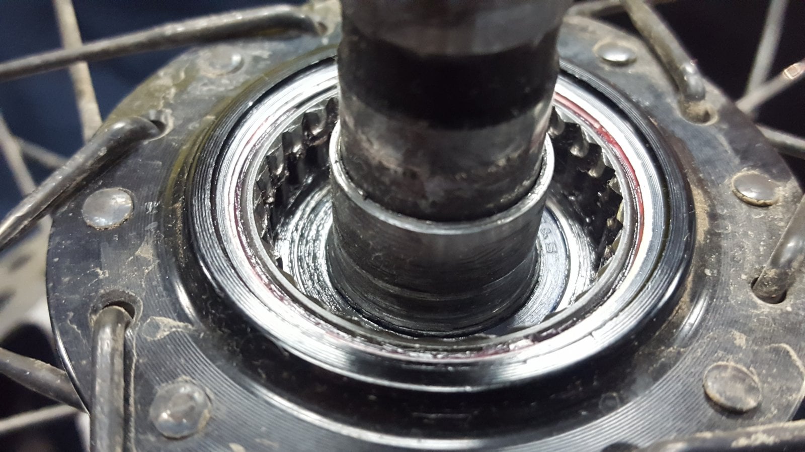

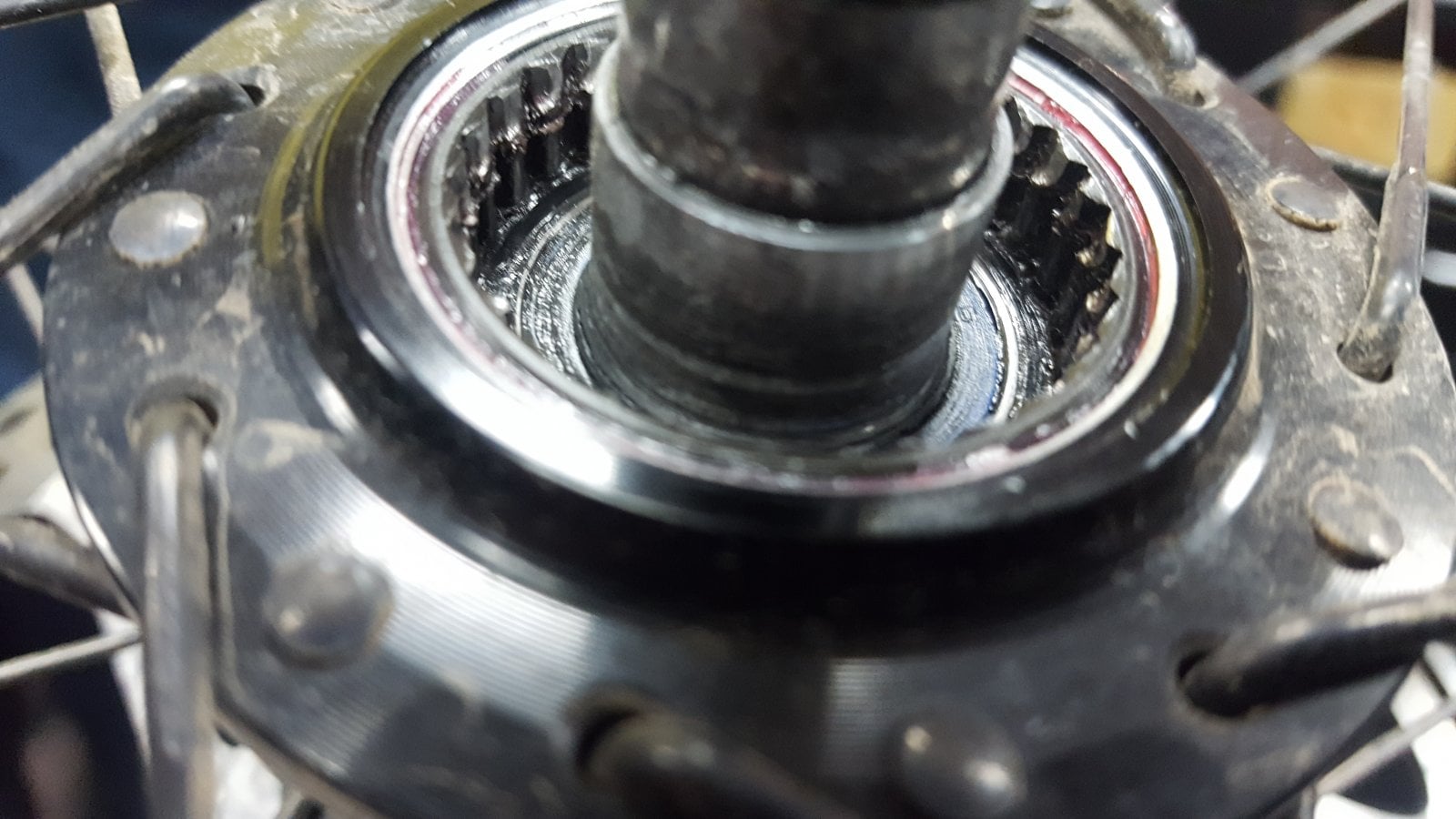

This is the inside of my 1st freehub. Lunched all the pawls and the ratchet gear.
This is the inside of my second freehub.
Broke a pawl and it spun the ratchet gear inside the hub. They are screwed into place.

Mine looks like your first wheel Poppy. Get on to giant AU, as i believe they should be sourcing the new strengthened parts to repair the hubs and freehub. By all accounts they should be get the replacement part in very soon. i am hoping to have mine back early next week, but i have said that before

I think the ratchet system in the DT Swiss hubs might be a good option or a hub with more than 3 points of contact. A lot of load gets put through the drive system and the hub seems the weekest link.

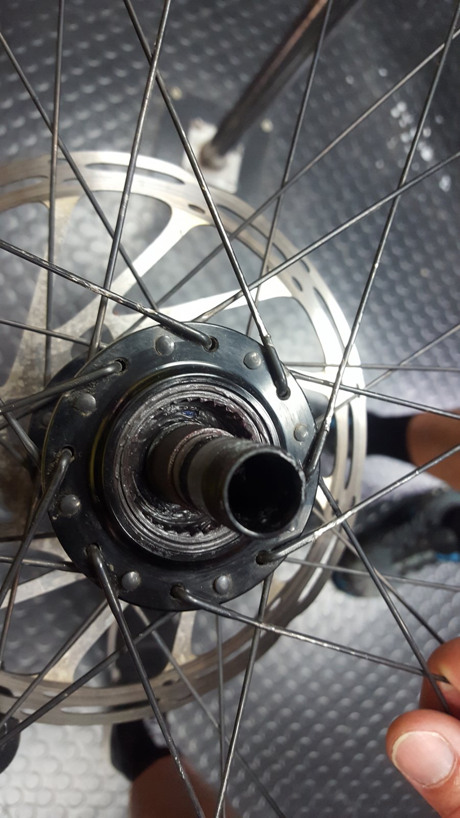

Brought mine back to shop before I had failure out in the trails leaving me stranded. Ironically the mechanic took it for a ride and the first corner the hub totally died. Looks like I'm in the same boat waiting to hear back from Giant.

Got my bike and as expected like for like replacement since the new parts aren't available yet. Surprisingly the pawls were OK but it was the ratchet that was worn. They had to replace the whole hub and the "upgraded version" will have a replaceable ratchet to eliminate the full hub replacement and is "hopefully" made with harder metals.

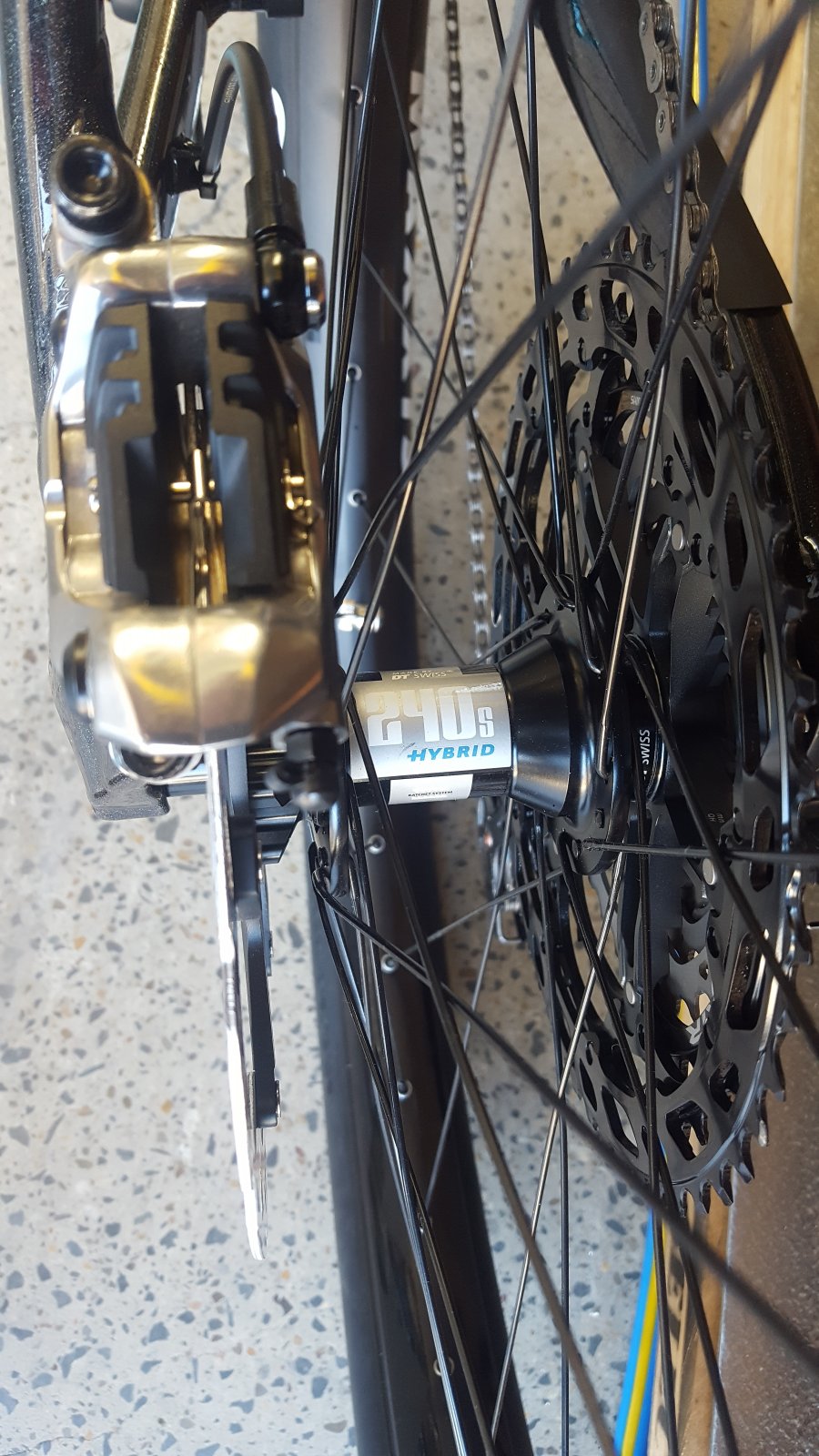

I got a phone call from Giant NZ this afternoon, to say that the upgraded hubs have arrived from Taiwan, it seems that your bike and my bike were the only 2 in NZ to have this issue. So i would expect that your LBS should be getting the parts to repair the hubs very soon. I hope that i will have mine back in time for some riding over the weekend. I will keep everybody up to date with how the upgrade goes. Again i commend Giant NZ for there help, and freely providing the information about there findings, and listening to my bitching about the issue. Lets hope these are the only issues with the trance
I actually wonder if I got a whole new wheel or if they just replaced the internals of the hub. Suppose it doesn't matter as long as the problem doesn't happen again.
Can I ask what you mean by "upgraded hubs" are you getting aftermarket or just a new giant one? I think I might replace mine out of my own pocket in the future anyways.
My issues were managed through Evo Cycles in Wellington and I must say I was very impressed with their service. Went above and beyond to sort the issue(s) even going as far as taking a wheel off their demo bike so I could ride whilst they sorted a replacement, they also personally picked up the bike from my house and delivered back to me once the repairs were done. Good shit!!

Dutchman will let you know tomorrow regarding the hub being new or just the parts replaced. But from what I understand it's completely new internals. Bearings, Axel's ,and free hub internals

That's what I wanted to see Poppy, they are using the DT Swiss hybrid hub system.is this the giant replacement? Or did you buy a new wheelset
G'day FTS, new bike. Like you, my LBS has been nothing short of awesome to deal with. I have had issues with my Pro 1 basically since i have had it. So it was agreed that it was time for another bike, so they looked after me on price and i upgraded. They did get a new E PRO 1 in for me but decided to upgrade and hopefully have a bit of a luck change.
