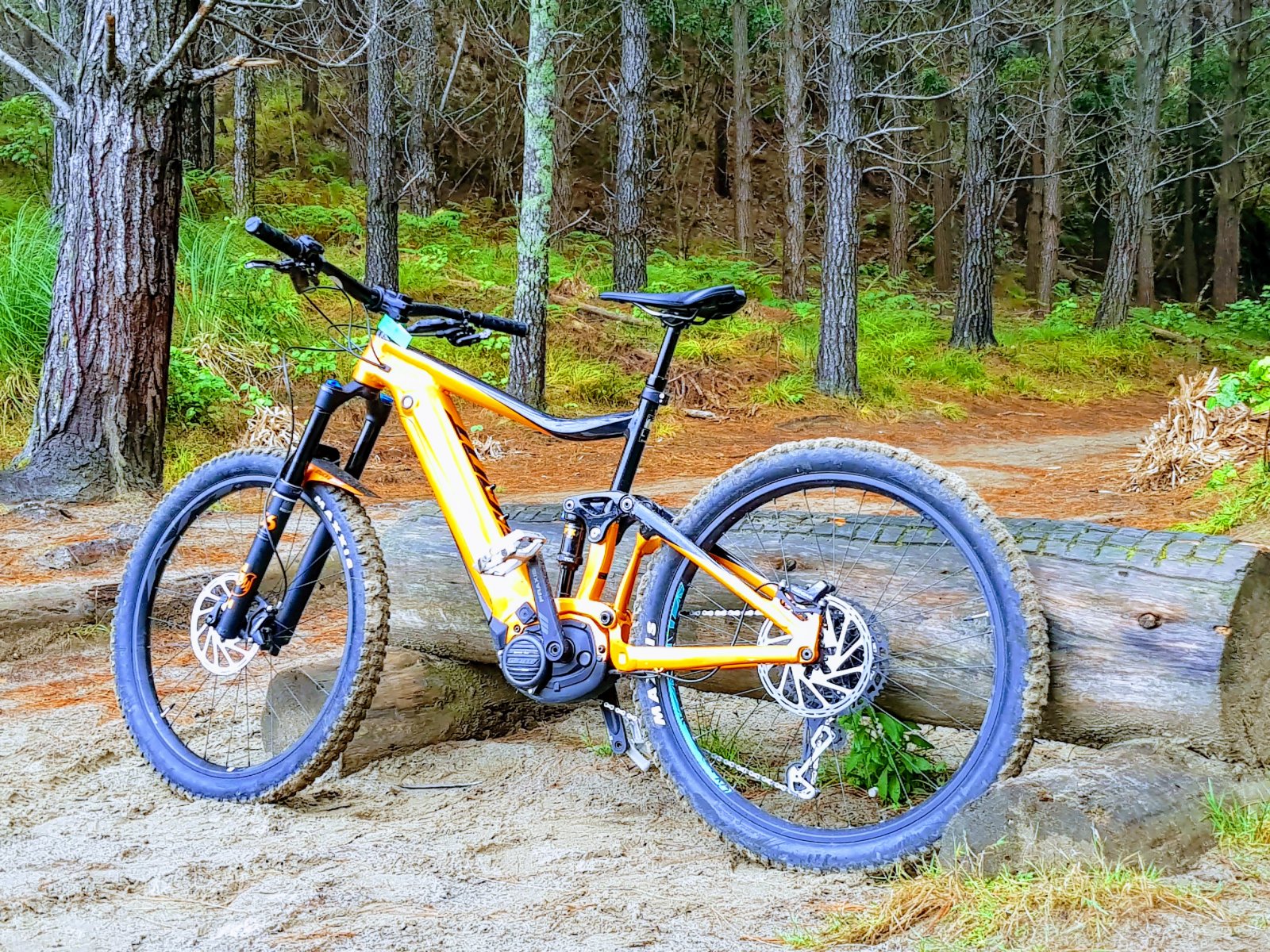

Its not an issue with the hub paws so i have been told but an aluminium shim in the hub assemble that is being crushed due to the increased power output. This then causes the paws to miss align and fail. I couldn't be bothered waiting 3-4 weeks for parts (Giant hub) and wanted a louder hub anyway so ill take the upgrade to the DT 350 hybrid EMBT specific hub.
Thats the same response that i had from Giant NZ as well Rob. I really dont think that that is the whole issue, as the say its also related to the extra torque of the 50t eagle cassette, but its not just the eagle equipped hubs that have failed. the old Full E bike from 2017 ran virtually the same motor (80nM?) and those wheel sets didnt have the same failures as the current generation.

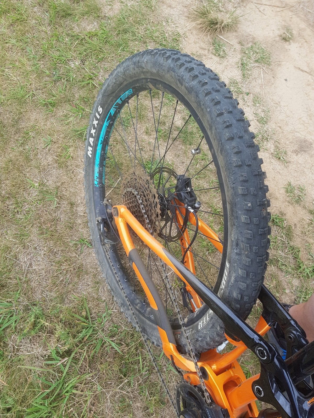

So Nick from Giant NZ supplied a temporary replacement wheel, to see how this hub goes. As you might be able to tell from the first photo its from the LIV range of EMTBs, which are basically the same set up as the e-trance motor wise. I spent the morning at Te Miro MTB Park, had 700m of climbing over about 20 kms. So give the wheel a good workout, did a lot of riding in turbo (high gear, low cadence, as well as spinning in a low gear), wheel performed well, no dramas what so ever, Felt real strong whether climbing or descending. Its kind of strange that giant supplied wheel that seems to be strong enough to the LIV range that were released a good 6 months before the e-trance, but then fitted a hub that clearly isnt fit for purpose on their E-trance range, i guess trying to save some money in production costs. Will see how the wheel holds up over the next couple of days, as got a couple more rides planned of the long weekend. Fingers crossed no dramas this time

good spot Poppy, yeah didnt notice that. seems like they are completely different wheel sets between the LIV and regular e-trance. the hubs look very similar though, so not sure how the internals differ from the faulty hubs. Did another 25k today with no issues, so things are finally looking up i guess
