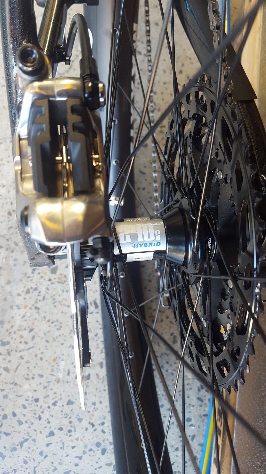

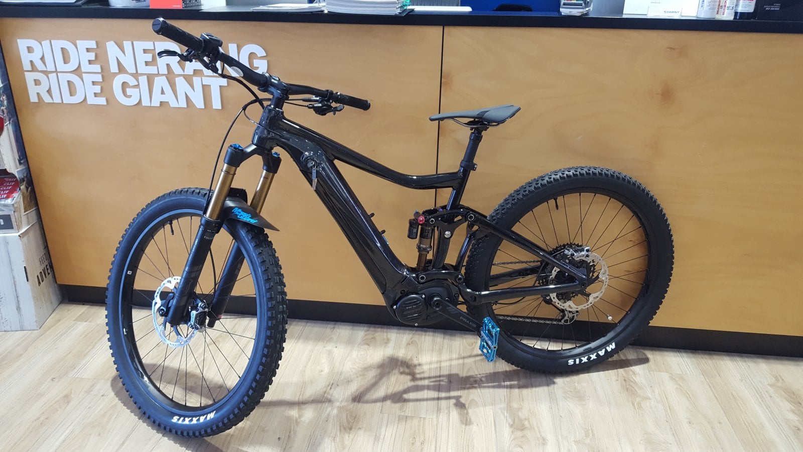

G'day FTS, new bike. Like you, my LBS has been nothing short of awesome to deal with. I have had issues with my Pro 1 basically since i have had it. So it was agreed that it was time for another bike, so they looked after me on price and i upgraded. They did get a new E PRO 1 in for me but decided to upgrade and hopefully have a bit of a luck change.
its an awesome looking bike Poppy. How much did the wheelset set you back? pretty sure you wont have an issues with those hubs

Hi Mate, came with the bike. I changed from E PRO 1 to E PRO 0.
I thought they spec the same wheels for all the bikes. That bike is pretty nice, i couldnt justify the price difference. But with the XTR and factory forks i reckon it would be worth every cent. will you be hitting up gap creek today then

the giant branded hubs are supposedly DT Swiss built, but i would suspect they would be the lower end offerings, and not based off the 240s. i am hoping this upgrade will bring them upto at least the 350 standard, which is what the h 1700 a based around
