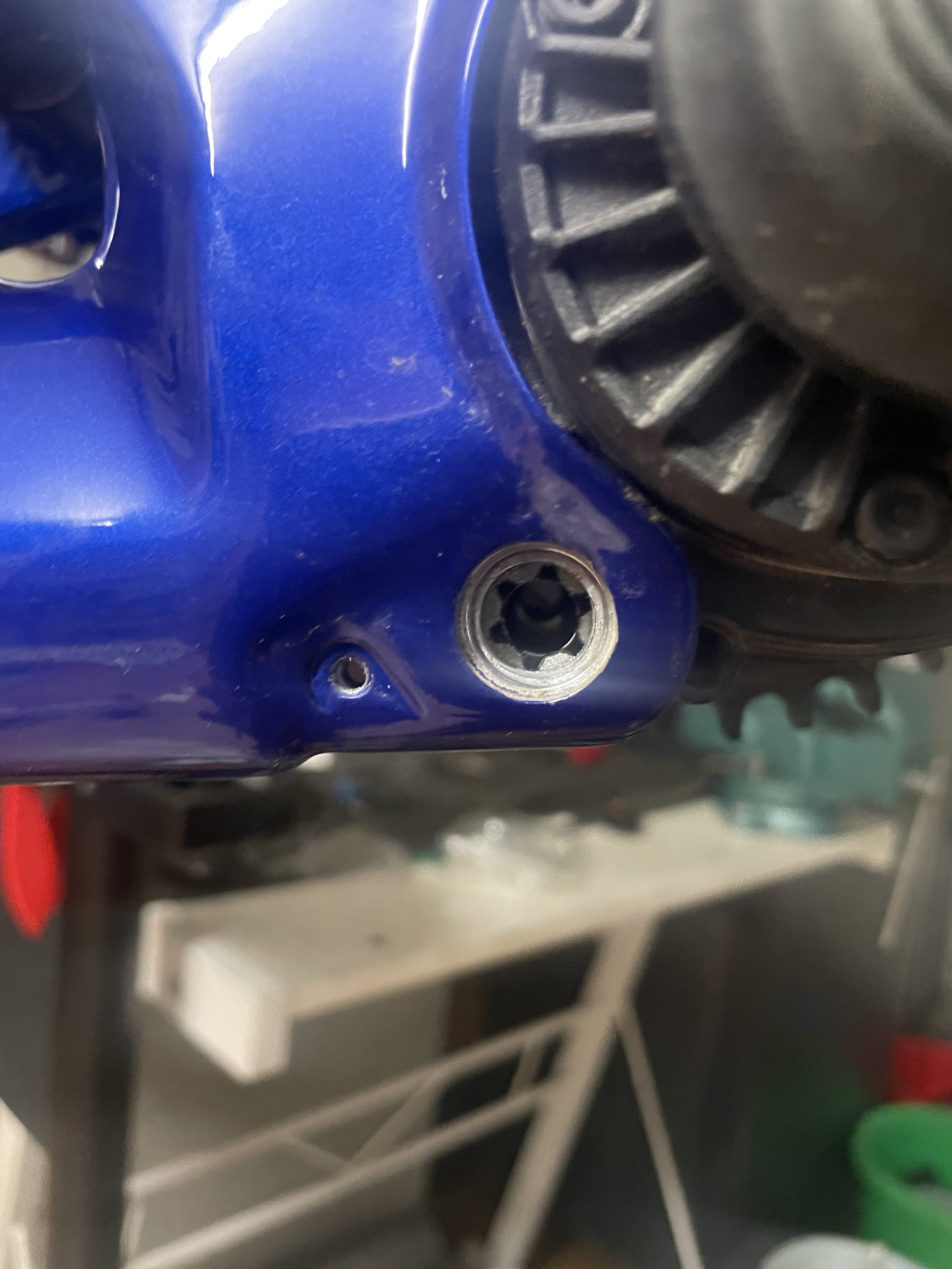

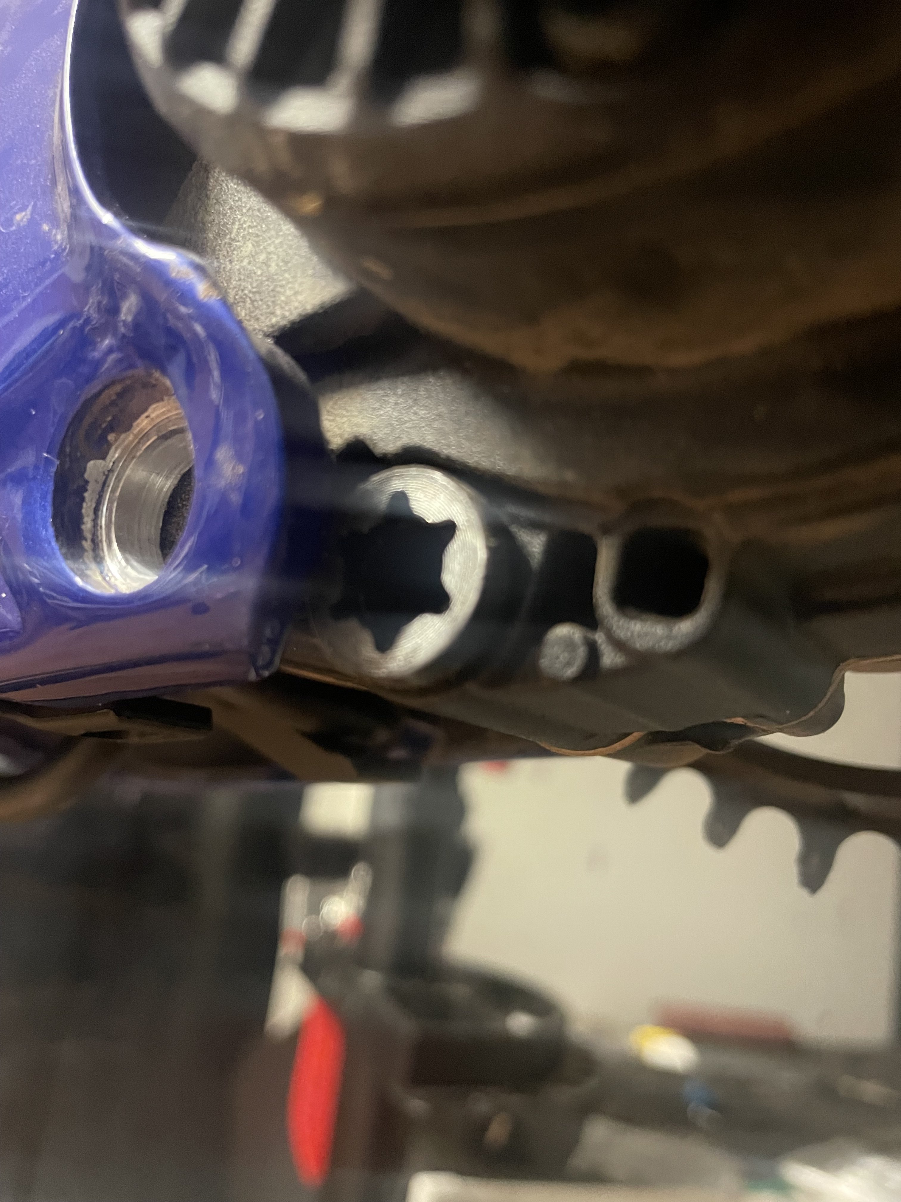

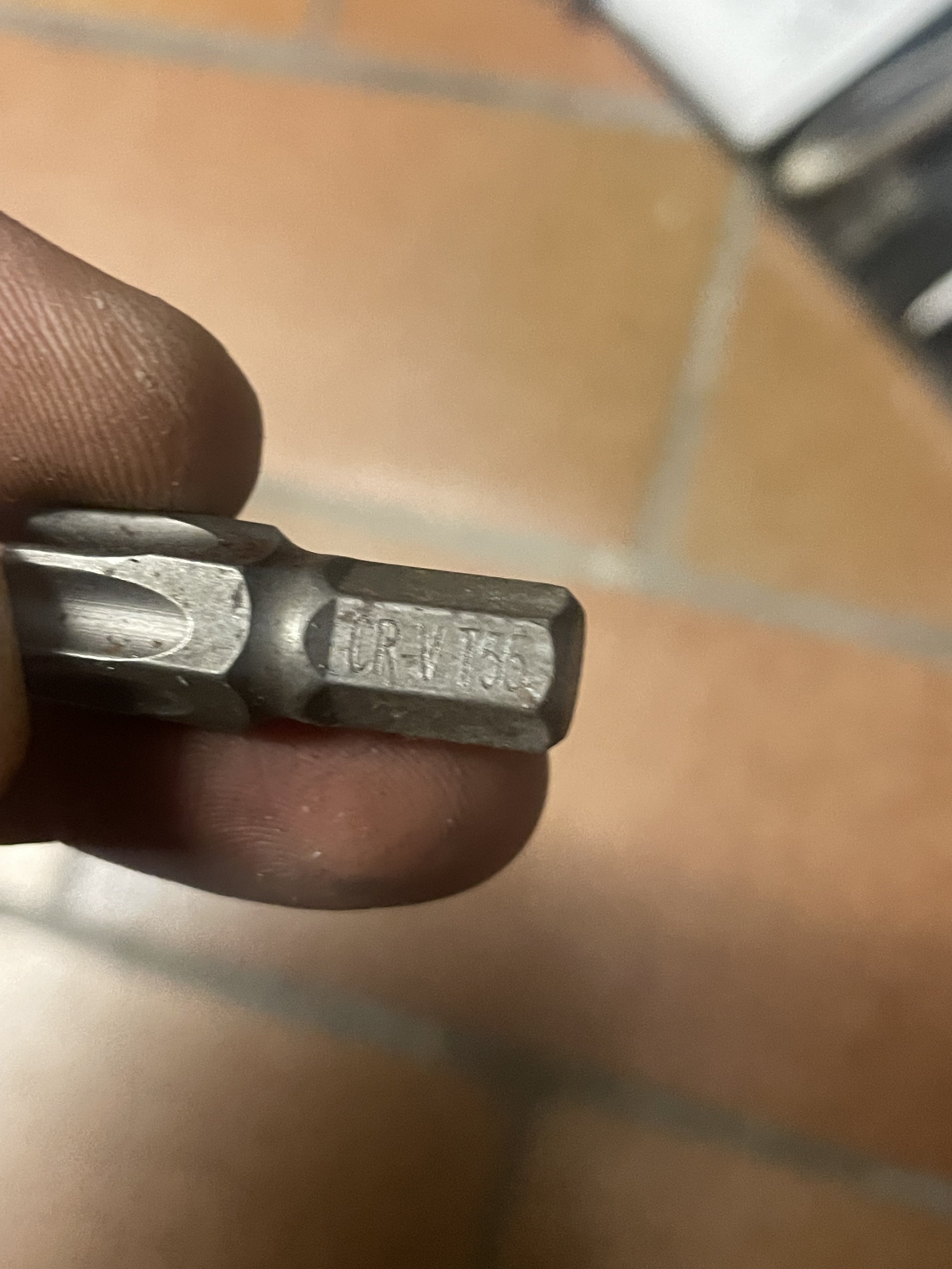

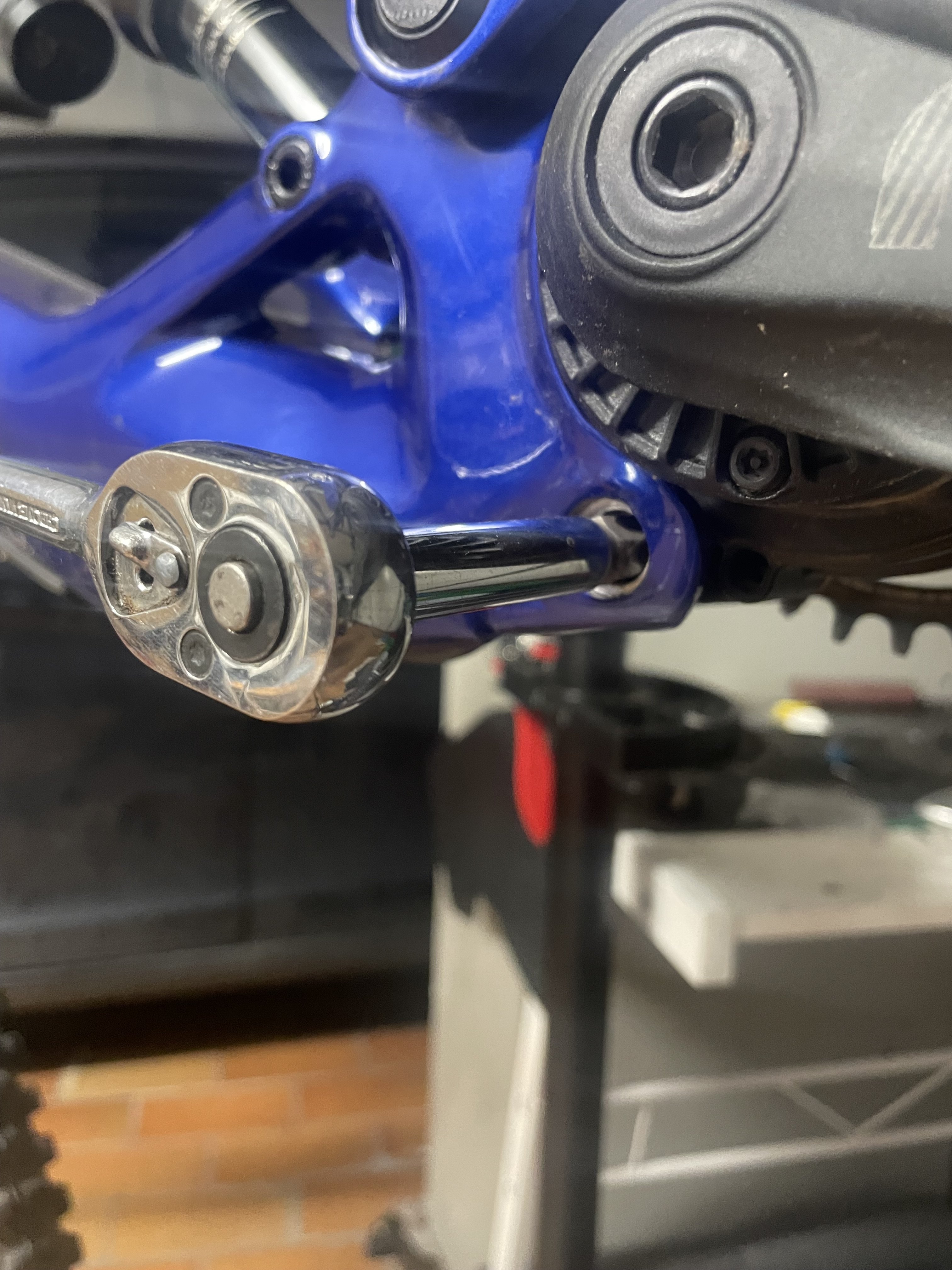

Decolocsta
Aug 10, 2022
71
215
Clicking noise, if Sounds like Shoe laces hitting the Crankarm?
I had that to.
The newer versions of the TQ have adjustable Motor Mounts.
The Upper one was Fine.
The lower one had some Play, After readjusting the Noise went away.
volts
May 15, 2018
343
266
DK
I had that to.
Thanks for the nice walkthrough and pictures.
That however is not how mine sounds. It's more like a leaf caught in the wheel type of sound. Only makes the sound when the motor is working, not free wheeling or pedaling without motor on or pedaling without motor engaging.
