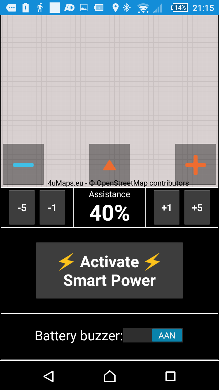

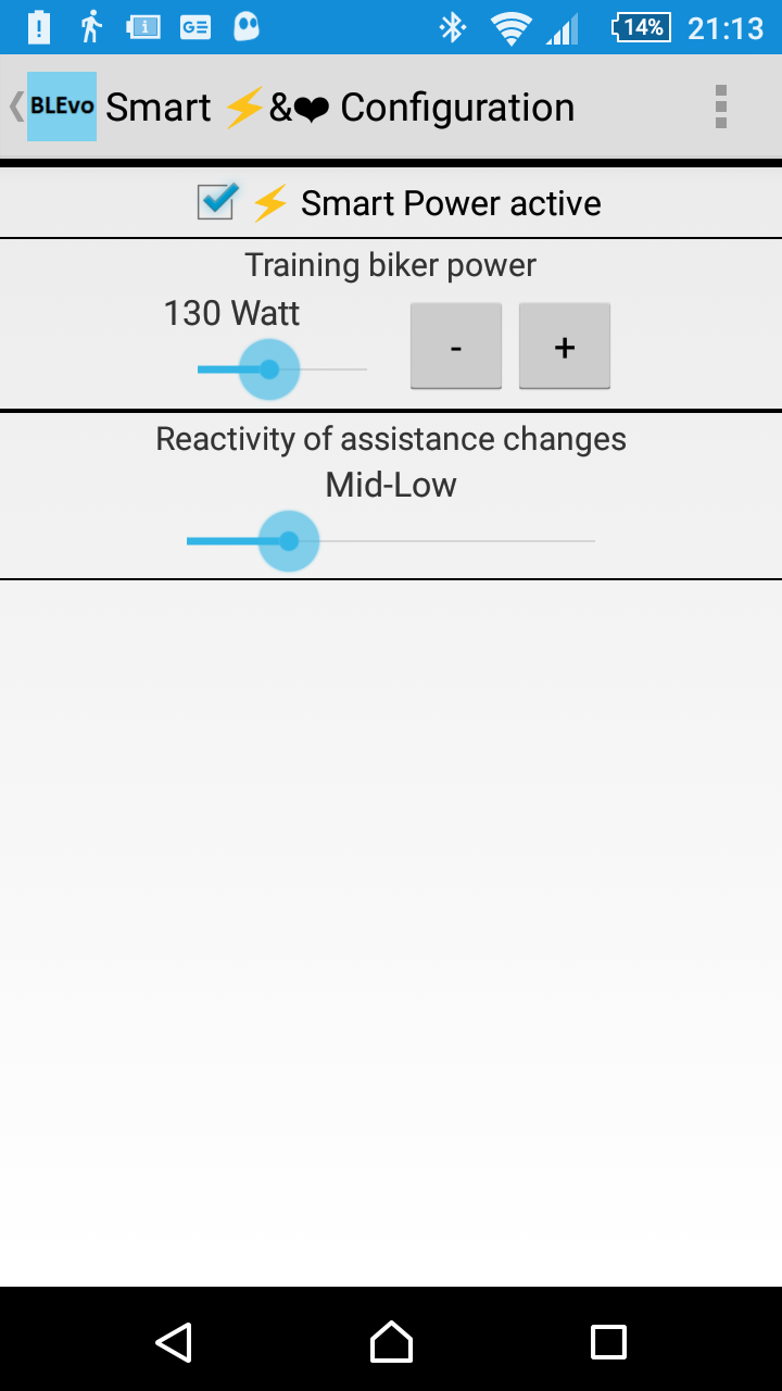

Hello Paolo, thanks for the quick response.
I know the button at the bottom of the bikemonitor page. When I activate the smart power it works but every new ride I have to activate it again. Is there another way so the smartpower is always activated.
The Smart Power can be activated in the Smart Power configuration menu.. please check if the Smart Power is active also in wanted assistance level..

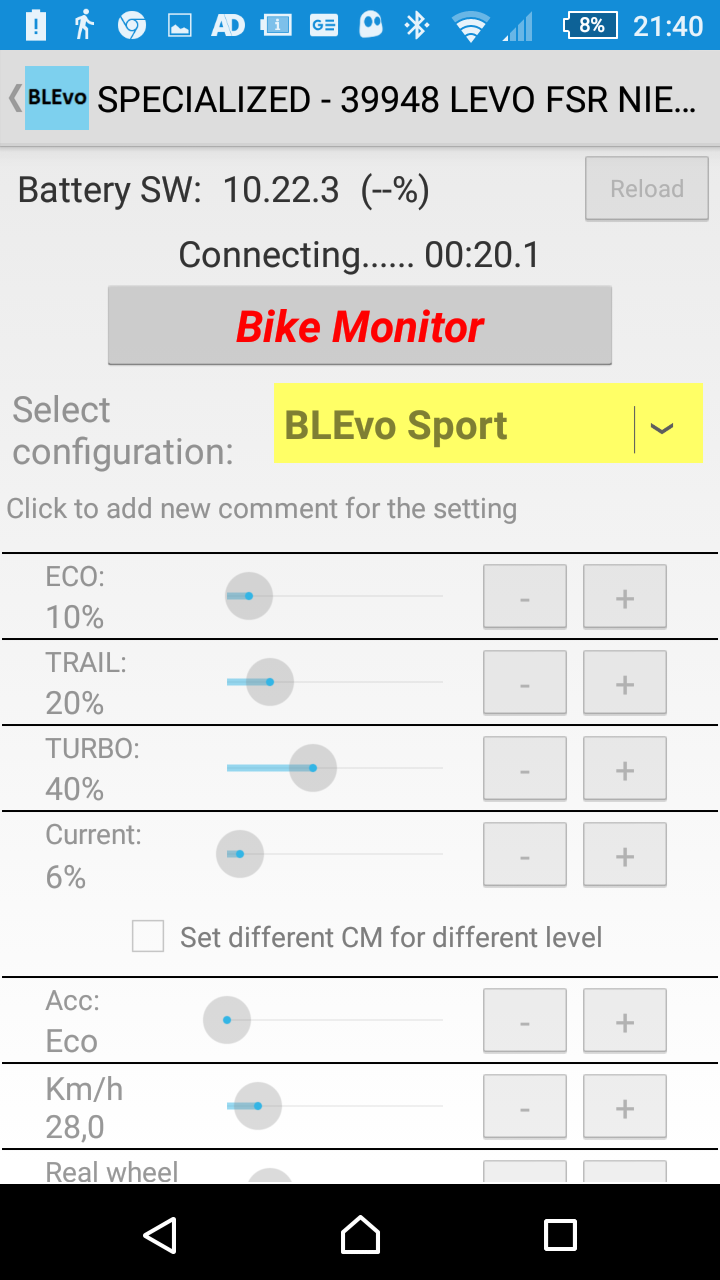

The smart power is activated in the smartpower configuration menu
Each time I start a new ride I have to activate the smart power at the bottom of the bikemonitor. Also when I make a manual pause the smart power has to be activated. I tryed this also with expert and the same think happens. Look at the pictures
I think you should select “BLEvo Smart” instead of “BLEvo Sport”. I always select “BLEvo Smart” and have no problems with smart power.
I tryed almost every mode in the bike setup. Everytime I had to activate again the smartpower at the bottom of bike monitor.Also I had to activate again when I made a manuel pause.

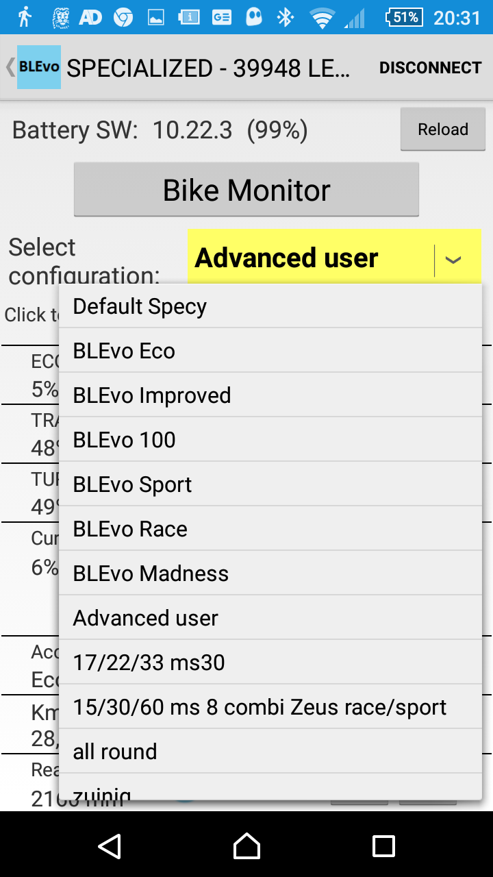

Maastricht wrote hé used BLEVO SMART but it does not exsist I think. Look at the picture
Maastricht
Oct 3, 2018
646
655
M
I just checked the manual once more. I wasn’t aware about your firmware x.22.
It seems that in x.22 this preset is missing:
See page 4&5. Sorry, I don’t have an explanation for the issue you seem to be experiencing.

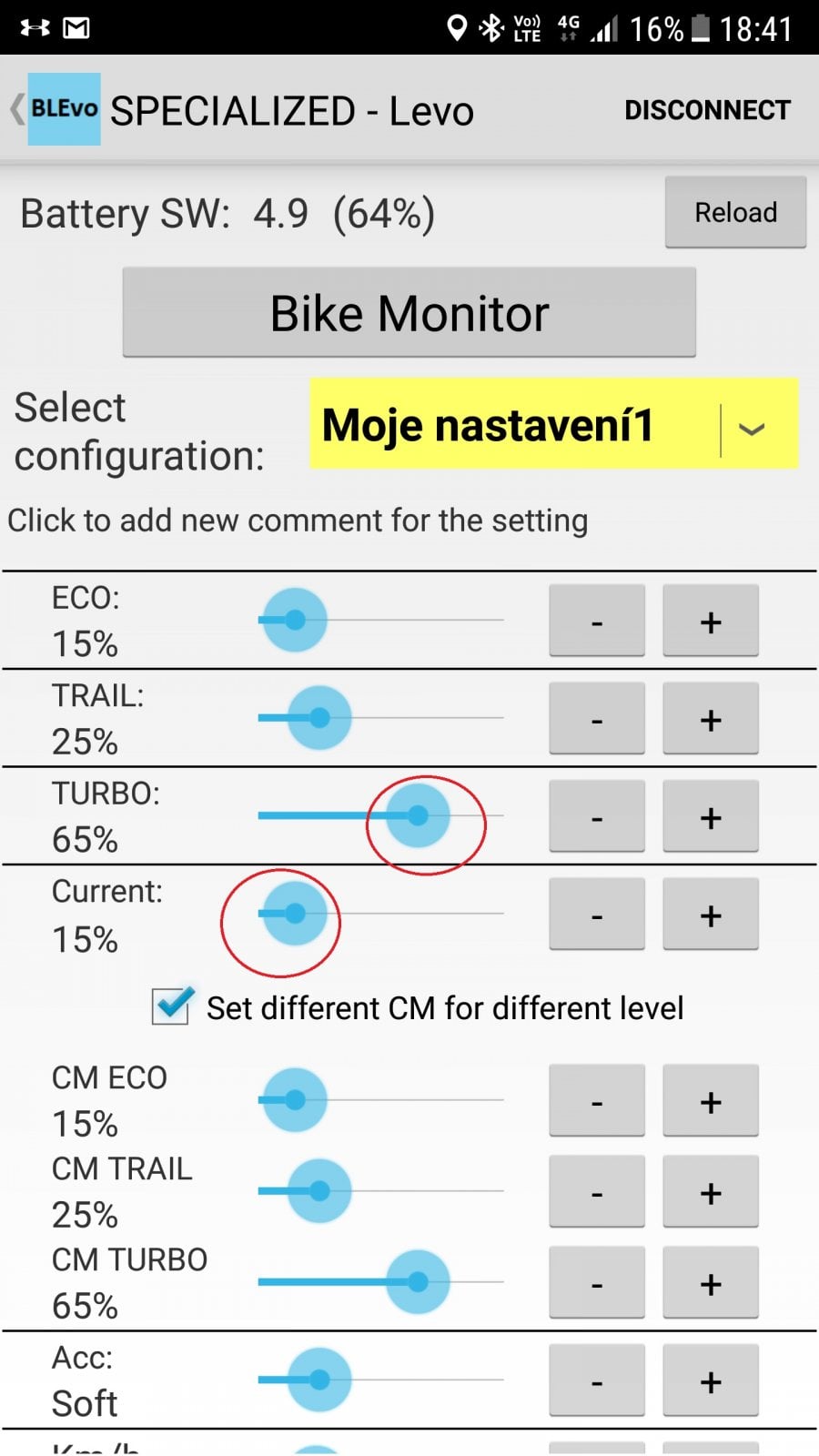

Hi, is it set correctly or is it the percentage that must be the highest in the Turbo profile? Sorry, but translated by Google. Or is it better to use preset profiles where performance is the same? Thanks
You have a very old firmware version..
Maybe it is better to update it to the latest one. 4.23.x
But I don't understand which is your issue.

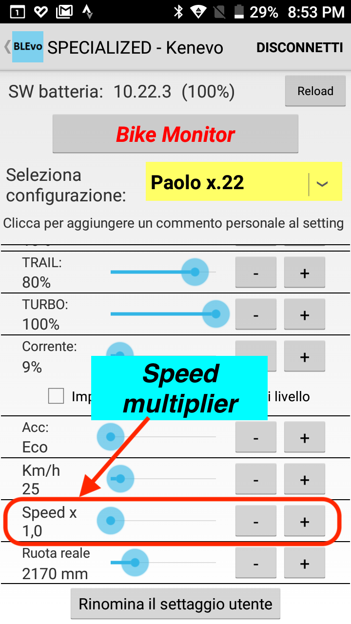

I have just released the version 3.5.1 of BLEvo for Android.
These are the news:
- Added the Speed Multiplier parameter to be able to use the bike sensor with a speed reduction system (see attached image)
- Now you can have the voice message every 30 minutes
- Added filter for barometer altitude values
- Optimized slope calculation
- Improved battery consumption on map display
- Now the AM / PM time is displayed if set in the system
- Added configuration parameter to automatically calibrate the barometer with GPS when stopped
- The minimum HR legs power lowered from 60% to 10%
- Now the GPS distance takes into account the slope
- Now if there is no Strava authorization, the button is enabled and executes the Strava authorization request
- Bugfix: barometer calibration at startup
- Bugfix: GPX import with single line point
- Bugfix: storage of zoom level
