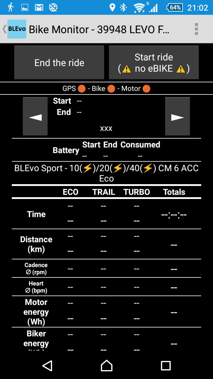

I just installed Blevo on my old iPhone 5S, connected to my bike and HR monitor like a dream. No disconnects or anything. I will most likely return my BV6000 phone (firmware updated bricked it) and use this iPhone 5s instead in a Lifeproof case.
However, I can't get strava authorisation to work. I press "Add authorization" in Blevo, it takes me to the strava.com site where I press "Authorize", that opens Blevo again but no luck.
Do you Strava App installed on the phone?

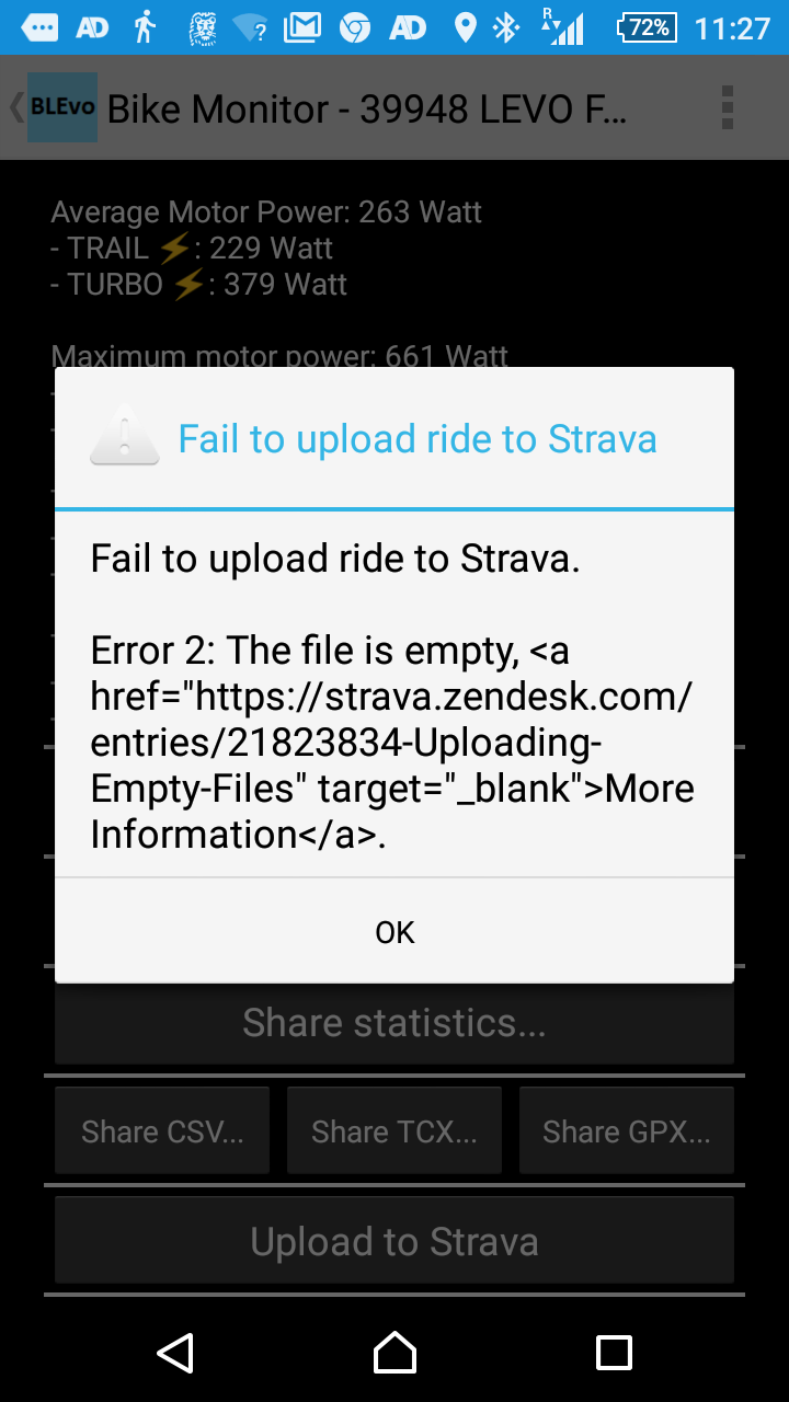

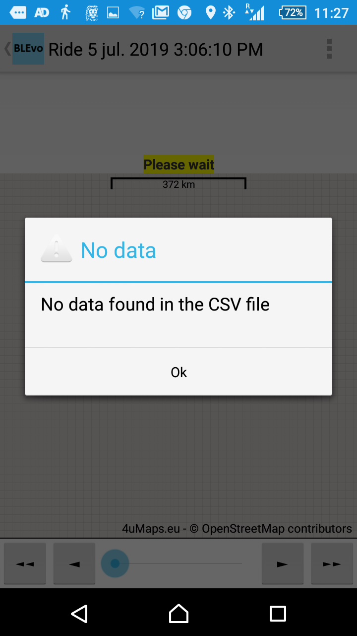

Please somewone help me. I have a problem loading up to Strava also I cannot open the map of my ride. It did work but now it does not anymore. I put some pictures with this mail. I tryed to salve it myself but I cannot find the solution.
Strava error message always comes up on my phone when I finish a ride. First, just make sure you have a good wifi connection. Then open the BLevo app > Bike Monitor > go all the way to the bottom. Click on "Load to Strava" and that should load to Strava. If that's not working (hmmmm), sorry I can't help you. It sounds like it might be a connection issue?

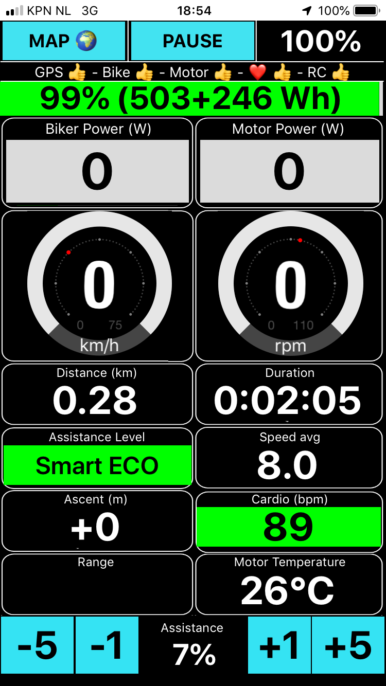

Thx @PaoloBLEvo for Your app (y)
Just did 424 km Transalp and managing the usage of power where essential.
With Blevo I could manage the assistance on the go right down to +/- 1%.
With this I always only used the minimal power on the rides.
It worked perfectly :cool:
Also loved that I could follow the watts on both the oem battery and my @TrailwattsUK
Even with 128 km a day the bike never ran out of power.

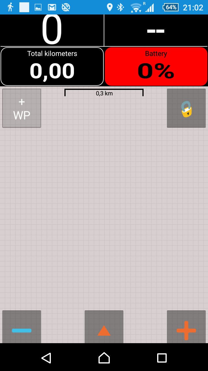

It does not work. But is it normal that when you start a ride, with ebike or not with ebike, you see nothing on the map. I mean when I start a ride and then scroll down to the map there is nothing to see. Look at the picture. I think there mast be a map
Groene005
May 3, 2019
36
13
Holland
Maastricht
Oct 3, 2018
646
655
M
Which map did you select? If you have choosen the openandromwps, did you also downloaded the maps and added them to your phone? You only need to do this once. After the maps will be available offline too. Please check the BLEvo manual.
It seems that BLEvo doesn't have the permission to write on the phone.. please check the permission on Android settings..
I think you need to have the gps connection and data connection if you didn't download the map before..
Could you share some short statistics of the rides?
Frank_Denmark
Dec 17, 2018
312
531
Denmark

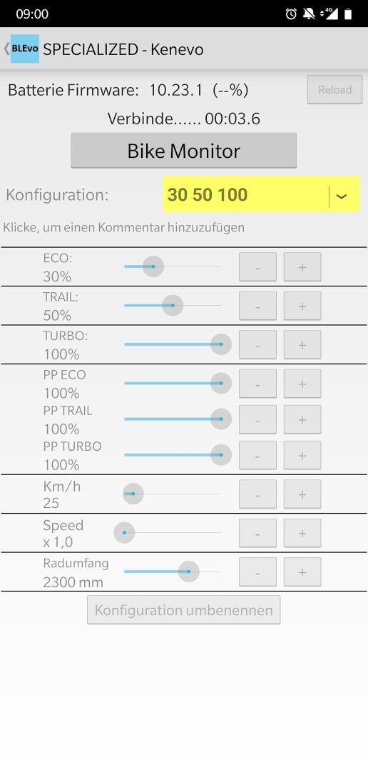

What setting do you use for a trip like this?
Respect :p
The difficult part is to secure that You don't run out of power.
I did 2 things. Firstly I got an additional battery like @TrailwattsUK
Secondly I tried to use as little assistance as possible.
Starting out at 20% eco, 35% trail and 75% Turbo
I was using the eco all the time on the flats.
And also up the climbs with 8-15% raise. When above that I increase the assistance in eco to 25-32%.
Only used trail og turbo when I was total exhausted, as the power was drained very quickly.
I did the ride with 11 experienced riders on analog MTBs, and my target was to have the same pace.
Finaly I think I have found wat courses the problem. The GPS of my phone is not working well. I do not know yet if it is my phone or the place where I am now. The phone of my wife has also troubles with GPS, but my GARMIN works well. I do not expact it is the place I am now in Australië. Next week I am back in Holland.
