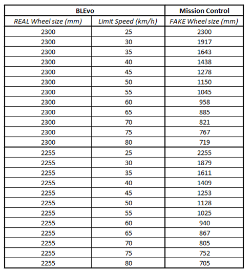

I have found the table below which was shared before. I believe based on your findings of previous post, BLEvo's speed limit setting is just programmed for European market.
You will see as you wrote in your last post:
"Setting the slider to 25 km/h (the default value) causes my U.S. bike to limit the maximum assistance speed to 20 mph, and the wheel size displayed in Specialized Mission Control is 2255. Setting the slider to 40 km/h causes my bike to limit the speed to 32 mph and the wheel size displayed in Specialized Mission Control is 1409."
When the original wheel circumference setting of 2255 (which is linked to the European speed limit of 25km/h) is stored via BLEvo into the motor it results based on the US bike firmware in a speed limit of 20mph.
So from my perspective when you would like to reset the wheel circumference, as US owner, to the original value of 2255 in the motor and MC you should select a European speed limit of 25km/h in BLEvo.
Yes, I've tested this and it seems correct.
It should be possible to create a similar table for the U.S. I will work on this and report back.

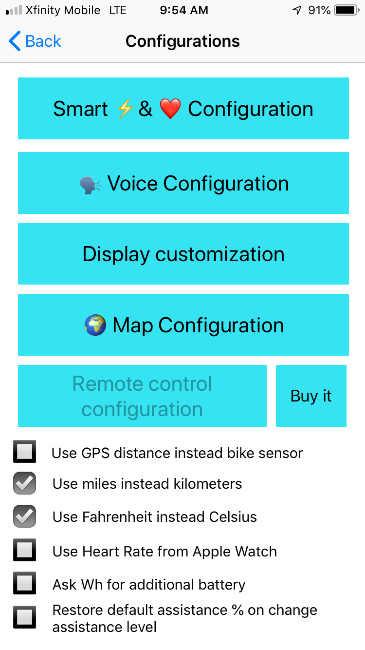

Using blevo in the USA , what are people running
For speed ? Are people really getting there levo motors to assist up to 50 mph?
My 2018 Turbo Levo tops out around 30 if I'm pedaling really fast. I'm setting the speed limit to 50 km/h (40 mph) just so the limiter never comes close to getting in the way.
Some people have swapped out their front chainrings to provide a taller gear ratio and a correspondingly higher top speed.

“Restore default assistance...”
What does this do? It’s not mentioned in the manual.
I also checked the Android version and Android manual. I did find the setting in the Android version too but also I couldn't find the exact explanation in the manual. The setting is activated within my settings.
If I remember well I think this feature is added after a question of a rider some while ago. However I am not 100% sure. I think to remember that this setting is added to restore the default setting after ending a ride with smart power. If the assistance was changed due to smart power it then restores the default support setting within the bike when ending the ride.
Maybe you can check if it works in this way or wait until Paolo is back again.
