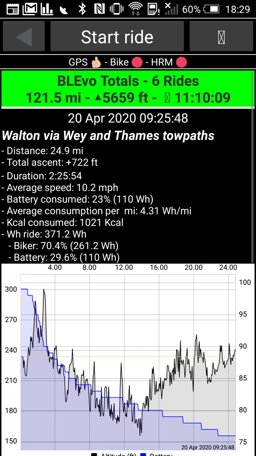

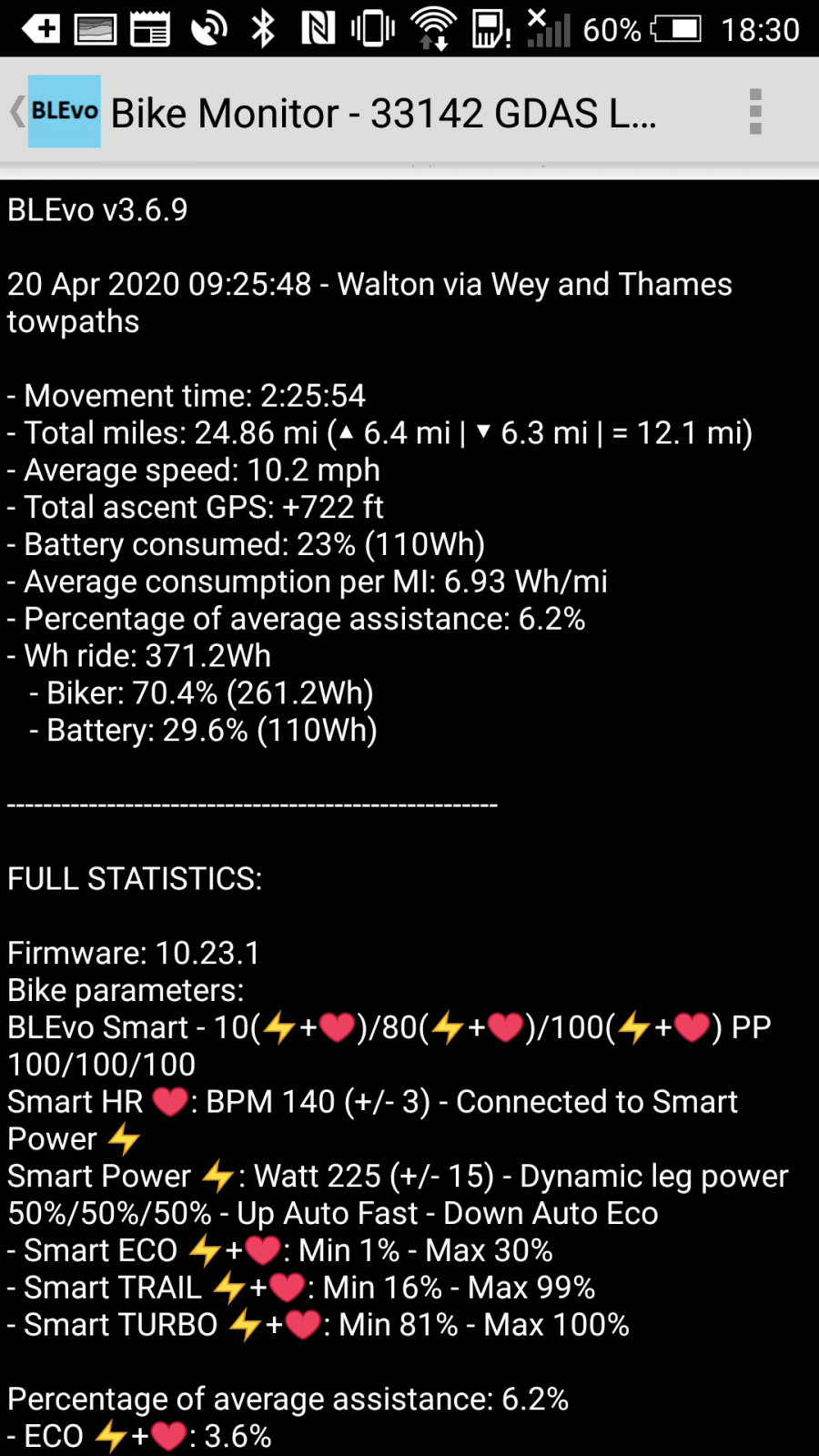

I've been doing some rides on my Levo with SmartPower&HR and enjoying seeing how economical it can be with the battery. However, I have a question about average consumption per mile.
On today's ride I did 24.86 miles consuming 110Wh of battery, 110/24.86 = 4.42 Wh/mile
The screenshot below, which I get to see by choosing 'more details', shows 6.93 Wh/mile.
The screenshot below that, which is the overview one for the ride, shows 4.31 Wh/mile which is much closer to my calculation.
Can you explain why the figures on these two screenshots are different.
Many thanks
The Wh/km is calculated in function of the parameter "Calculate the autonomy including the descent data". This is because when the motor is not consuming (e.g. during the descent), in my opinion the km should not be considered.. So with this option you can select the different calculation mode..

I've noticed a number of what seem to be inconsistencies in values displayed. In your case, if you do the conversion you'll find that 6.93 is 1.61 x 4.31, where 1.61 is the number of kilometers in a mile. IOW, there's a mistake in the app where the miles to km conversion is not being done. I'm not sure this is happening in other places.
You are right.. there is a bug in the tour list.. thanks.. I will fix in the next release..

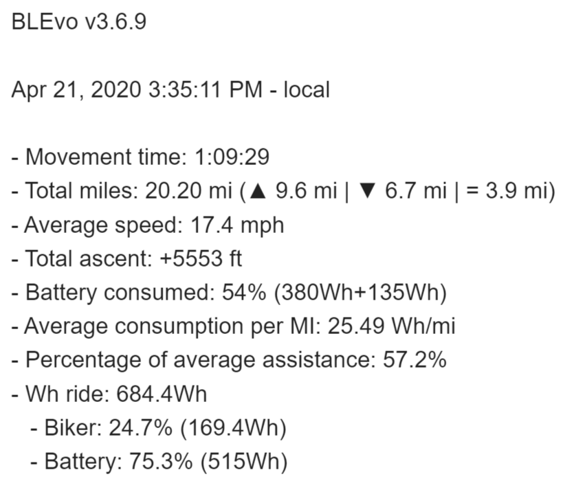

I am guessing this was already asked in this thread but I was not able to find it. I have been using BLevo for over a year on my 2019 Turbo Levo Expert and the Ascent value has always been mostly accurate compared to another Garmin I use at the same time.
Just in the last week, the value has increased to almost double what it should be. Everything else is matching up with my Garmin app accept for the ascent value.
Just got off a ride and my Garmin shows the ascent value at 2985 feet and the BLevo app is showing 5553 feet.
Any ideas, has anyone experienced the over calculated value?
Thank you for any help in advance.
I think the phone has the barometer, am I right?

@MTBGUY65 - sorry, can't answer your question, but I'm curious as to why your 515wh battery usage is split into two: 380 + 135. Do you have two battery sources?
If you have a battery extender, you can configure BLEvo to calculate the use of the 2 batteries
