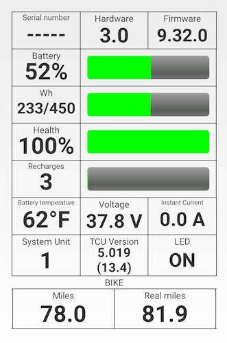

Hey @PaoloBLEvo . Did you ever check on why the app doesn't recognize my 504Wh battery and identifies as 450Wh? I suspect it has something to do with the blank Serial Number field? Thanks for looking into this. Let me know if there is any info that I can give you. I'm using Android 10 on a Pixel 3a.

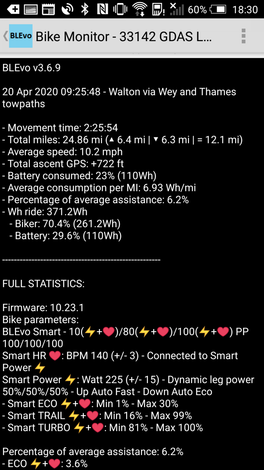

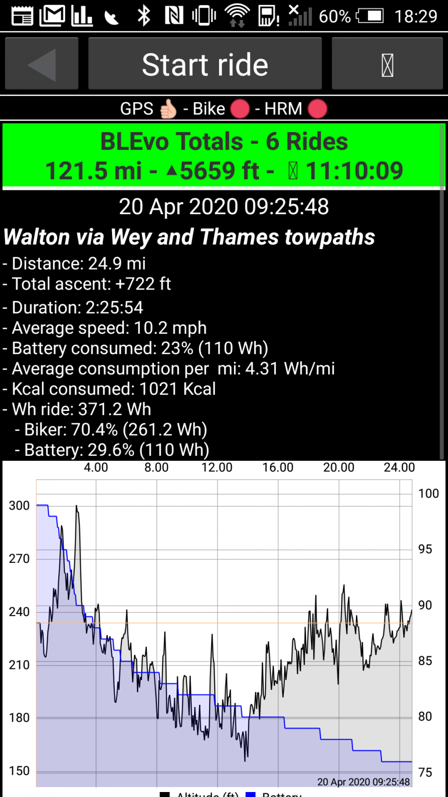

Hi @PaoloBLEvo
I've been doing some rides on my Levo with SmartPower&HR and enjoying seeing how economical it can be with the battery. However, I have a question about average consumption per mile.
On today's ride I did 24.86 miles consuming 110Wh of battery, 110/24.86 = 4.42 Wh/mile
The screenshot below, which I get to see by choosing 'more details', shows 6.93 Wh/mile.
The screenshot below that, which is the overview one for the ride, shows 4.31 Wh/mile which is much closer to my calculation.
Can you explain why the figures on these two screenshots are different.
Many thanks
rochrunner
Mar 30, 2020
16
9
Rochester Hills, MI, USA
Hi @PaoloBLEvo
Many thanks
I've noticed a number of what seem to be inconsistencies in values displayed. In your case, if you do the conversion you'll find that 6.93 is 1.61 x 4.31, where 1.61 is the number of kilometers in a mile. IOW, there's a mistake in the app where the miles to km conversion is not being done. I'm not sure this is happening in other places.
