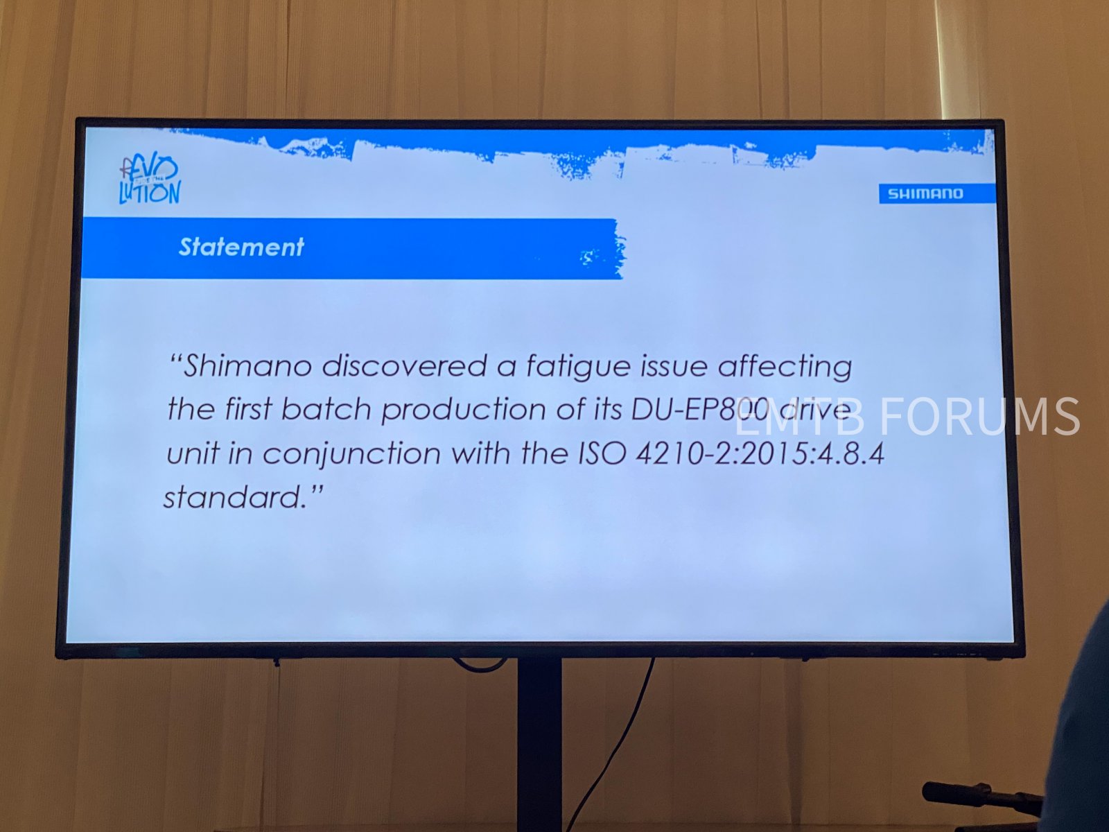

Rob Rides EMTB
Administrator
Staff member
Jan 14, 2018
6,290
13,837
Surrey, UK
Official statement from Shimano on motor delay:
