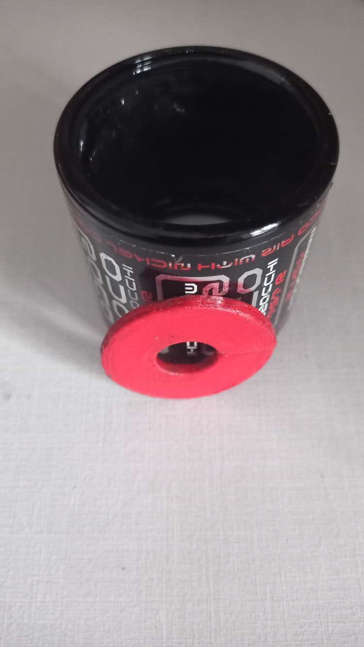

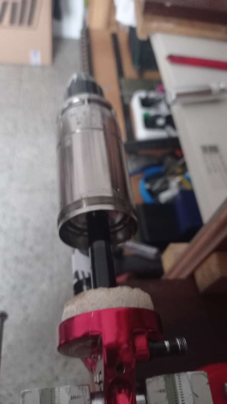

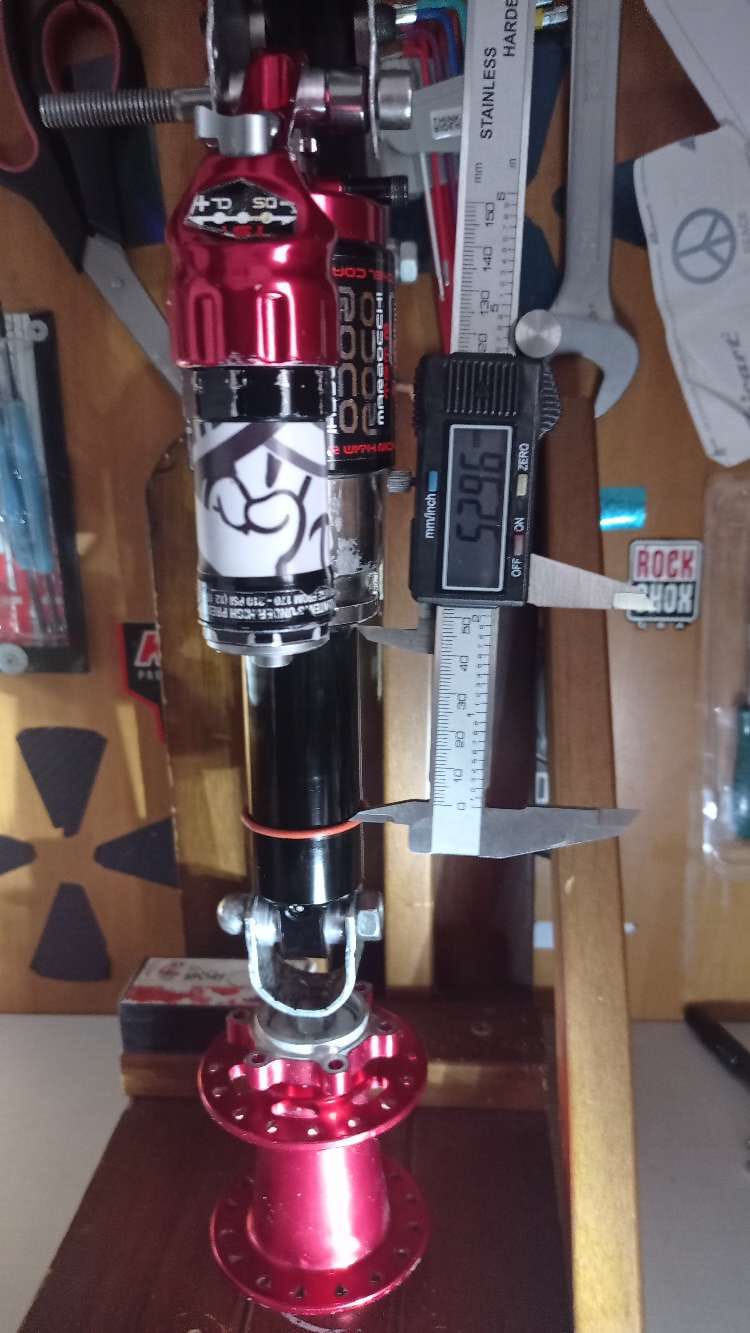

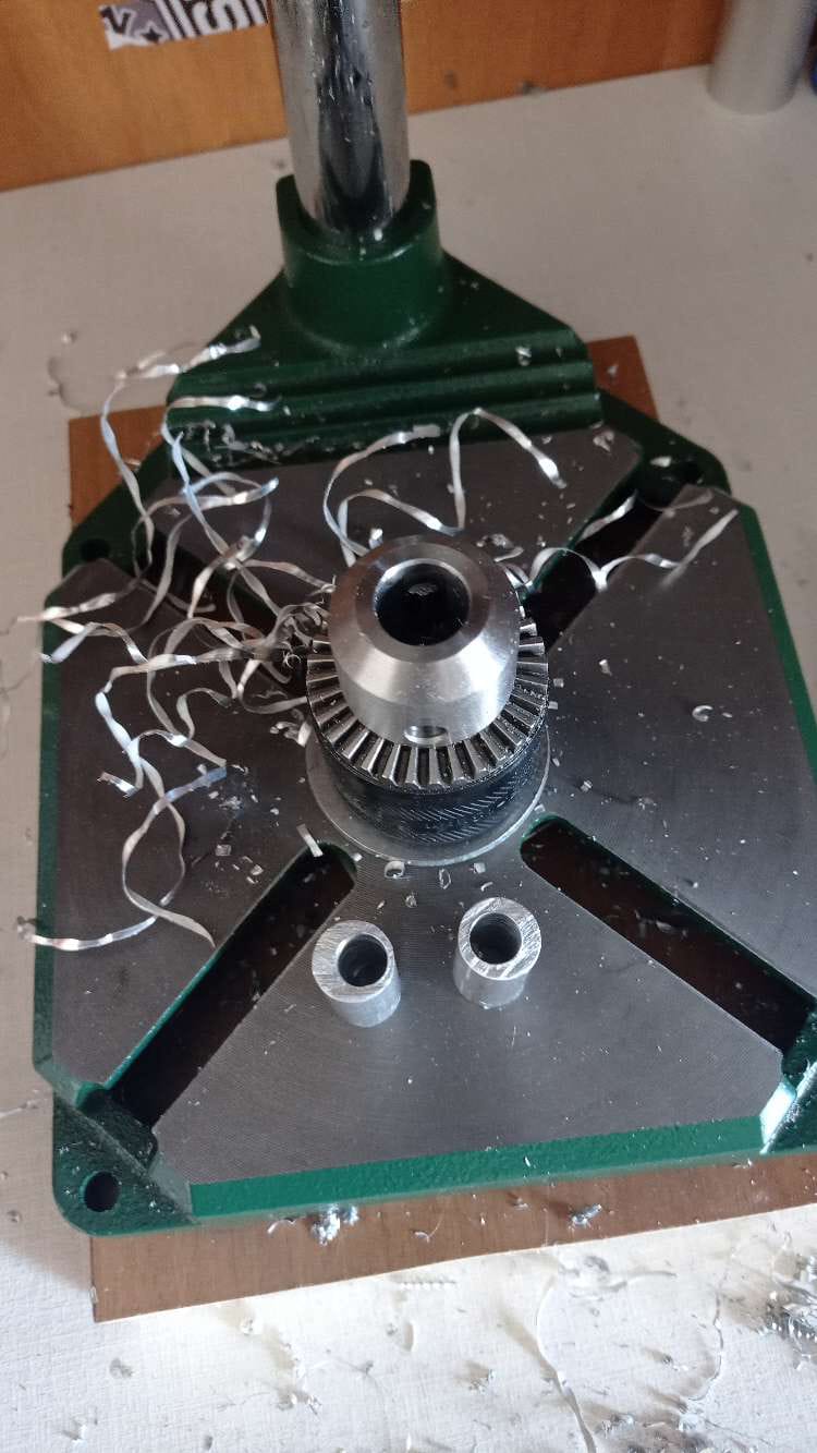

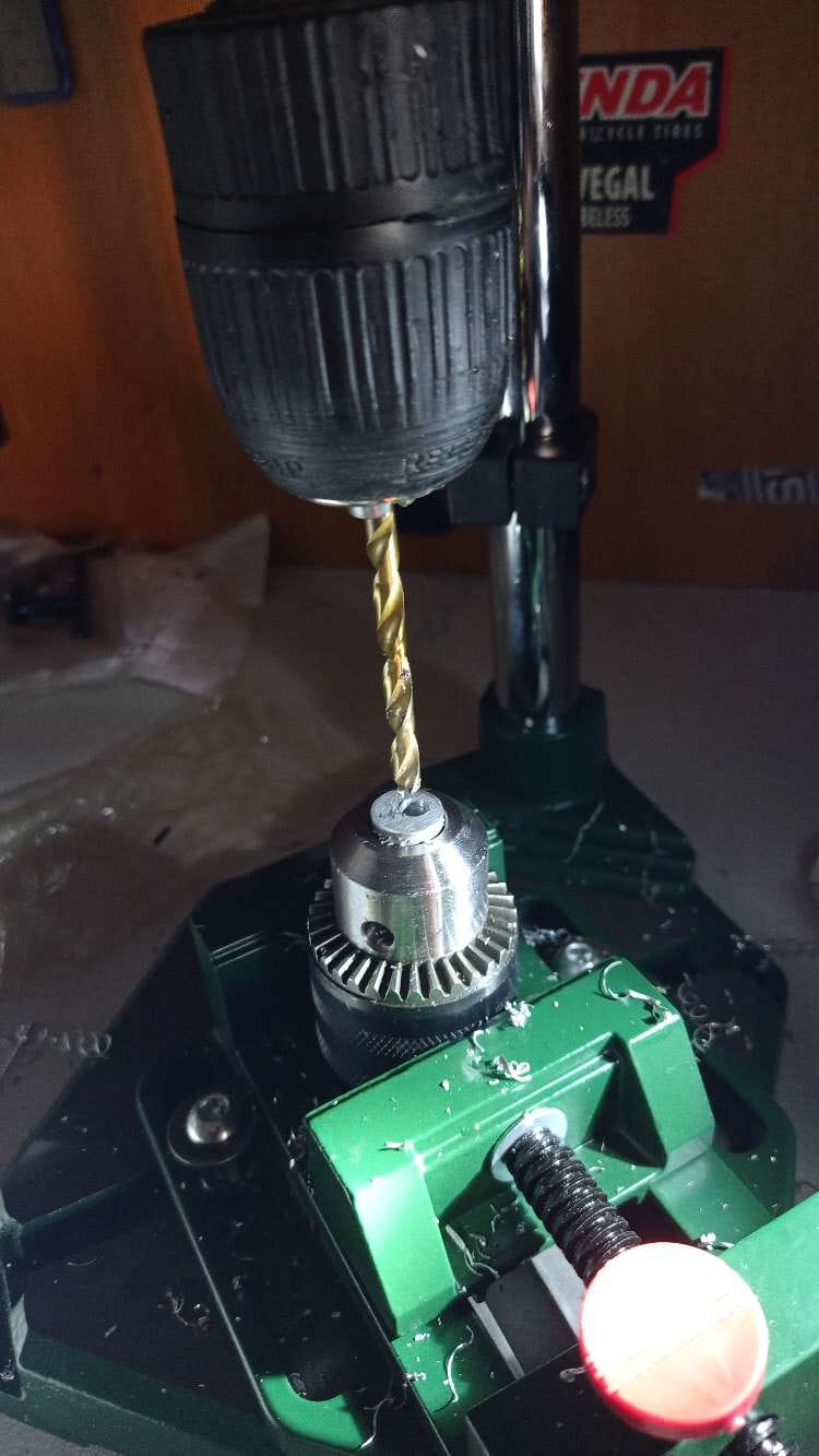

HELLO Guy
the frame kit etc.should arrive next week I hope.

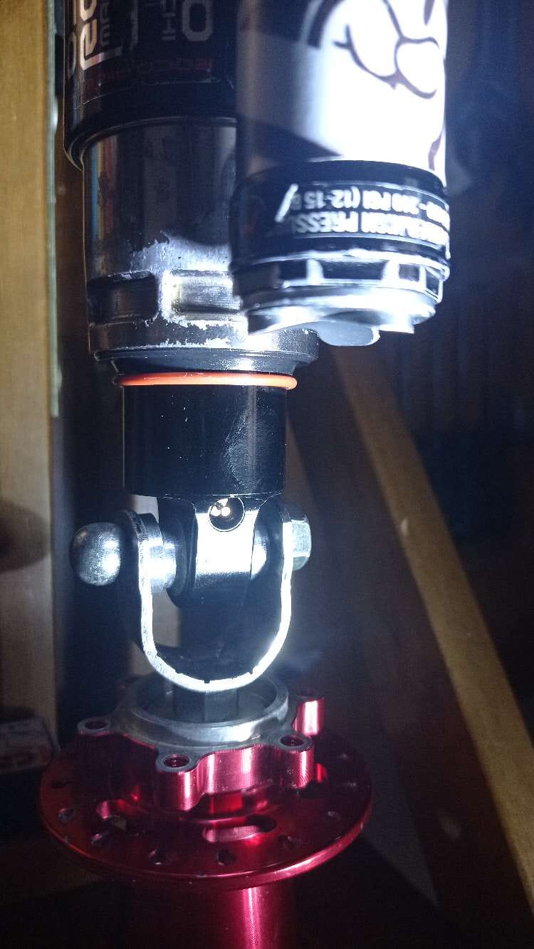

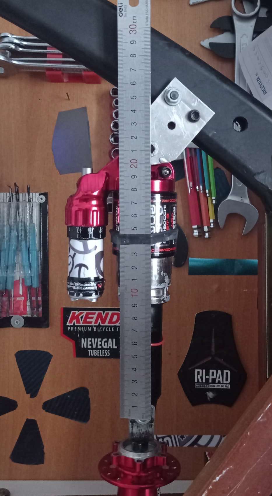

I modified a 216x63 shock absorber
it now measures 212\213mm
offset bushings, travel reducer, bringing it to 53 mm.
I will carry out tests by increasing the travel.
Some photos of the work.
I accept suggestions and criticisms, let me know your point of view.

TommyR
Sep 19, 2024
45
40
Denton, TX, USA
HELLO Guy
It sounds like you should be fine. It appears a p nothing of greater than 210mm will force interference between the chain stay and frame so you’re fine there. And your 53mm of travel should clear from all I’ve read. I’m targeting similar stroke of 52.5mm. 😊

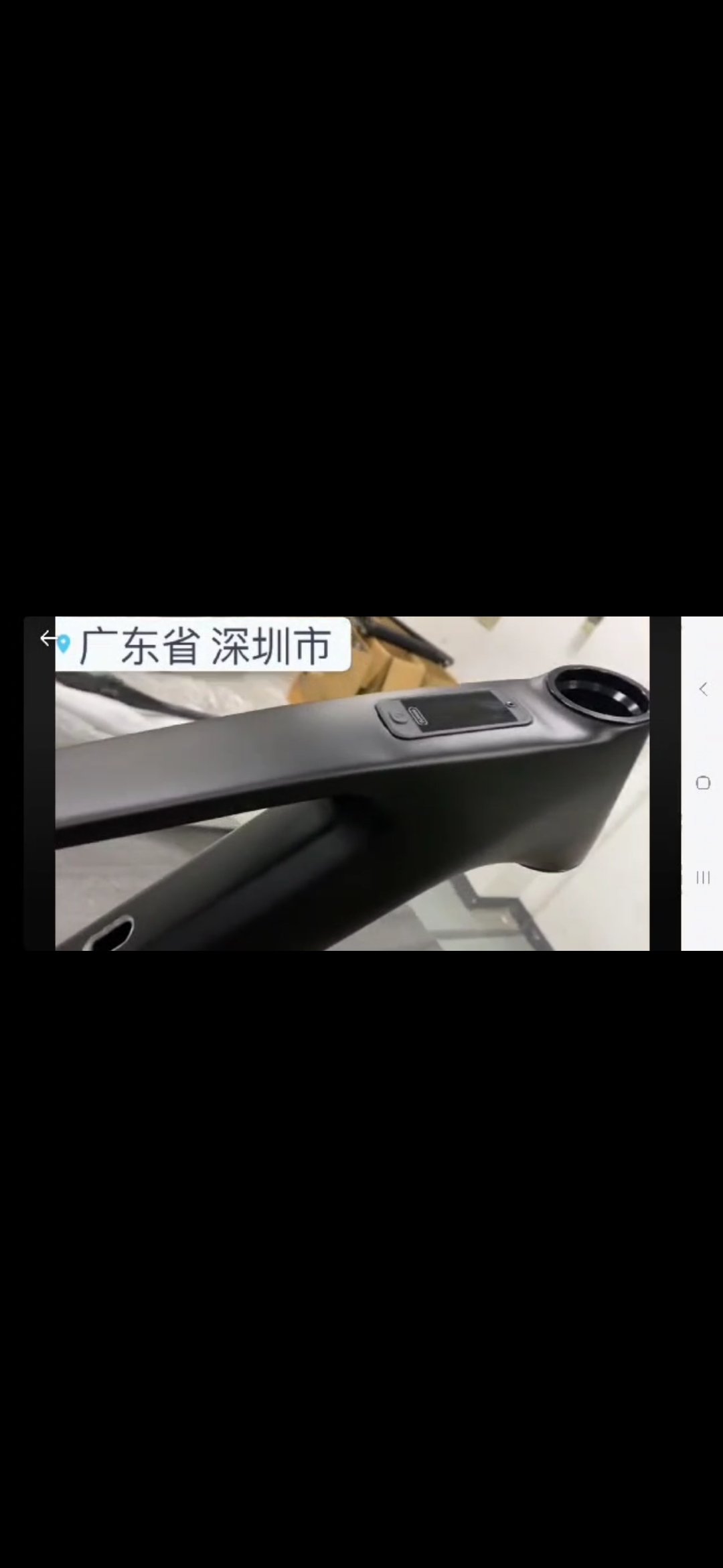

blazo
May 22, 2024
Poland
Hello, I just received my CEF50 set (size L) from Linda, I was waiting for it 3 months to receive, meanwhile I tested bike in same reach size, and i think it will be too big for me so I changed plans. I am offering my set for sale. Everything is packed as supplier sent me.
Frame is 100% new and in perfect order, never assembled, it is professionally packaged from supplier. I can ship it immediately in Europe (no 3-month wait!). I am based in Poland.
What's included: (every part is listed in the last photo)
  • CEF50 frame (Size L)
  • Bafang M820 motor (right now 48v firmware, can be changed with BESST tool from bafang)
  • Display DP C245.CAN(3.0)
  • Crankset (165mm)
  • Chainring 32T
  • Speed sensor
  • All necessary cables and accessories
I can sell it for 1500 EUR
If you are interested and have any questions please send a message :)
Photos here Photo Album
