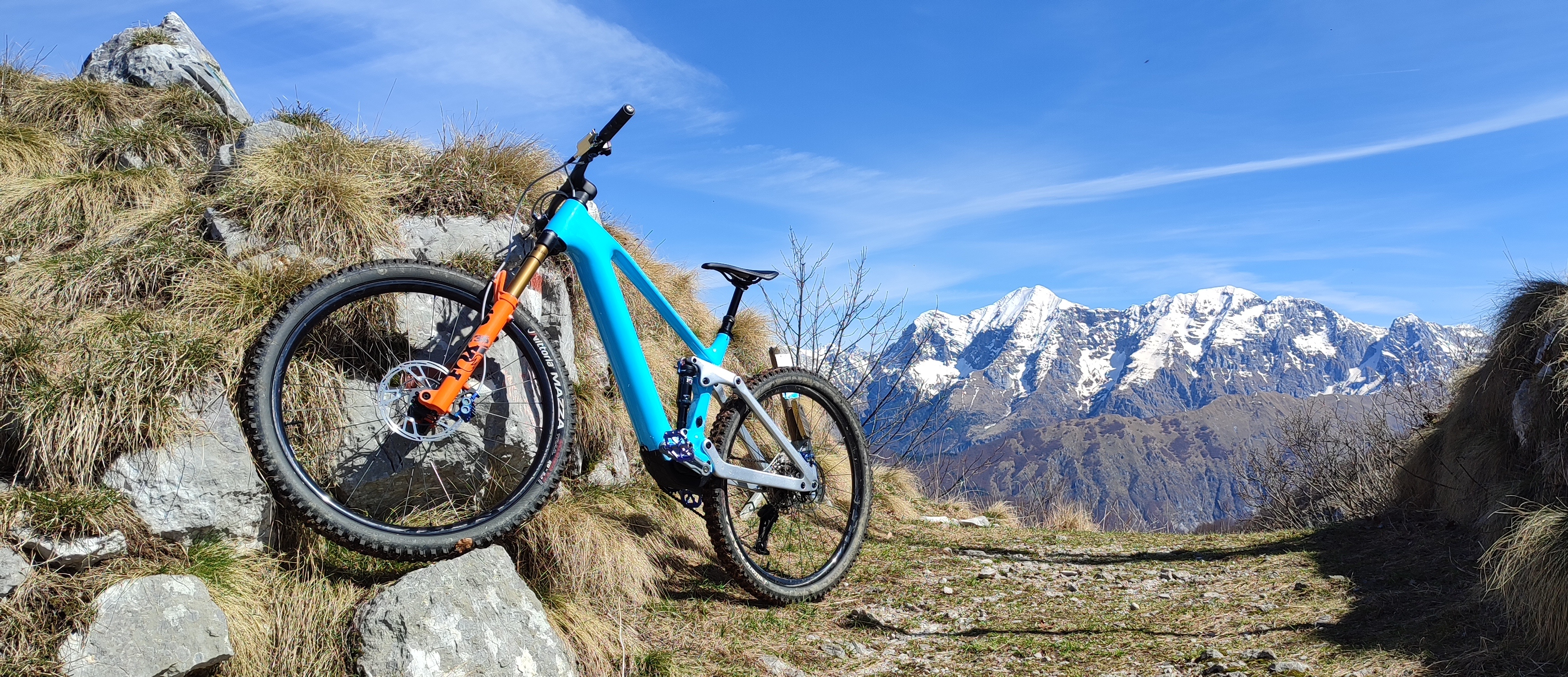

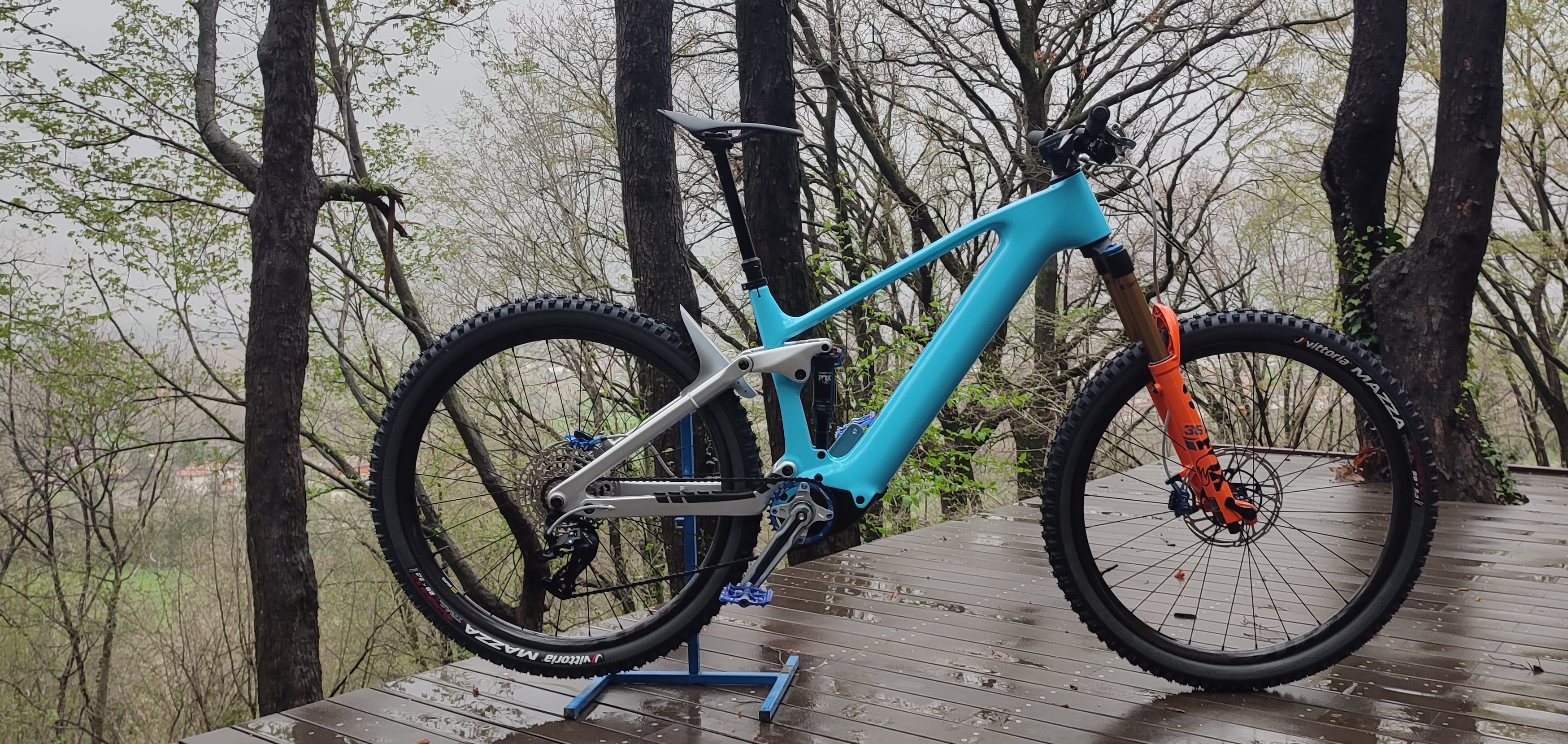

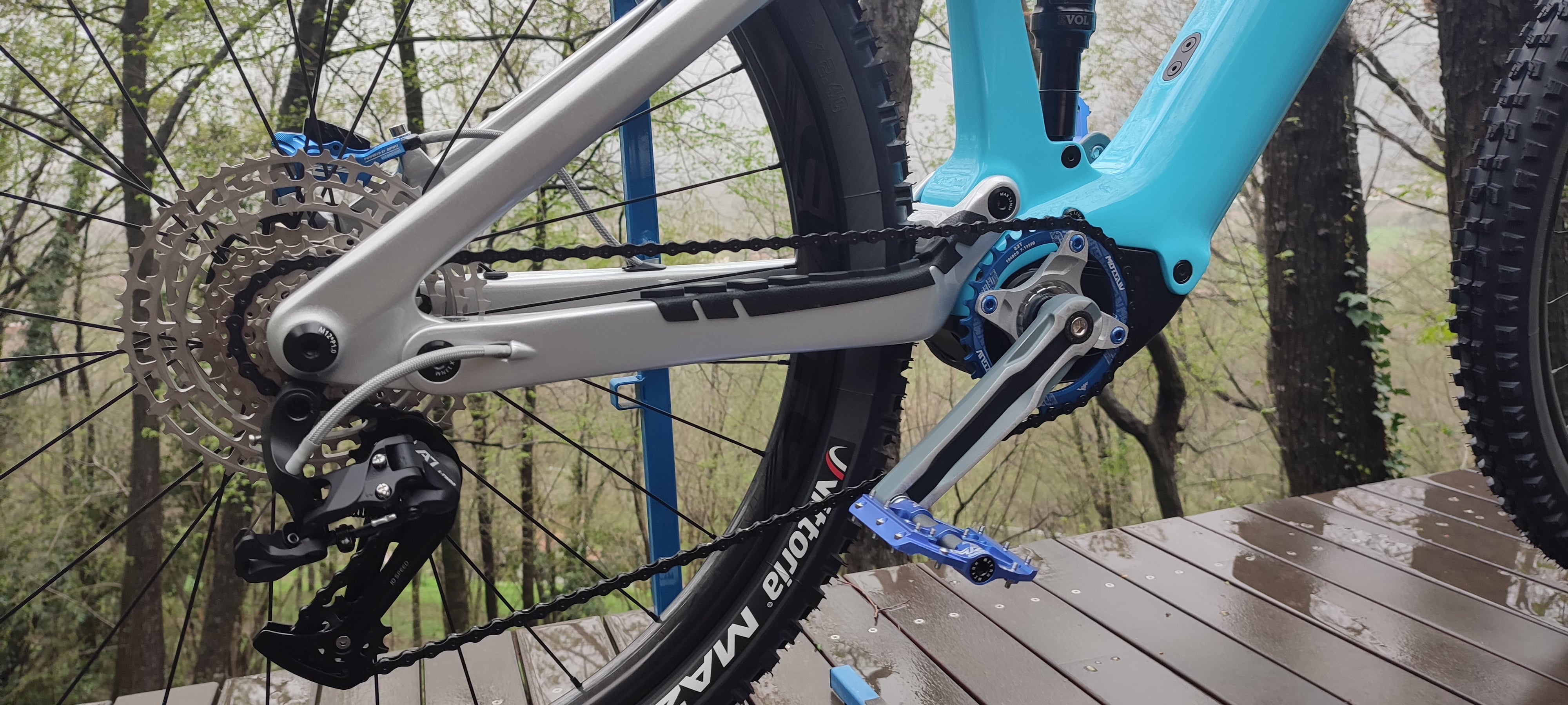

Good morning everyone, I'm writing from the north east of Italy.
First I want to thank you for inspiring me in the creation of this beautiful bike, this is not the first build, as I already have experience with the Dengfu E09 and E10 frames.
I present to you with great pleasure the final result:
The weight of the bike is 18.3 kg with 480wh 48v battery
Daniele.

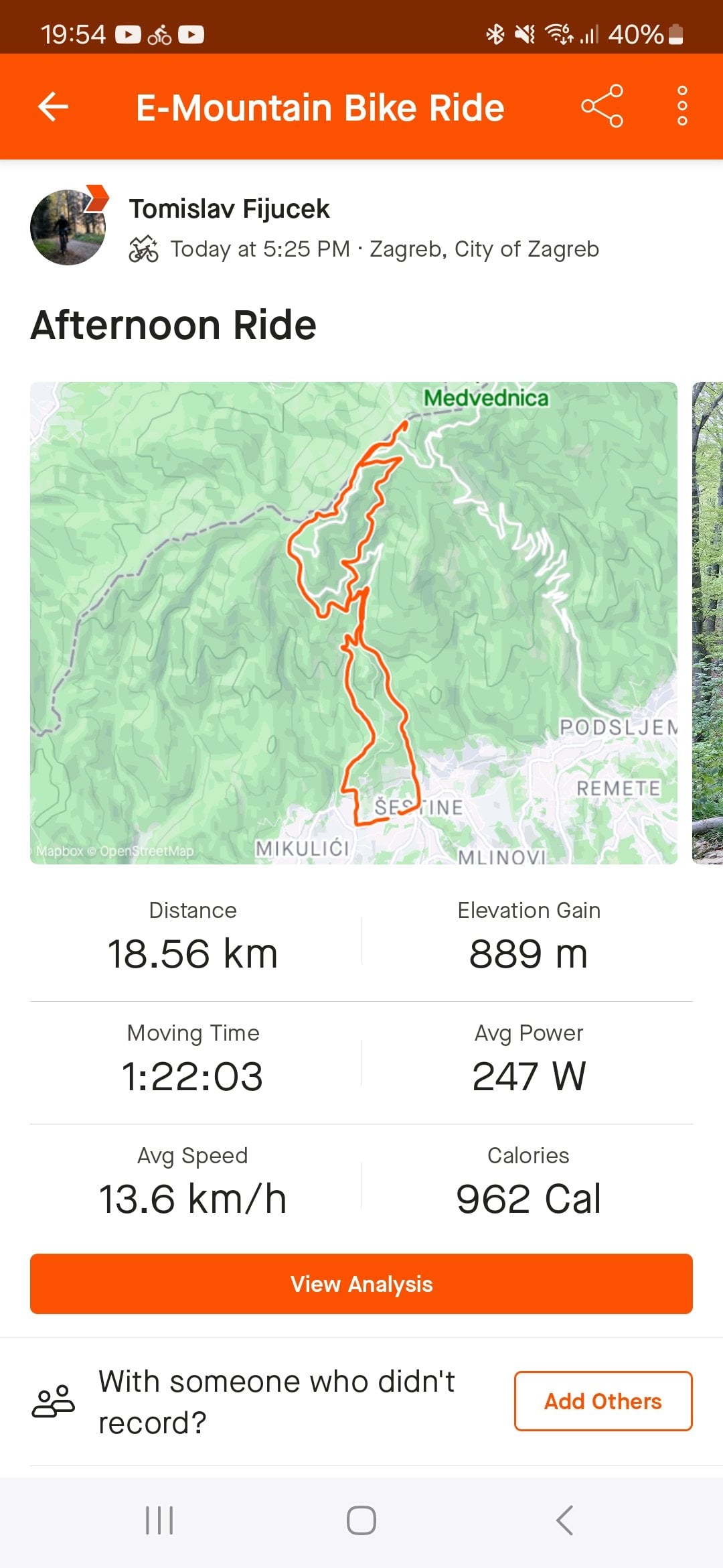

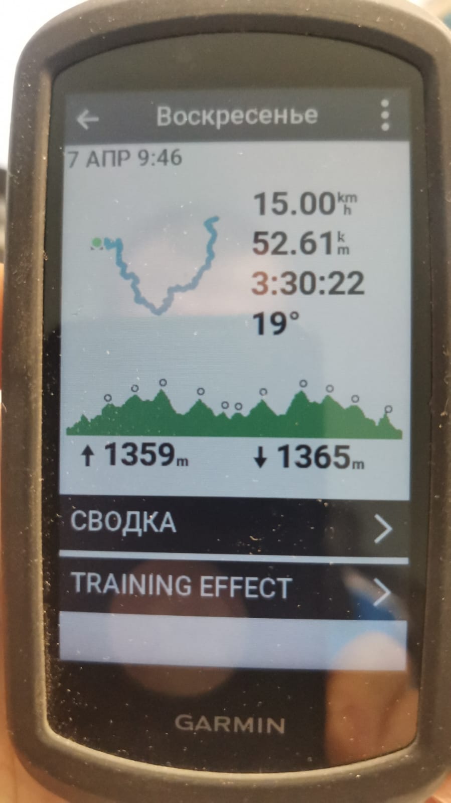

today was the first ride. the bike is great, the engine is amazing. I think the m820 is the best Bafang motor. enough power, minimal battery consumption.
I rode mostly T and S, S+ and for the test B a few meters on the climb. enough power on the climbs, only in B mode did the E09 drop out, maybe the firmware would solve that.
the engine has very good power modulation, it is not as smooth as Brose, Giant, Bosch, but it is excellent.
since I have an 11s 3p 17.5ah battery, on the first ride I had 100% left. means that the voltage did not drop below 42v during the 900-meter ascent (full battery before driving at 46.2v)

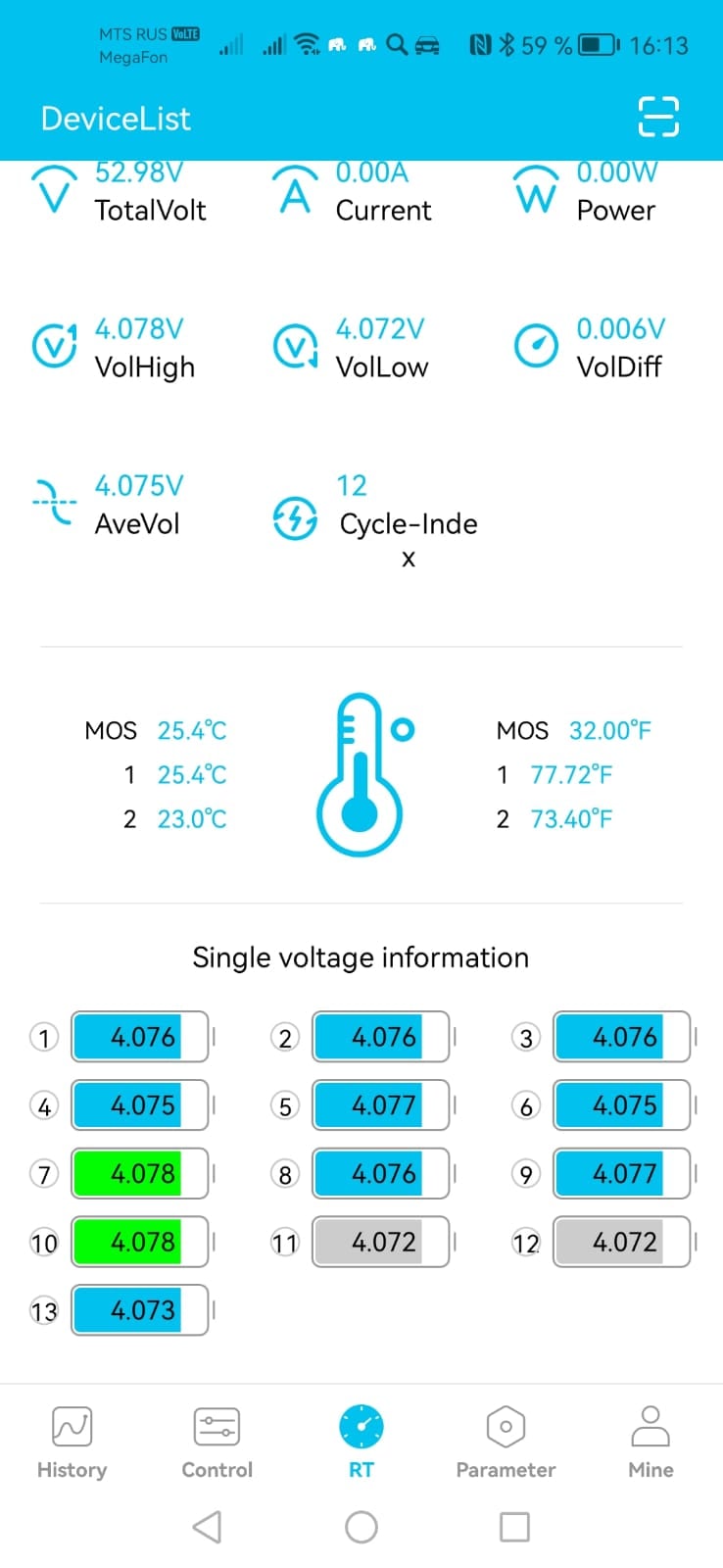

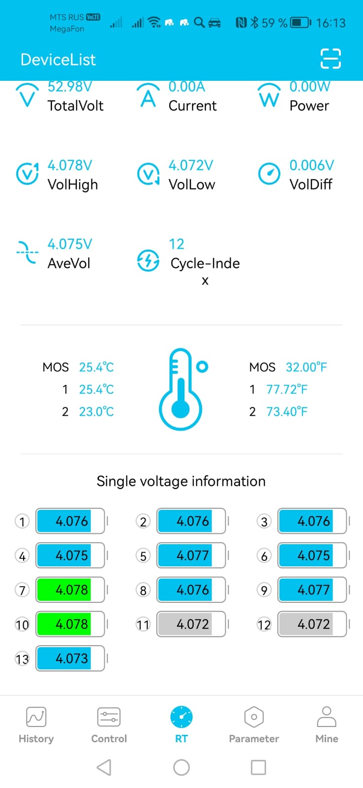

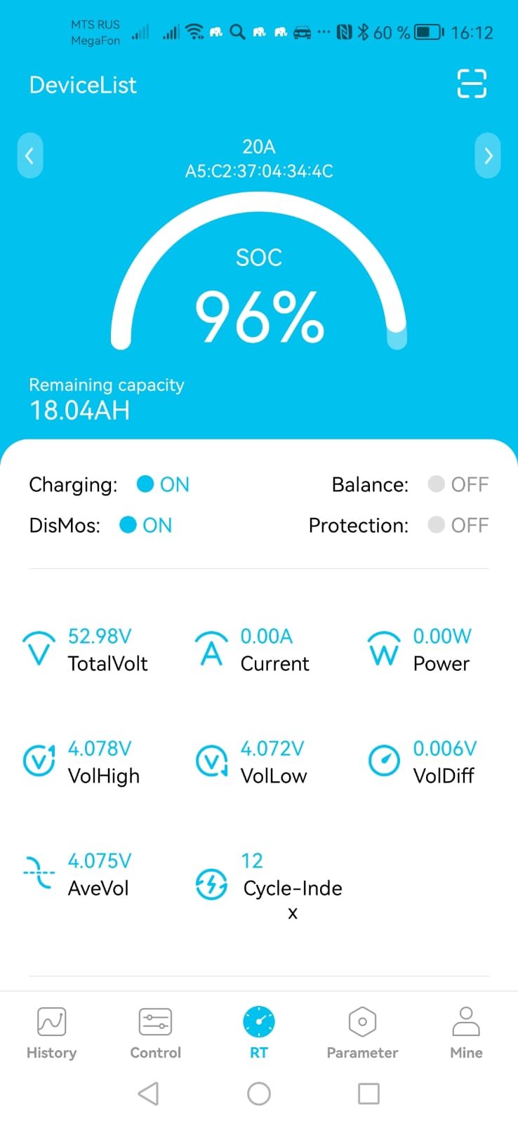

Ride on firmware 43V - CRX30PC4313E102001 3_eMTB_230317, battery 48V 20A (21700 4700ma = 18.8A). There were no mistakes. The motor is in Boost mode 40 degrees. The M510 couldn't overtake me on a steep climb

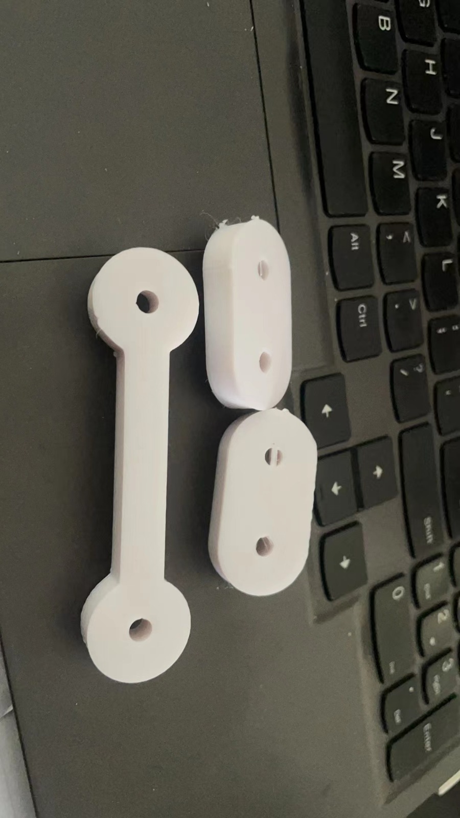

Anyone here try 3D printed the motor cover with ABS or Nylon Carbon. Curious if it last.
Have a 3rd party make a carbon or aluminum custom one....then do a group buy to save money once they have the dimensions. 👇 Here's one in the UK.
calvintys
Sep 12, 2023
270
264
Malaysia
We need some materials which is safer then carbon else our frame screw or nut area will break
