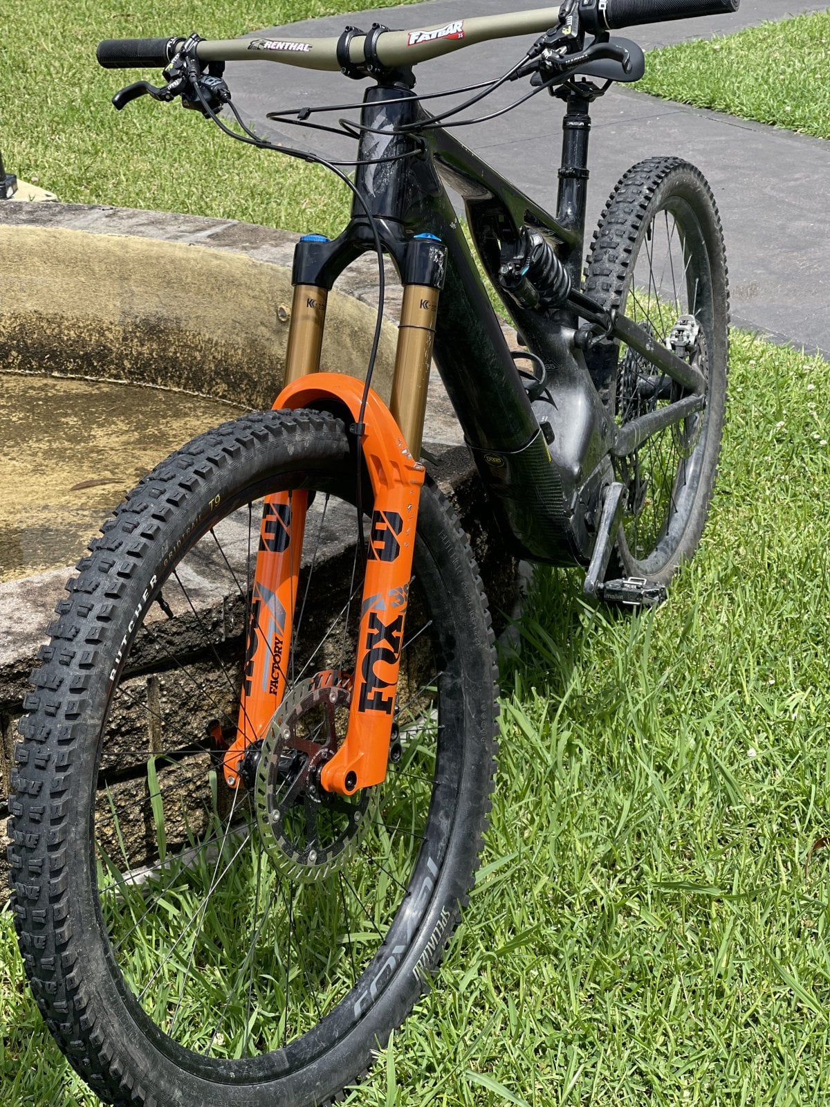

Has anyone put a 180mm fork on their Levo? I have a 180mm 38 lying around, considering putting it on.
So I did this today. Feels really good on a car park ride. Hopefully help the BB from hitting so much and smashing my battery door.

Very nice. Was gonna get EXT but I’m glad I went Push, just for the dual circuits. The EXT sounds like a nice shock also. Push gave me a discount, and EXT would not. I’m glad I went coil.
Did they get your spring rate correct? They seem to underspring the Levo somewhat.

Unfortunately it’s not 😢. I’ve repaired the stanchion somewhat, but it’ll need a new CSU with I can find one (this is why I had this fork as a spare!).
I cant find any CSU's. Cyclinic in Aus. had some but they are now sold out. Hows 180mm feel? at 170 mine feels like a lot of bike to sink into up front. Can be a nuisance unless its fast flowy trails
Jesus thats some battle scar isnt it
That a Rockshox coil too?
Yeah I called Cyclinic, they’re sold out as you said. I’ve cleaned it up, it will do until I can find a new CSU. That is a Rockshox coil, but when on the phone to Cyclinic I ended up getting a Push 11-6 for it. I’m surprised at the difference, it’s amazing, well worth it.
180mm is probably overkill, I’m guessing 170mm would be better. It makes the bike feel totally different, more like a DH bike. This suits me, as most of the trails I ride are pretty steep and technical. There’s no flow around where I live, but I agree it probably wouldn’t feel great. On very steep uphills, you need to work to keep the front end down. I tried to account for this by adding just one 5mm spacer under the stem. I had a decent stack yesterday causing the bars to turn 180 degrees. There wasn’t enough height, so my brake and dropper levers ended up scratching the top tube fairly badly. Something to be aware of if you’re going to try this.
For me, this experiment worked, and I’ll keep this setup.

Yeah the top tube thing is too late for me ha. Wasnt even a stack. Just sat there and the bars turned and the AXS shifter scratched the top tube
I am going back to 170mm and a Luftkappe shortly. 160 feels sprightly but I prefer the extra travel.

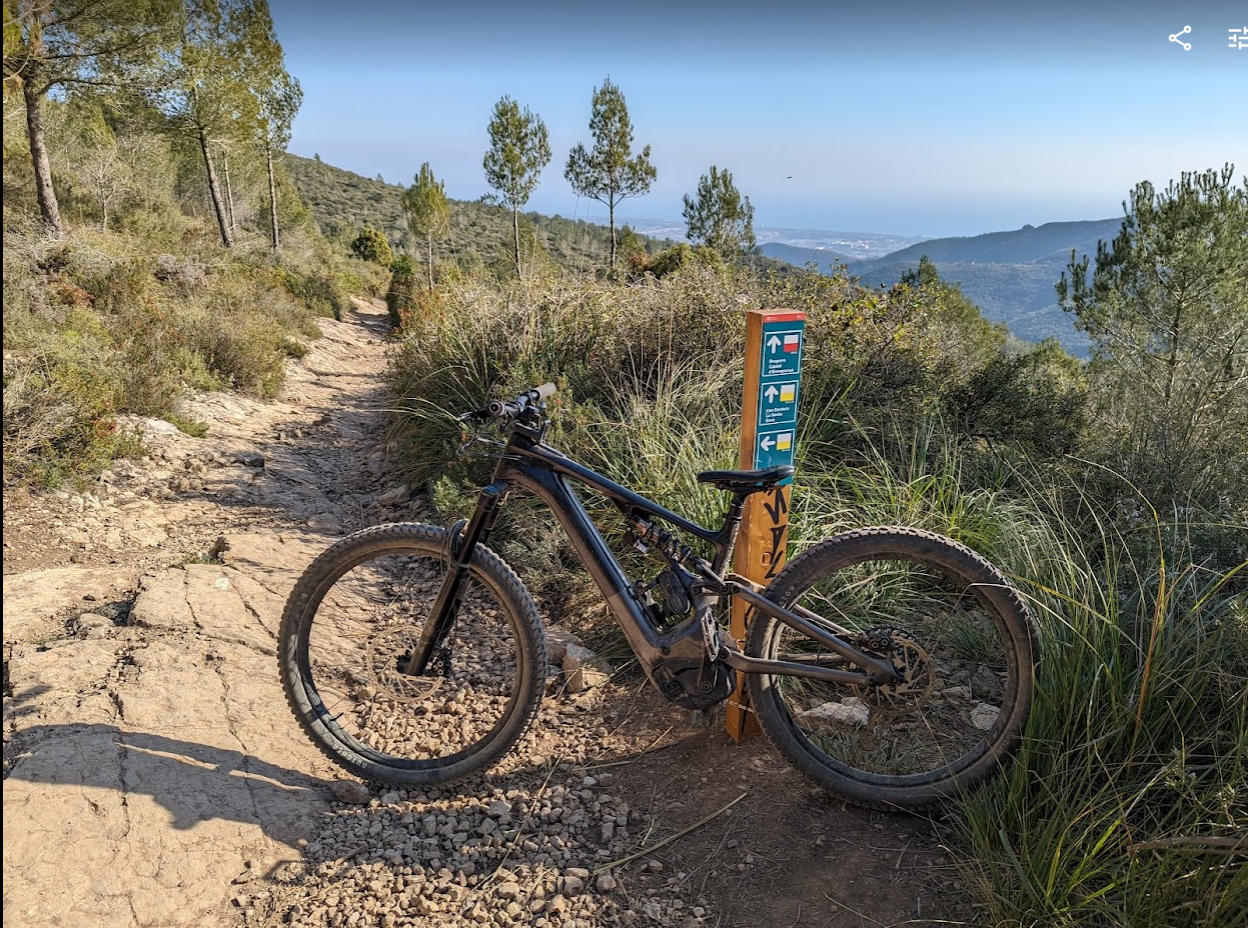

Hi Coil lovers,
After the long travel link from cascade is too long to wait for and expensive and the 160mm cascade kit increases the leverage ratio too high, I want do go another way and try a 160mm coil in the lev gen3. Perhaps anyone had similar ideas or any tips if this will function as i have it im my plans:
- The lev gen3 has nearly the same leverage progression than the 2020 Kenevo whick runs good with a TTX22M Coil. So for me there is no need to increase progression when using a coil.
- Öhlins TTX22 is my choice due to the good experience in my Kenevo Gen2 and the possibility of spherical bearings, the robustness and the moderate price.
- I want to use a 58-60mm stroke shock in the standard linkage. So I ordered an old inch-sized TTX22M in 222x70mm which is 1:1 identical to the 216x63mm except the mainshaft length. the positive thing is, that those inch-sized shocks have a higher stroke related to the length :) I would start with a stopper-plate with 10mm thickness on the reboundside of the shaft between the valvepiston and the sealhead. This will result in 212mm length and 60mm stroke.
The 2mm more shock length shall compensate the lower sag and the higher front with the 170mm fork.
I will give a feedback when this adventure gets reality :)
