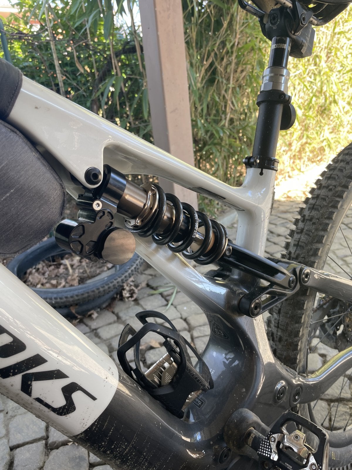

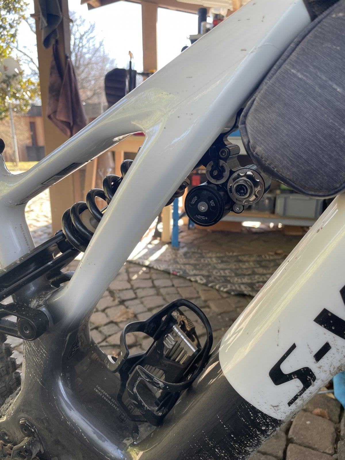

It's a thing of beauty 🤟 is the lever switch easy to access it looks like it's in a awkward place to access or maybe just the pic ??
Yes, not so obvious to find and move, my old ammo had the lever in the other side.
But i need to try and tell you. The lever had free space to move without any issue

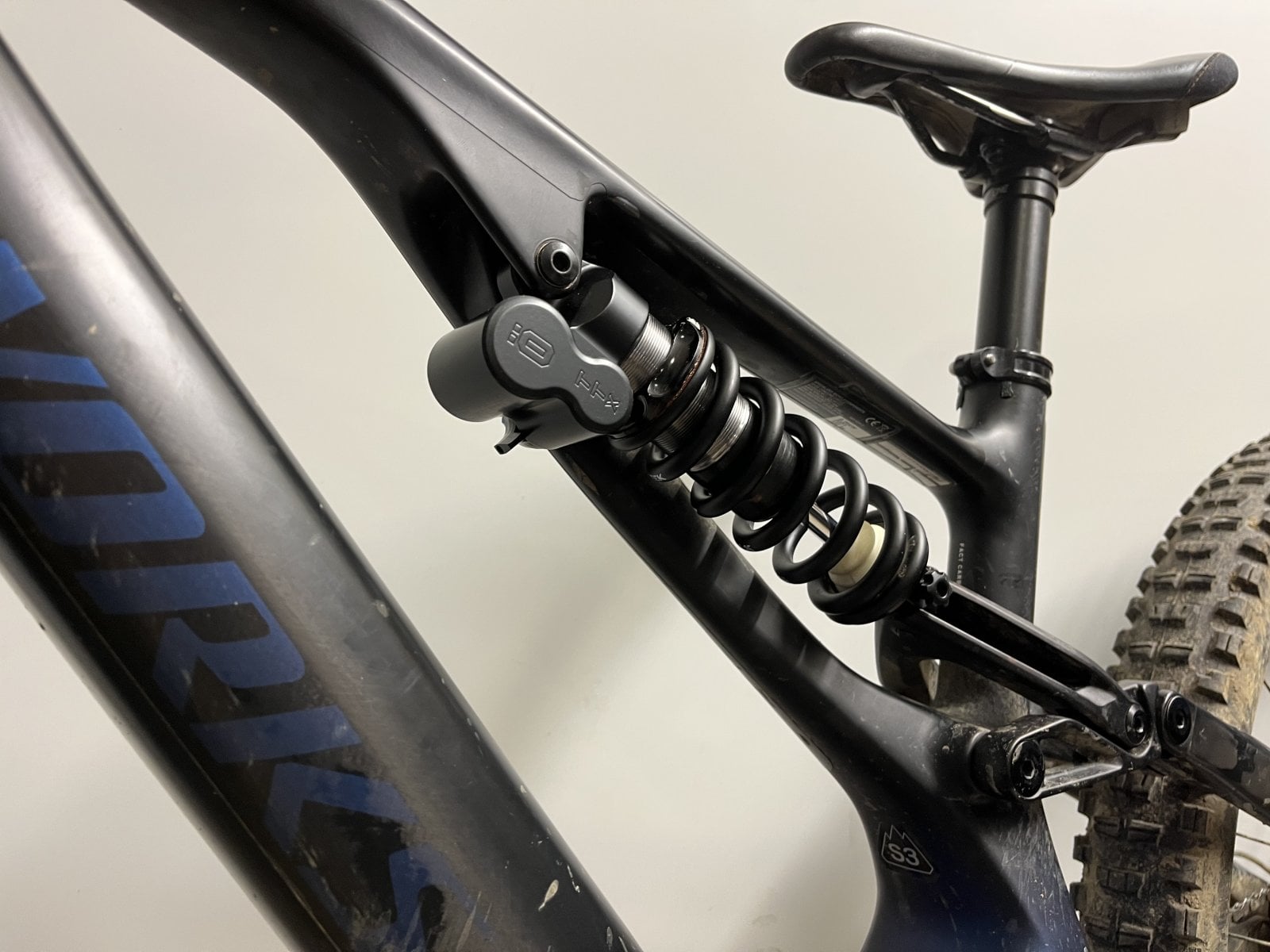

Here the "70mm" TTX22M:

My E-storia showed up today, documentation is terrible as is the location of the LOK lever...
Any other users have baseline clicker or bottom out settings?
For manuals you can find it here:
e-Storia_User_Manual_1.1.pdf (extremeshox.com).
You are right, documentation on the box was nearly nothing.
Location of the LOK lever is terrible yes, but after a few km you can easily find it and use it.
For me the performance are so great that this issue are bearable
