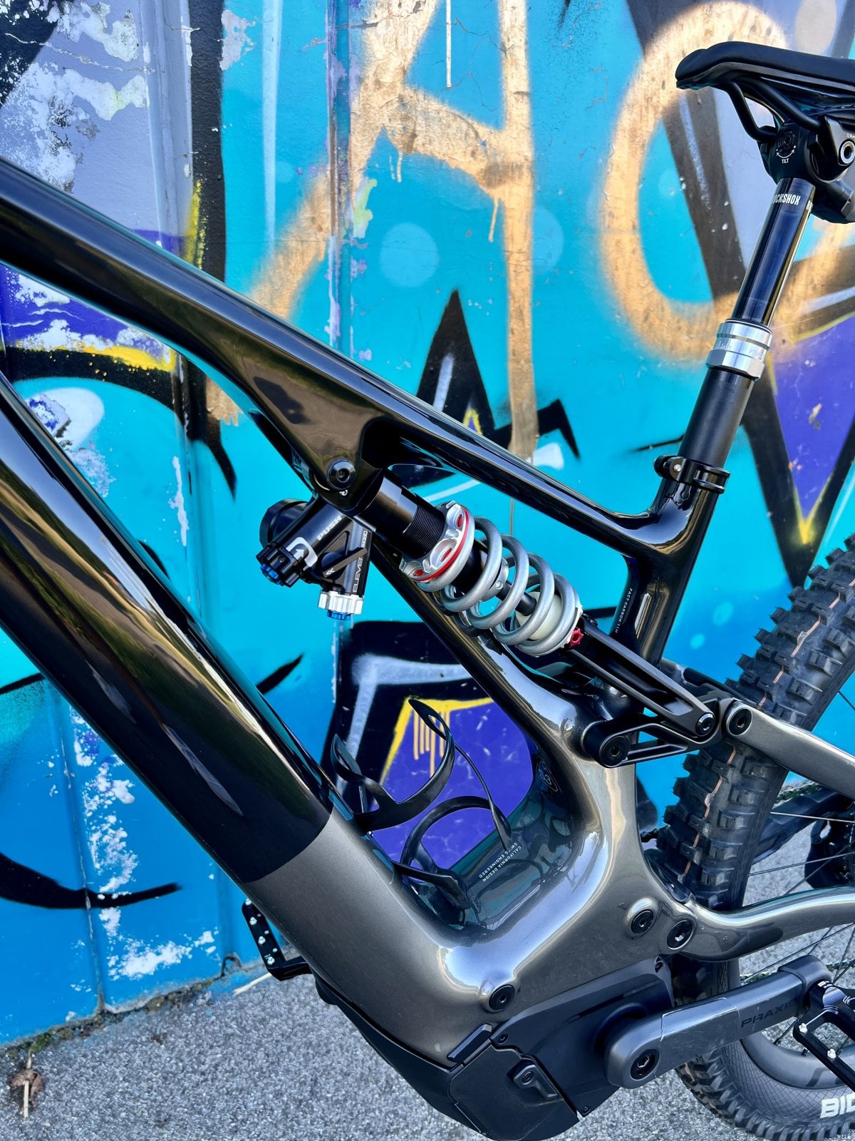

FWIW I've put my RockShox Super Delux coil RCT on my 22 Alloy comp. It's a take off from my Meta Power. I'm tipping the scale at 255LB nekked and I'm running a 750lb spring with about 30% sag. Running an EXT spring. If the shock isn't up to the task and blows up I'll get an eStoria, but I'm going the cheap route first.
The selling point of the eStoria is the bottom out control and steel damper shaft. I really like having an adjustable bottom out is key to good coil feel. You can run a slightly lighter spring for small bump plushness and dial in the bottom out speed. I love the HBO on my Smashpot.
FYI air springs suck for riders over 225lbs. Steel is real!

Finally got around to running the e storia, very impressed, 2 rides now on the expert and i am impressed by the HBO, very noticable over drops that i have struggled with on the DVO jade X. Quite smooth on the pedals at high speed and definatley more poppy than i would have thought, quite surprisingly poppy. So for me as a heavier rider the HBO is quite amazing...feels like you landing on soft sand ( not a great explaination) but it seems to just slow to bottom rarher than hit a sudden stop....
