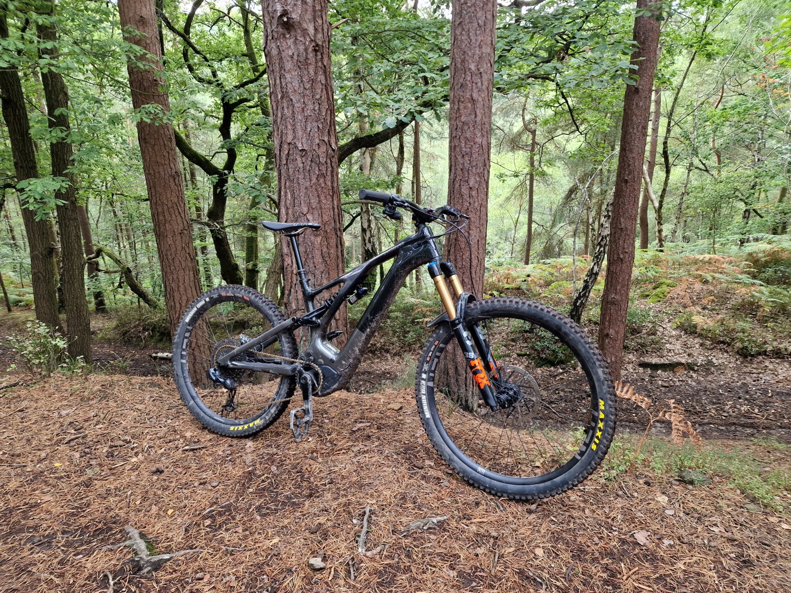

Fitted the regular cascade today. Added a heavier coil spring while I was at it. Sits about 30% sag but I'm a bit heavier than normal currently (3kg above my normal 90). 550 spring.
Noticed even more flex and slop now from the clevis design is that something others have experienced?
Yet to ride properly but that seals the deal for me. Going to sell the bike as I've had enough of the flex in the suspension design its not for me
