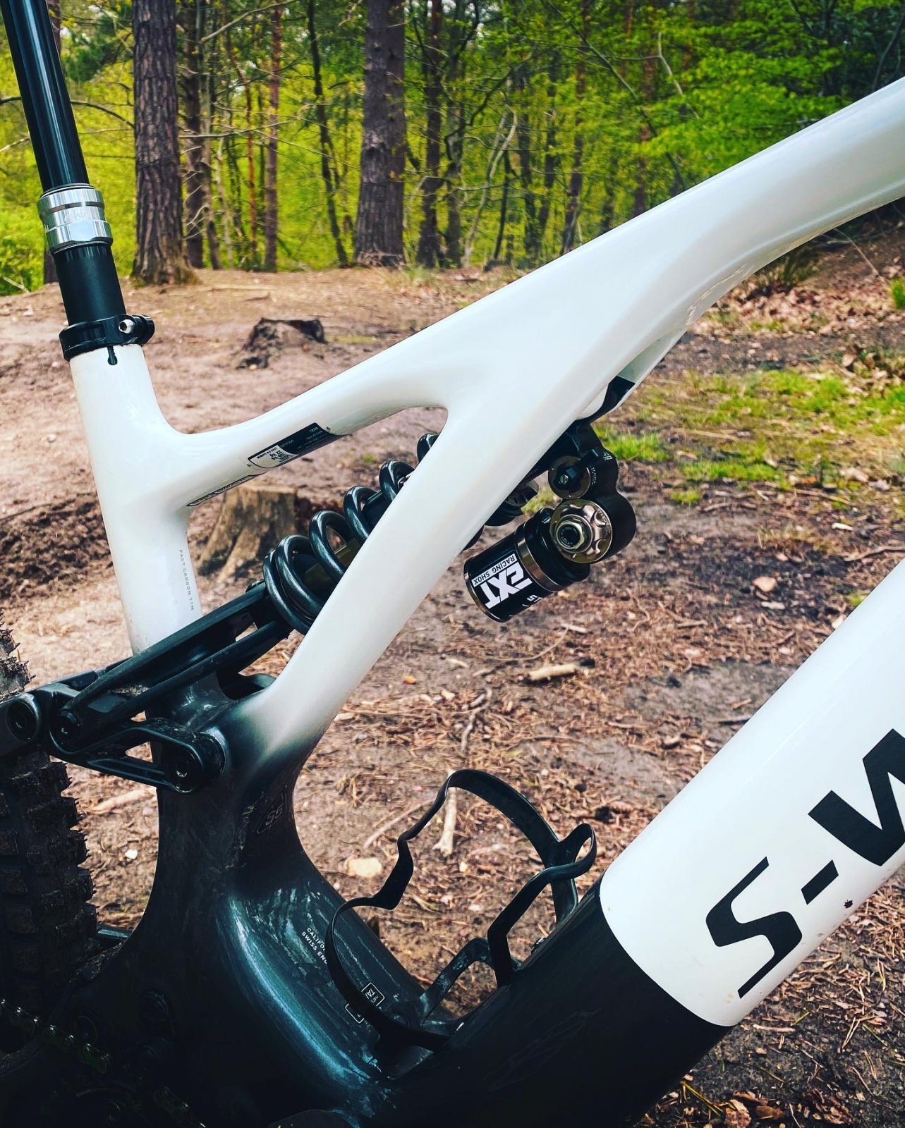

I would recommend you try a 650lb Spring. I work for United States EXT distributor so I am obviously a bit bias but the feedback we have gotten from people running the e-storia on the Levo has been pretty amazing. I am running one on the newest Norco Sight VLT that I have also ran the Arma on and the e-storia definitely has a noticeable increase in performance over the V3 platform. I think the negative spring helps quite a bit.

I’m running the regular EXT Storia with the regular cascade link with no issues. I had the shock retuned by Mojo for the link and bike, it’s been pretty damn good so far. I would have went with the e-storia but I already had a brand new storia that was never used from another bike. I’d imagine it would be the same with long link kit if the shock is tuned for the link.

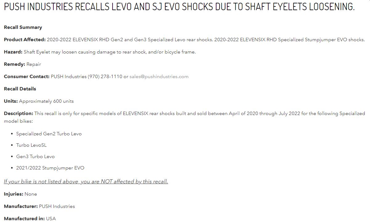

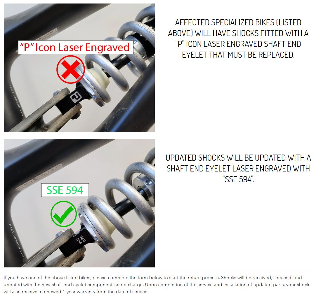

Push have an actuell recall
link

... It looks like the shock shaft is thicker too, ...
I ordered an 11.6 for the Levo Gen3 three weeks ago. The dealer told me the delivery time would be 8-10 weeks, or more, because the shaft was revised and the damper is now being tested.
