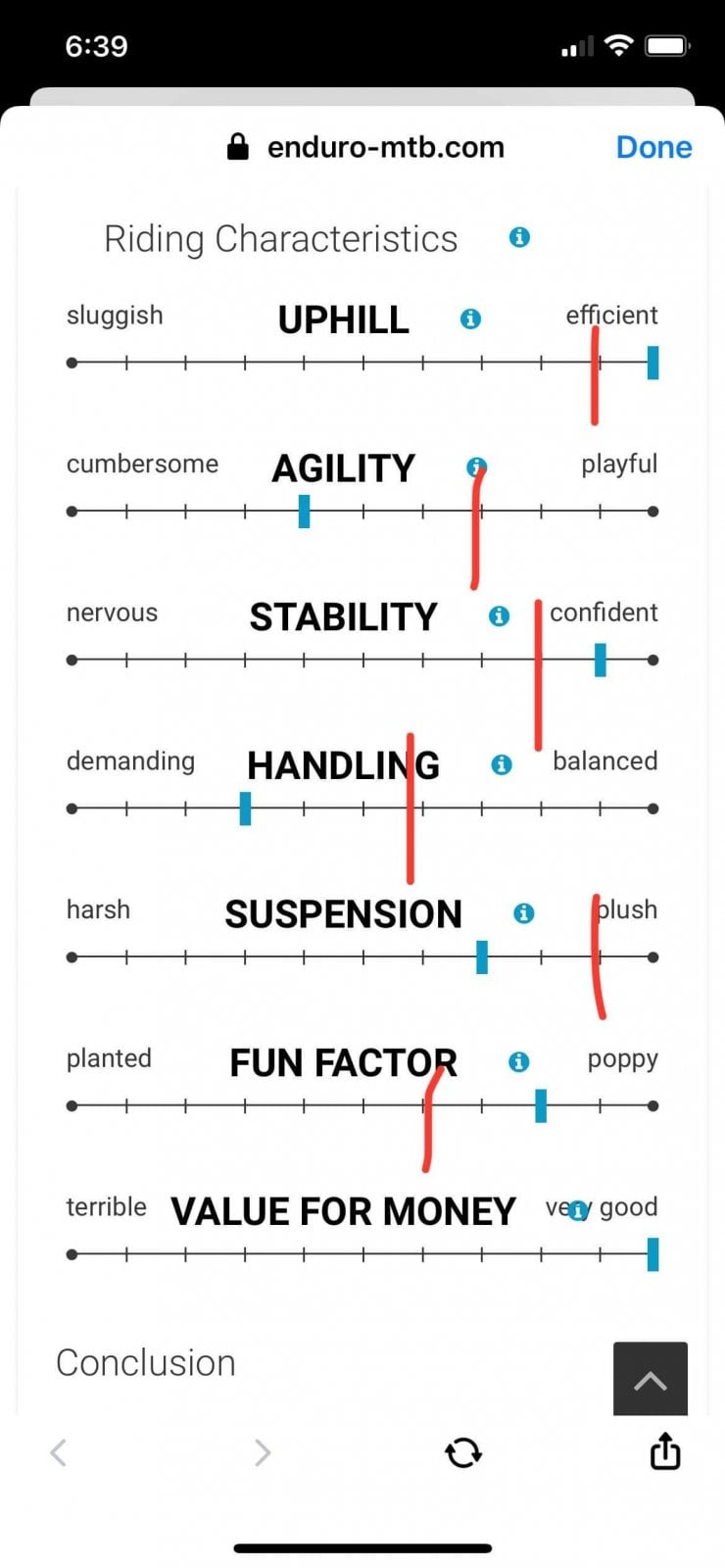

Back to my query, like I say trail days 65.5 air setup, more techy dh stuff 64 coil, most lads I’m out with are 63-64 I’ve tried them also, it’s better dh for sure. I’d also like that bit of small bump compliance...there’s more the rise is capable of.
I’ll enjoy the experimenting and I’ve not yet seen anyone go back to air after coil so if anything I might decide to let air go in the end.
maybe a pretty picture might help?
Blue is 65.5 air
Red is 64 mullet
so basically 1 fork, 2 shocks.
I couldn’t care less what brand they are as long as I can change the fork travel. I know you can get a 160mm air shaft for the Fox 36 but not sure how easy it is to swap around with the 150mm, if that’s practical maybe I keep it, it’s a great fork.
Alternatively I sell that and for a few quid extra buy the Ext Era or the Ohlins which both have adjustable travel and I think do away with the tokens, Ohlins one you can actually pop a coil in there or revert back to air. I suspect the Ohlins is for heavy hitters though without decent small bump compliance
The Ohlins coil and air both have decent small bump compliance.
If you are looking at a decent fork with the option of changing travel easily get a Mezzer. Travel change can be done in about 15mins and everything comes with the fork on purchase.

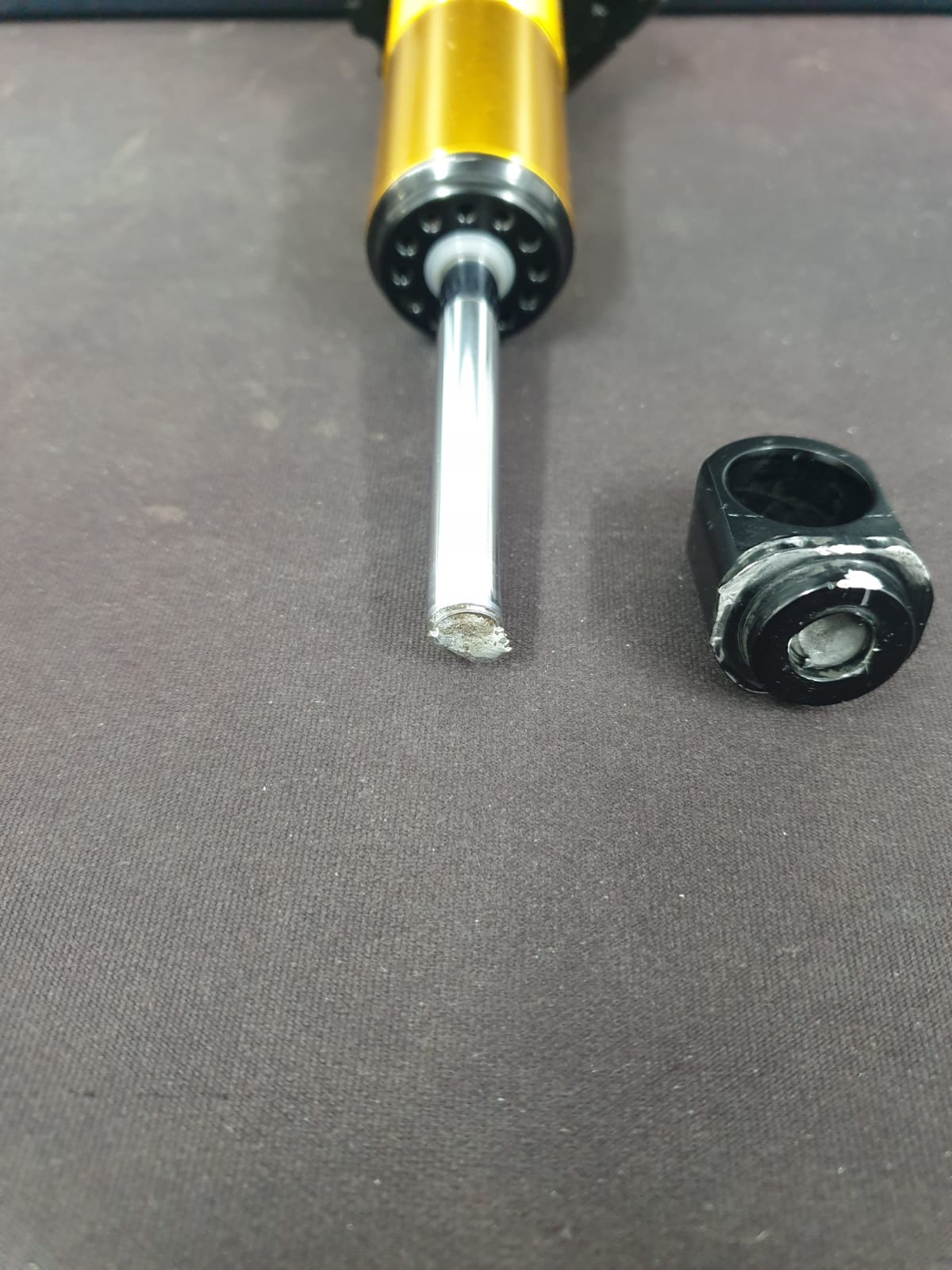

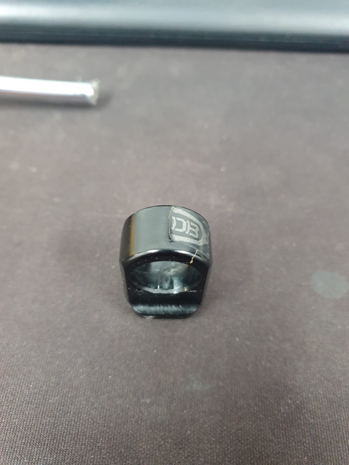

well this happened last Friday at cross country trail nothing big flowy trail on my levo 19
View attachment 68440 View attachment 68441
Oh Dear, unfortunately this a common fault with the Cane creek In Line shock on a levo. They re not recommended due to the levo suspension linkage design.... Even if the shock has the DB sticker on it. Same with the Fox DHX. You'll need a thicker shafted shock, and one which manufacturers recommend for the levo. There was a list on this forum somewhere.
here..... Coil shocks recommended for levo

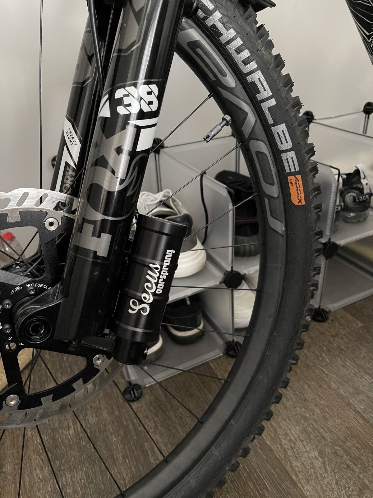

The best of both worlds vorsprung secus
A mate of mine swears by this although I’d seen a few reports it’s not cracking on multiple sequential
hits and it stands out a bit like you might expect the rider to be a master sender or something…..then there would be me! ? but that said it’s a cheap way to go about it if it’s working, what’s your experience?

It’s the same on the Rise! Only few coils work, similar linkage to Levo

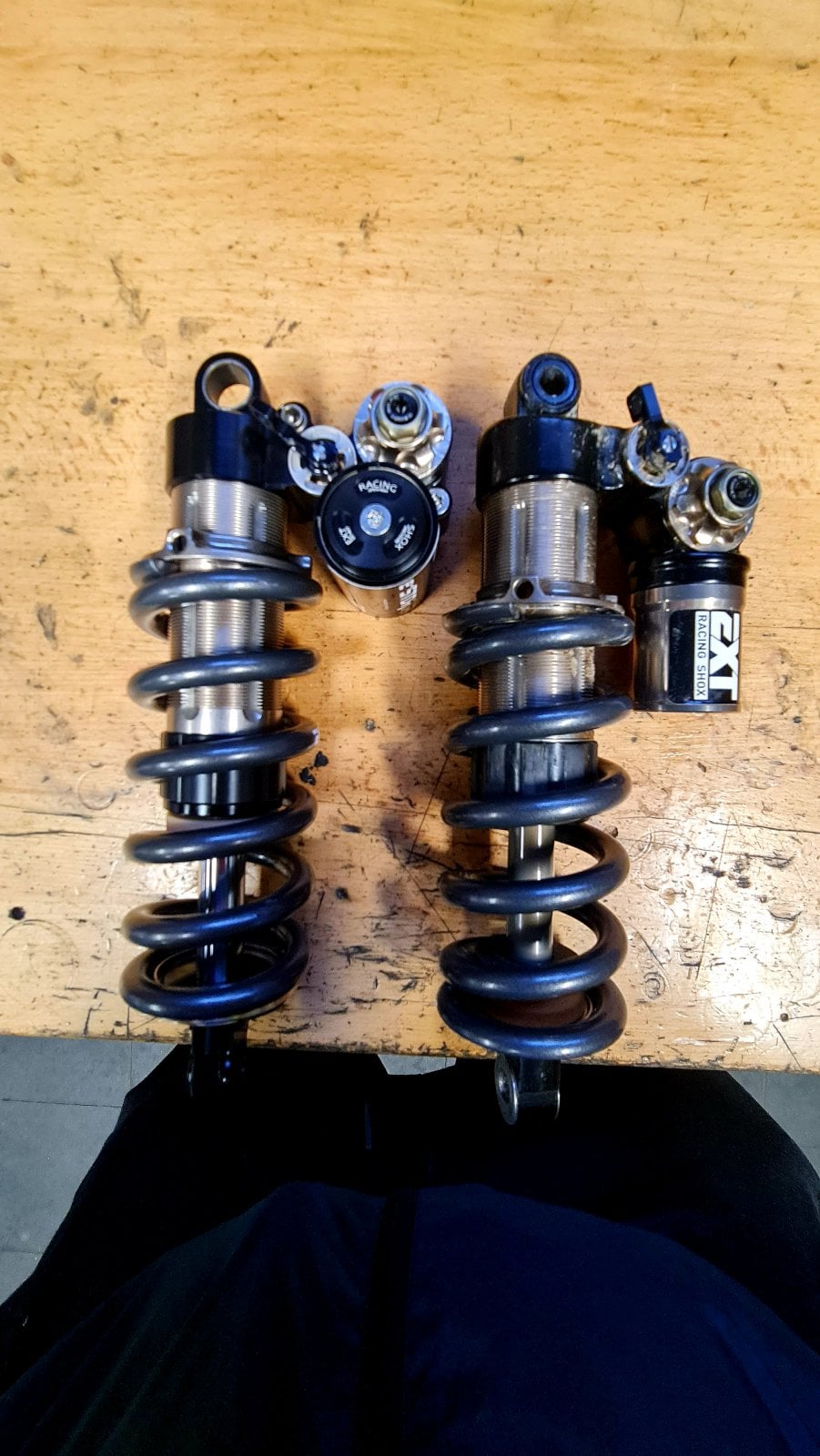

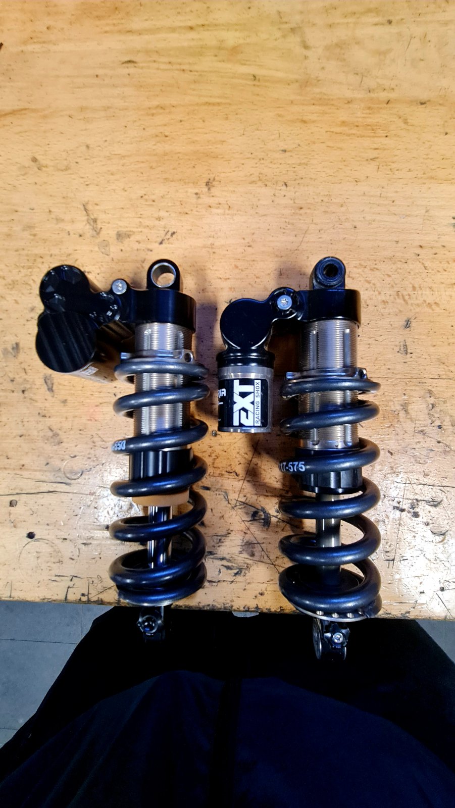

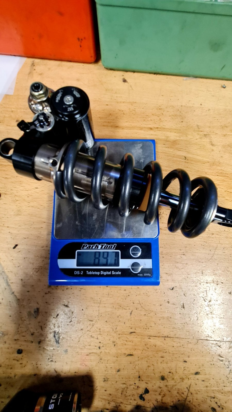

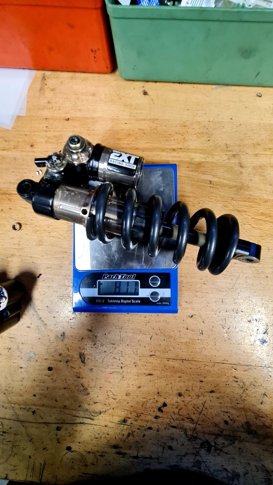

Estoria fitted and one ride tested. Little bit heavier than storia. But performance is top notch. 575 spring and my weight approx 90kg. That hydraulic bottom out resistance makes quite a change to bottom part of suspension. I had storia on my gen 2 levo and also on new levo. Performance wise I was happy on both bikes with storia(tune was little bit stiff on gen 3 levo). But with estoria did make it more plush and same time its proggressive. Rear tire holds on track like glue.I sold my old storia and 400€ was worth. More testing to come. Also theres more clicks on rb. 16. Shaft looks also sturdier. 🙂
Thanks for the feedback comparing the two. That's great to hear that some are finally starting to receive their orders! I have to ask since I'm still waiting on mine, when did you place your order?
I ordered from my ext dealer 4130.fi from Finland. It was early august when I ordered it. Also with 575 spring weight difference is probably over 100gr. But don't mind that.
