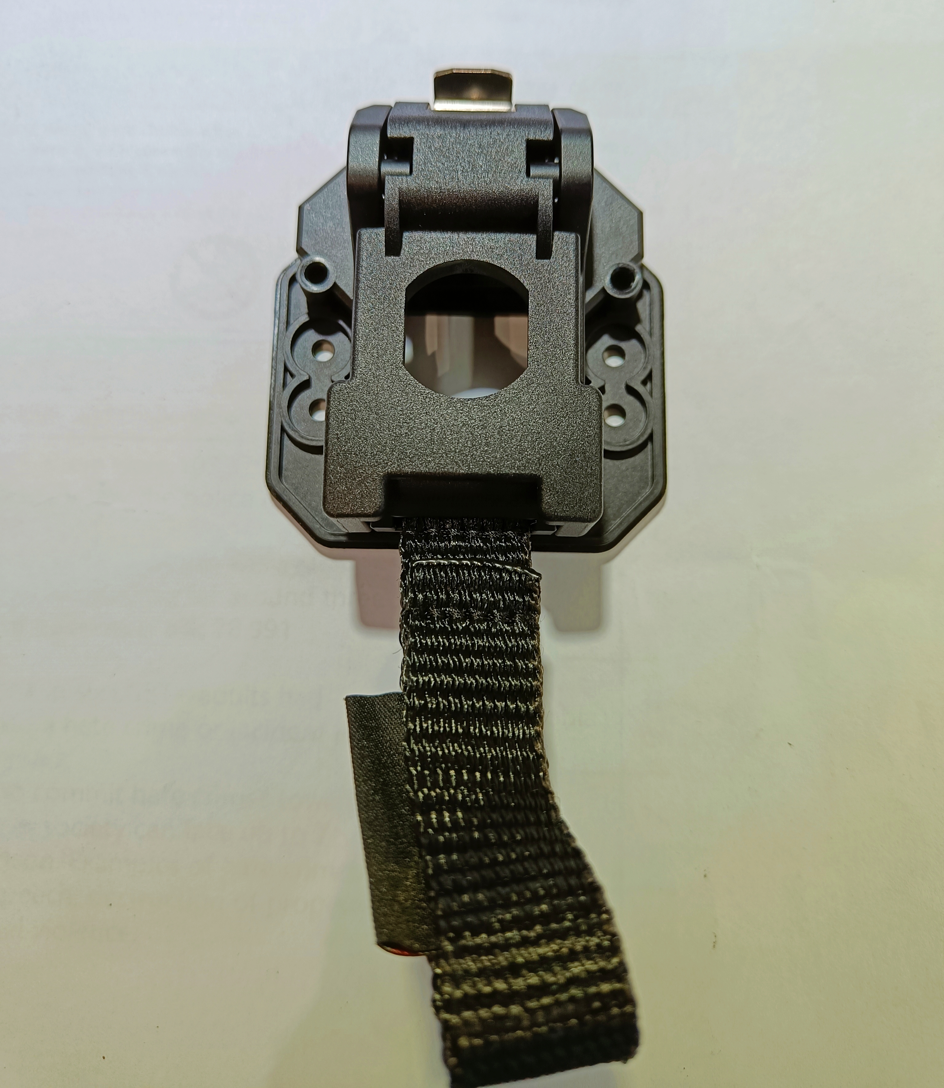

Hi all

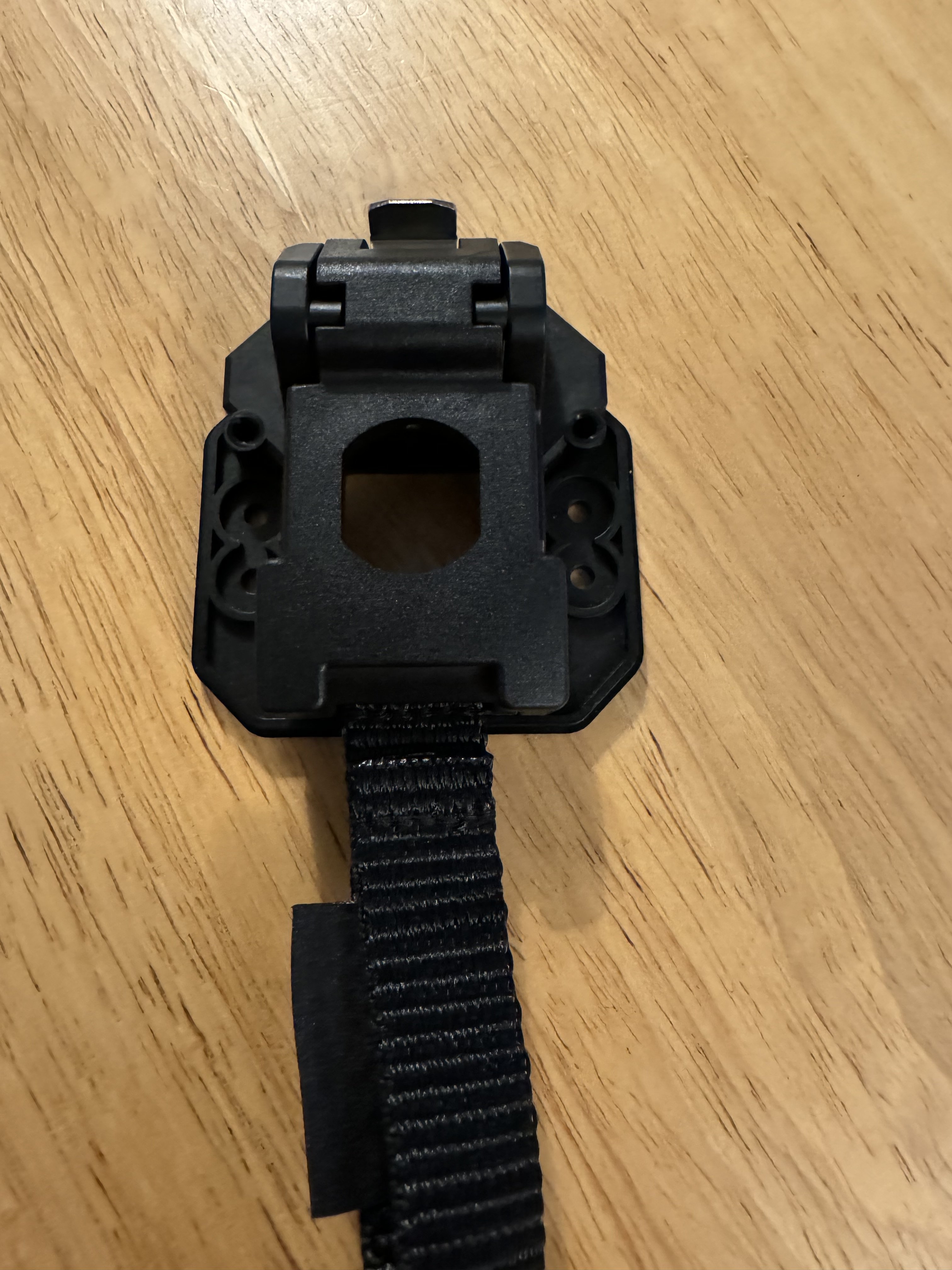

I just got my Strive today, it's from Canyon's Outlet store, meaning that it has been used previously for testing purposes or so. I have been following the battery latch discussions here, is it correct that I still have the "old" latch?
I ordered Tobias' fix, would you recommend installing it right away or wait until the current latch might break and then hopefully install Canyon's new latch?
I am not 100% sure I understand which part exactly is commonly breaking with the old latch. When I checked mine, it seemed fine. Can someone enlighten me once again which part in the latch to keep inspecting?
Further, I read that some batteries have a little bit of play even when installed. Mine has a lot of play if I don't engage the latch, however, when I do (after the very distinct click), there does not seem to be any play whatsoever. Am I right to assume that the batteries with play might be problematic if this is the case after engaging the latch, so nothing to worry about in my particular case?

Hi all
That looks like you have the new latch fitted. The new latch has the two little extra lugs which yours clearly has. Looks like you’re good to ride trouble free 👍🏽

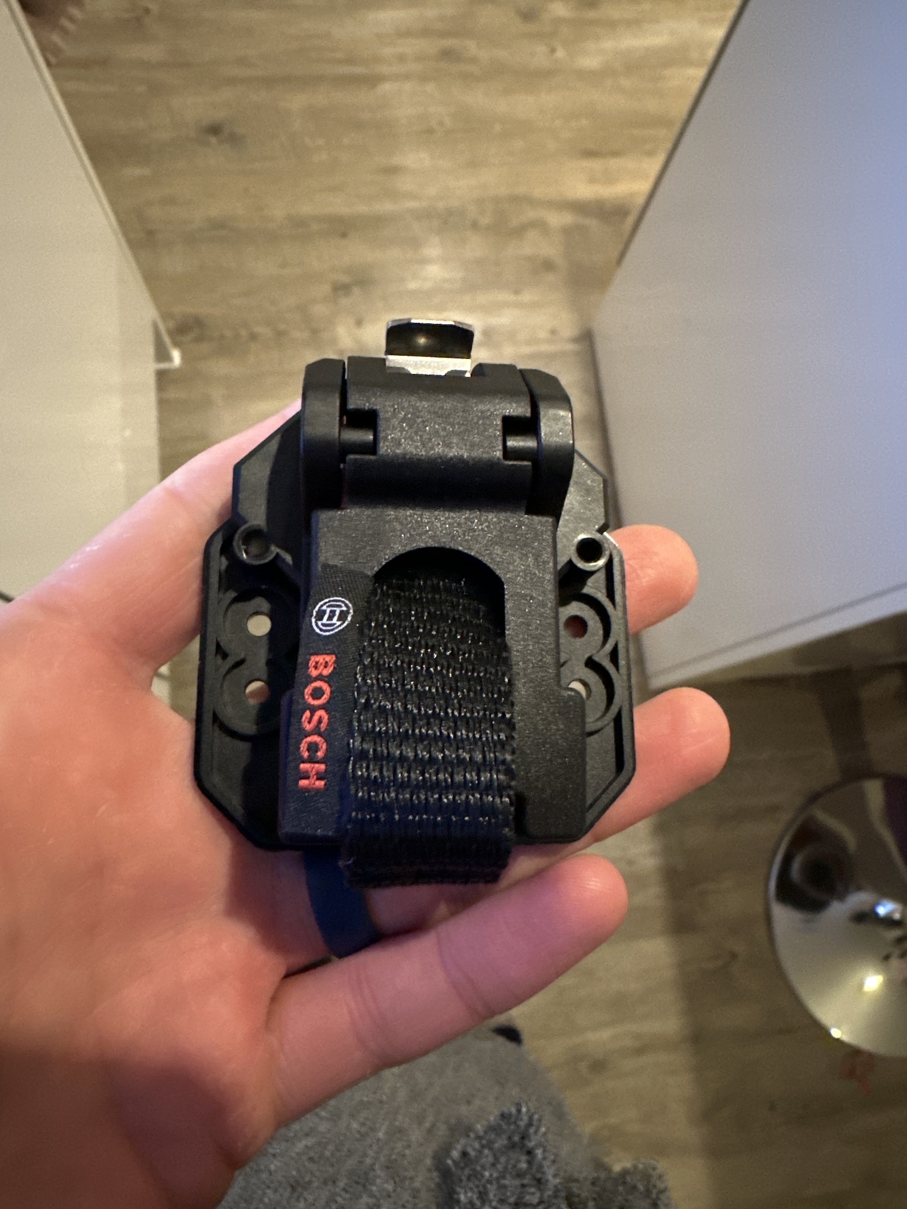

I received my new design latch from Canyon today. Old unit on the left and new unit on the right. The pivoting latch is beefier at the points that previously failed. Apart from that, visually, it looks like the rest is the same.
Fitted it to my battery (750). Good news is that if any of you have the latch fix kit from Tobias Post it fits too.
Fingers crossed this fixes the Achilles Heal of this very capable bike.
View attachment 131419 View attachment 131420 View attachment 131421
