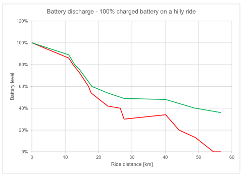

My battery stats (BT E8010, 504wh, top mount)
1) # of charging cycles = 92
2) remaining capacity = 87%
3) charger = EC-E6000 (slow charger)
The battery is 2 years old, always stored and charged inside the house. I usually finish my rides at 20 to 50% state of charge, then I recharge the battery to 100%. The above stats seems OK, but in practice the battery performance is much more worse.
I've read in this topic and also in the Shimano / Battery life topic, that some of you experienced, that the battery cuts off at lower charge percentage levels. The same issues exits for my battery as well.
I've reported the issue to my local bike dealer, with some detailed description, they forwarded it to the local Shimano representative, but there was no reaction. After while my dealer provided me replacment battery (17 cycles, 92% capacity) for testing, the outcome was really self explanatory.

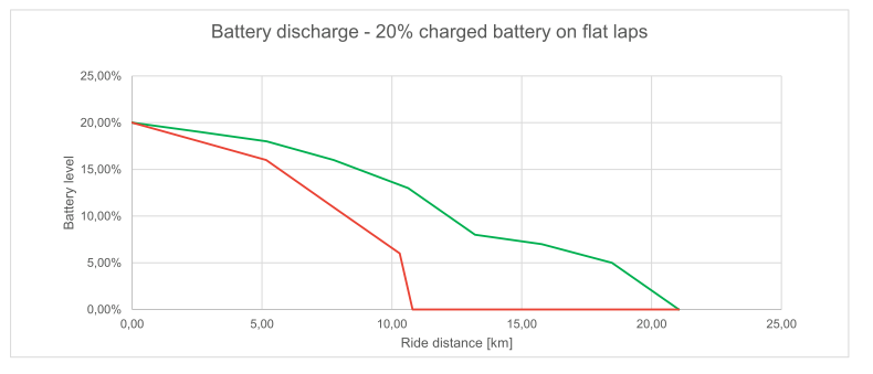

The first the was done to ride short laps around the nearby streets on a flat terrain. Intial charge level was 20% for both battery. My battery (RED) depleted after 11 km if riding, and I was able to ride 21km with the replacment one (GREEN). My battery has very steep non linear discharge characteristic the other one is more or less linear.
My other test ride was 50km+ ride around the nearby hills. My battery shut down after 54,5 km, the other battery had 36% remaining charge level at the end of the ride.
This info was also shared to Shimano, (it was in 2020 Nov) and still no answer from them! I'm really pissed up on the attitude of Hungarian Shimano representative, this not the support that we expecting for such an expensive stuff.
Do you have any experience with warranty replacement? Are there anybody who had similar issues, and got a new battery from Shimano?

Very interesting. How did you get those graphs? That's exactly the sort of thing that I need to obtain. I have just bought a new E8035 battery, so have that to compare to my 81% health battery.
I've created this graphs manually in Excel, the battery percentage was read from Etube project (tablet version!) at the end of each lap / or at certain locations.

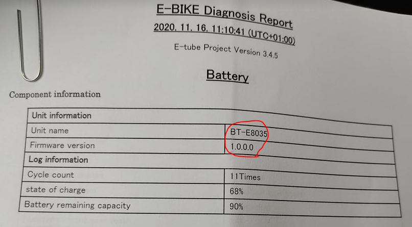

Hi Gents, I would like to ask a small favor from those , who have 8035 battery and NO DEGRADATION with more than 10 cycles !
Could you please check with your dealer readout the FW version of the battery ?
Mine has been read out today by my dealer&service, and I have catched this part that battery has a FW inside.
If you check that with Etube app or STunlocker , than this info is hidden. Ergo you can not upgrade the fw on the battery by yourself.
That made my theory that i believe there is a bug in the Battery Management System (BMS) and if we can find a battery which has 100% health and 10 or more cycles and higher FW version. Than that is it. :cool:
Certainly ,how you store and charge and use your battery will affect the lifetime.
However I trully beileve that I checked mine on 9th cycle and said 100% and when it hit 10th cycle than it dropped 90% can not be coincident. There was nothing in between like 98%, or 97% etc... immediatelly 10% out. That is why I do have this theory.
With your kind help, I think we can have some understanding and might be a root cause here. That's why I am counting on the support of this nice community !
Of course mine has been offcially claimed at Shimano as well by my dealer. I will feed you back about the answer.
