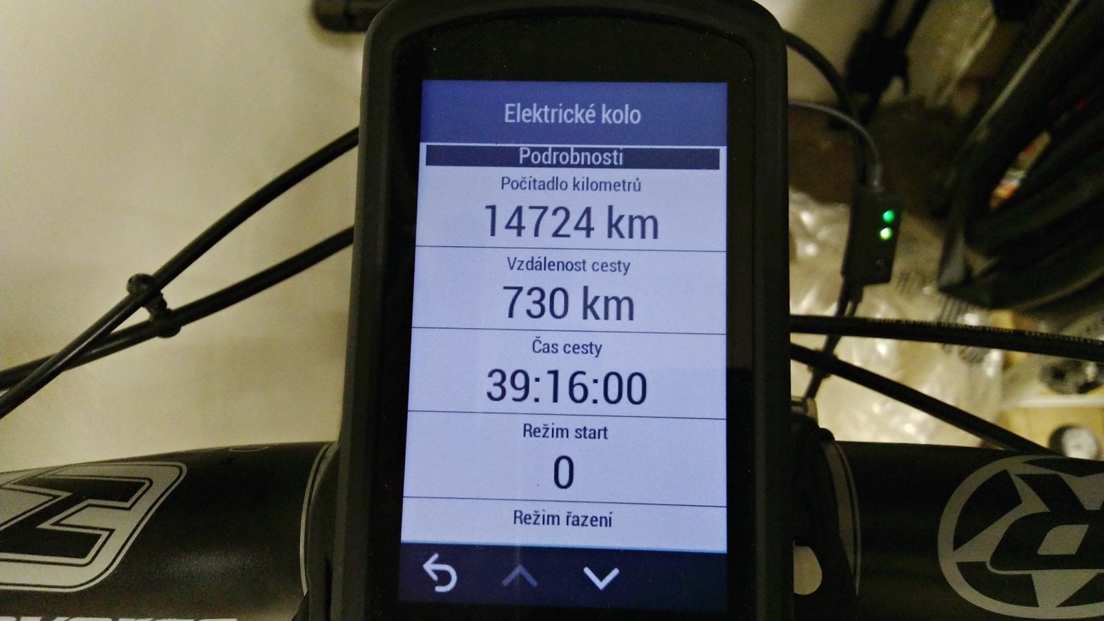

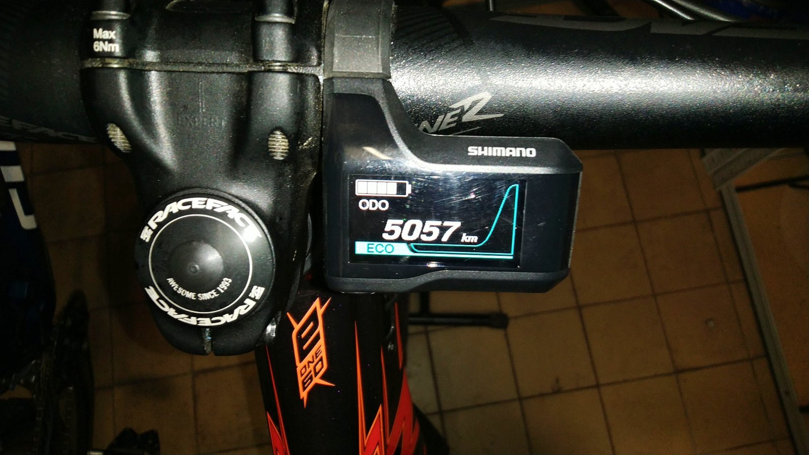

I have had MERIDA eONE-SIXTY 900-E size XL since March 2019, my beloved wife has had eONE-SIXTY M#RIDA METALLIC CRIMSON (RED LIGHTNING) size M since July 2019.
We use only the Shimano EC-E6000 charger,
battery 2x Shimano BT-E8010, Li-ion 36V-14 Ah-504 Wh
Sometimes I use an M#rida battery that my wife rides on. So my battery has less km than my Merida and vice versa.
We use the E-Bike for normal riding for fun on all possible surfaces, all year round. No bike parks.
During the winter we use neoprene covers for batteries, even so the real range is lower due to the cold.
We both drive about 80% in ECO mode.
Merida battery:
now 11.747 km / 7,320 miles approximately
battery health 87%
charging cycles 94.
M#rida battery:
now 8.034 km / 5,005 mil
battery health 92%
charging cycles 54.
Comparing the two batteries, it would probably be possible to conclude that the "% / charge cycle" model is very similar / the same. I feel that it no longer looks good enough (?) To achieve the declared 60% / 1000 cycles?
We will see how it goes.
Merida mileage: 14.724 km / 9,174 miles approx
M#rida mileage: 5.057 km / 3,151 miles approx

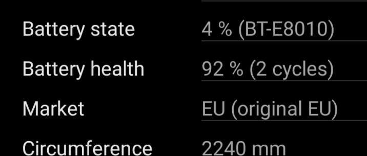

rafaellop
Dec 8, 2020
80
39
Poland
Battery (model bt-e8010 504wh - external)
  • 1) # of charging cycles = 2
  • 2) remaining capacity = 92%
  • 3) charger = EC-E6000.
  • 4) age = 2 weeks, 88 km, 3187 m up
  • 5) style = 90% eco, 10% trial, no boost, standard assistance settings

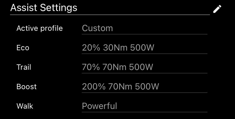

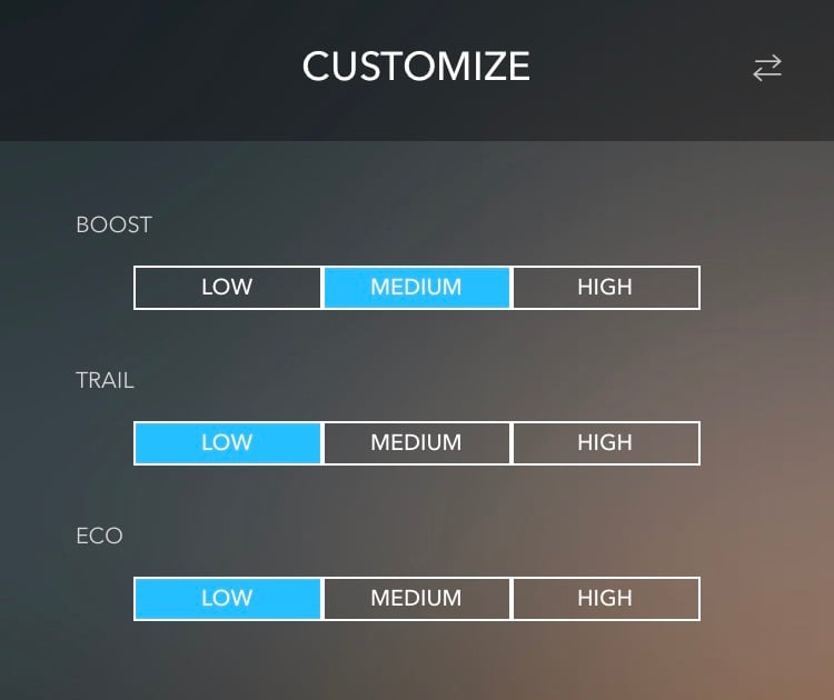

Slightly off topic but relevant to BMS. I am convinced that my battery is in a better shape than specified by BMS and reported by STunlocker.
I have customised my motor using e-Tube app to Low-Low-Med:
This translates to 20% — 70% — 200% assist:
Today I went for a 52km ride at ave 22.3km/h and I have 54% battery power left. Admittedly it was mostly on a relatively flat surface, 240m elevation, but anyway…
This is odd, as I was pushing hard, mostly in Eco (20%) and some in Trail (70%) on up-hills, with one up-hill in Boost (200%)
So, theoretically my bike should be able to do 100km on flat roads, with 20%—70%—200% settings.
However, I suspect that the battery loses power with concave curve down. More testing to follow!

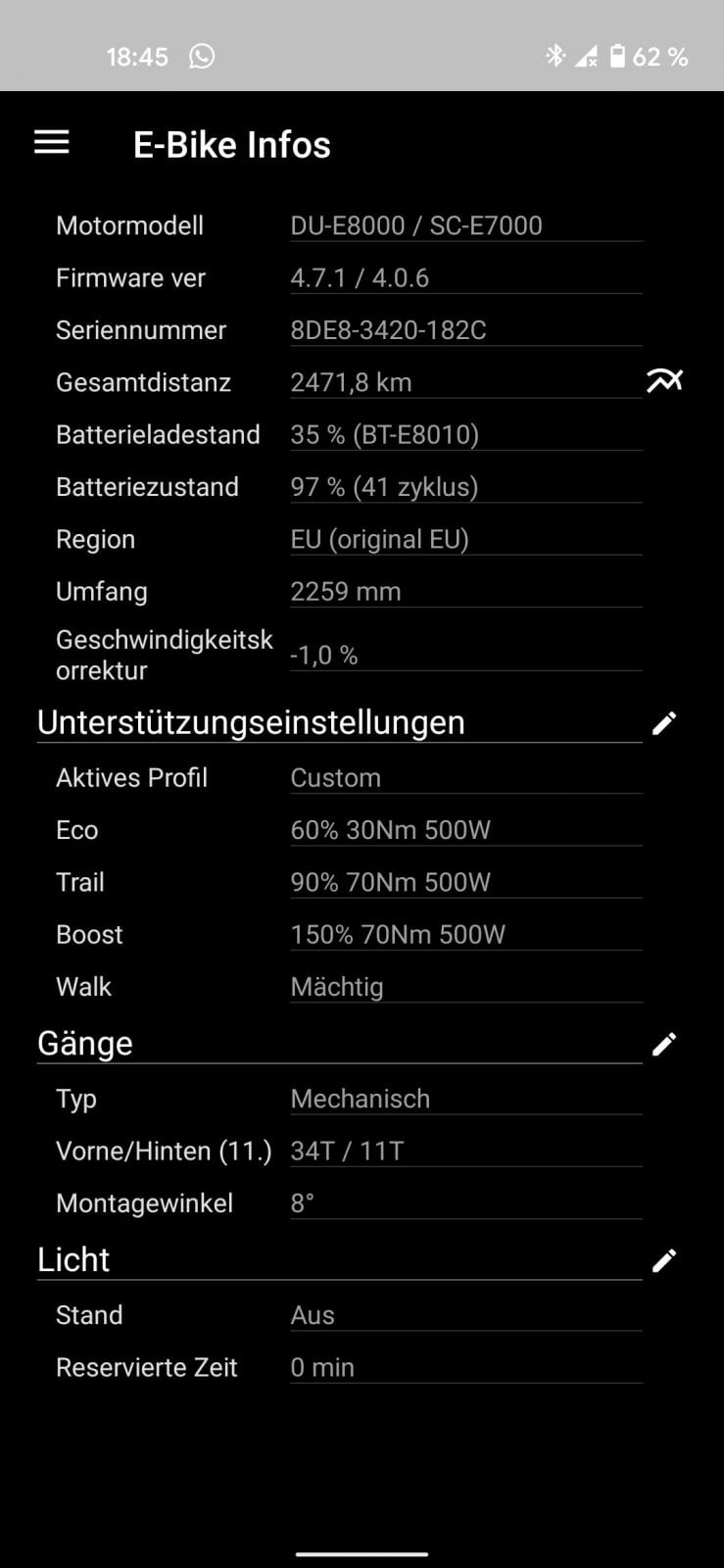

Mine now dropped to 97%. I have more like 3000km on it because I often don't power on the system on long descents. I almost never empty the battery completely. I did it maybe once or twice and overall not much more then 10 times below 10% SOC I believe. I also only charge it to 90 or 100% when I need it. And the thing I noticed is that battery health dropped at these occasions when I had to charge it to 100% when I went traveling with my campervan and it was sitting a few days at 100% before it got used.
I also store it 95% of the time between 20-40% SOC and 10-20 degrees. I also use only the Shimano EC-E6000 charger.

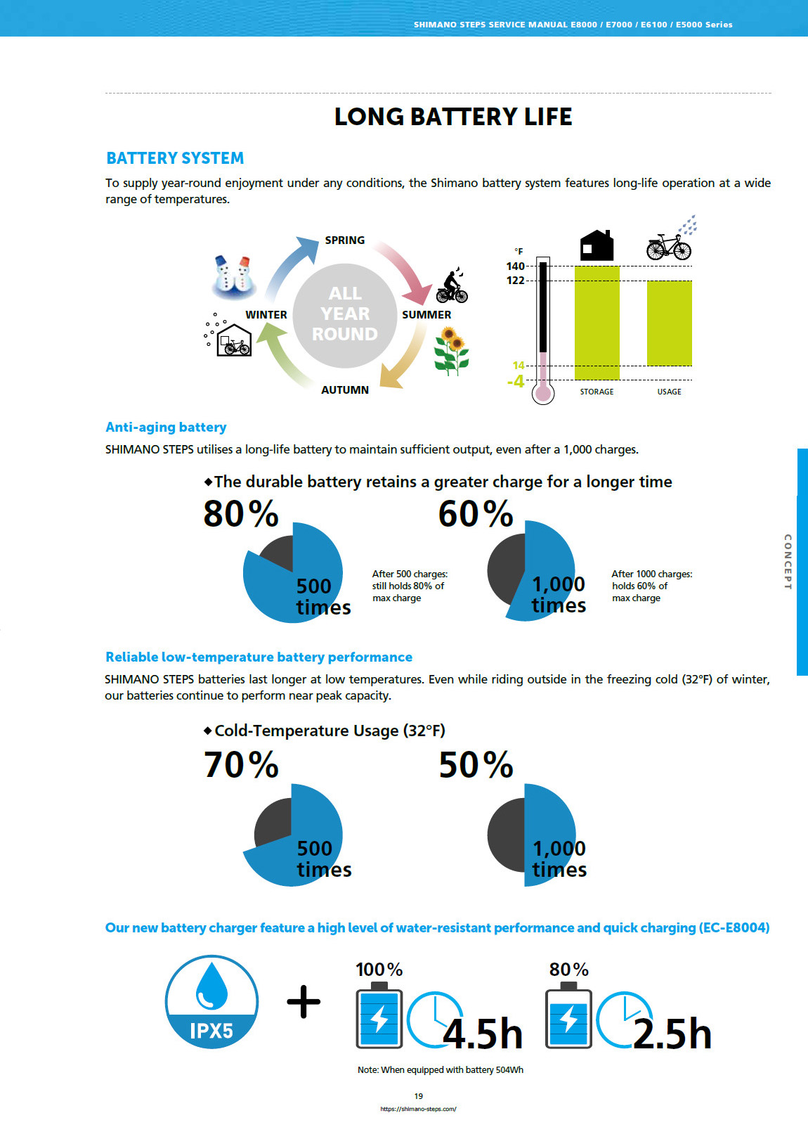

Some bike suppliers like E-Thirteen, Spesh and others, when they see in this forum a customer with a problem, they quickly jump in the thread and provide a solution and normally covered by warranty. But as for Shimano, they do not even provide any help but tell their lawyers to remove any specification in the documentation, his programmers to remove any BATTERY LIFE number in e-TUBE app, so we do not have any ducumentation to backup a claim.
But luckily, ducuments are not erased in Internet and old documents can still be found. I am attaching one of the pages of a 2019 Shimano Steps Service Manual, where it specifies that the battery should have 80% of the charge at 500 cycles or 60% at 1000 cycles. But since then the number of 80% charge at 500cycles has disappeared from shimano documentation. But I suppose that the figure 80% charge at 500cycles as showed in this document is still legally binding.
Has anybody successfully used this specification to get Shimano warranty the battery at 80% charge? View attachment 67312

LBS got back to me and no warranty for internal 504wh battery at 80% 60 cycles after 11months from new, they want me to record rides and battery state after these to prove my range is down
This is Page 19 of Shimano Steps Service Manual that states 80% battery health after 500 charge cycles, show it to your LBS and have Shimano honour their statement in their own documentation.
