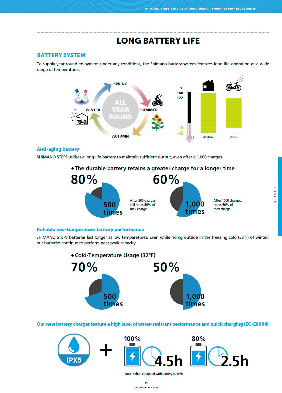

This is Page 19 of Shimano Steps Service Manual that states 80% battery health after 500 charge cycles, show it to your LBS and have Shimano honour their statement in their own documentation.
My bike went into Lbs had reports done from SME2 attached to a pc there latest E-TUBE version but it doesn’t show the battery health anymore so I did it on my computer with the older version which shows 80%, madison didn’t get back to LBS for weeks even after countless emails I used to get 10-12 miles on fairly flat rides depending on mud or wind now getting 5-7 in eco on same rides wife’s shimano e8000 bike is the same age done same rides is at 99% after same cycles, thanks I will send this to my LBS
Shimano etube for windows using adapter SM-PCE02 is the Software tool used by LBS and Shimano Service Centers to diagnose battery issues. And you say that in the latest version Shimano has removed the BATTERY HEALTH diagnose capability so it is not possible to verify if the battery is defective or not.
I do not know the reason, but for me it looks like a plot of a big company trying to reduce financial exposure for warranty claims of defective batteries.
I agree
