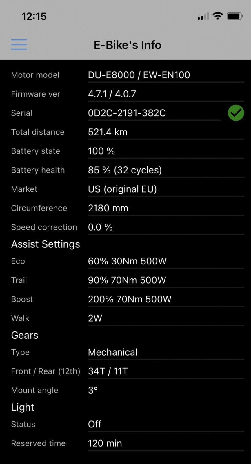

Dave_B
Aug 29, 2020
1,470
1,601
Newquay
This is mine.
Ignore the distance, it’s a new motor
