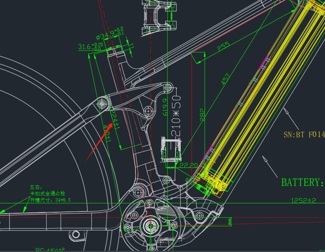

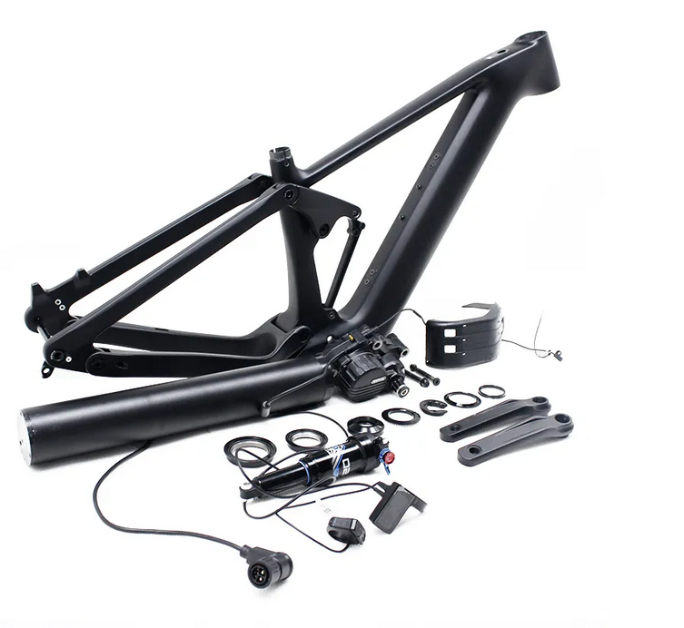

@voigtkampff "Dropper insert depth on M-size frame is 224mm according to the drawing I got from Jean."
Specifications
Alibaba
Rear Shock hardware 8x22.2mm
Rear Thru axle is 12 x 1.5 x 179
Batteries available
BT FT100.B360 36v 360wg
BT FT014 43v 410WH
Custom ZS BT720 36v 720WH
Chart is website wrong, the headset is a ZS56/28.6 ICR upper and ZS66/40 lower. Suitable for a 1 1/8"-1.5" tapered steerer.
The Bafang M820 motor uses standard ISIS cranks like the Bosch G4 and ones made by Miranda, FSA and Hope.
New version of the rear triangle will soon (2024) be available to support a coil shock and UDH dropout.
There are two versions of the Bafang M820, 36v and 43v and now 48v. You must choose which and get a battery to match the voltage.
Contact Lindalv <[email protected]>
Cost $770+shipping frame with Bafang M820 motor kit $1770+shipping

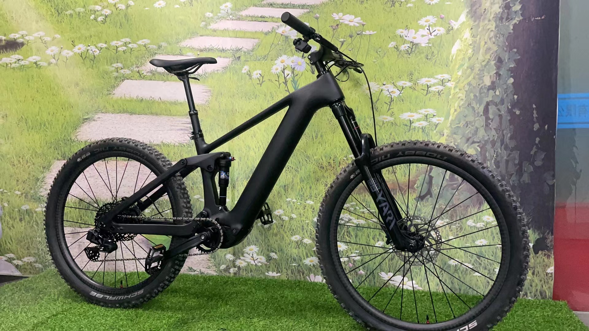

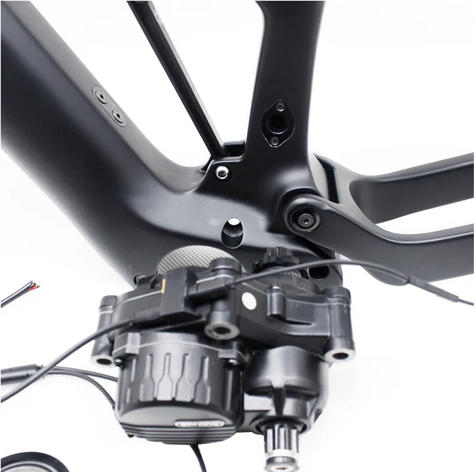

What beautiful photos. Do you know how the wires and cables come out of the frame and go into the rear triangle? You have such photos?
TCFlowClyde
Feb 26, 2022
1,335
863
Mesa, AZ
It looks there are only brake line ports...I believe the set up is for wireless shifting only. I'm using my wireless SRAM AXS GX drivetrain.🤙
The tell was they have a wireless setup in their complete build pics and no chain stay ports for the shifter cable.😞
But you may want to confirm with Linda that there aren't two frame versions: wireless drivetrain v. traditional wired?'🍻

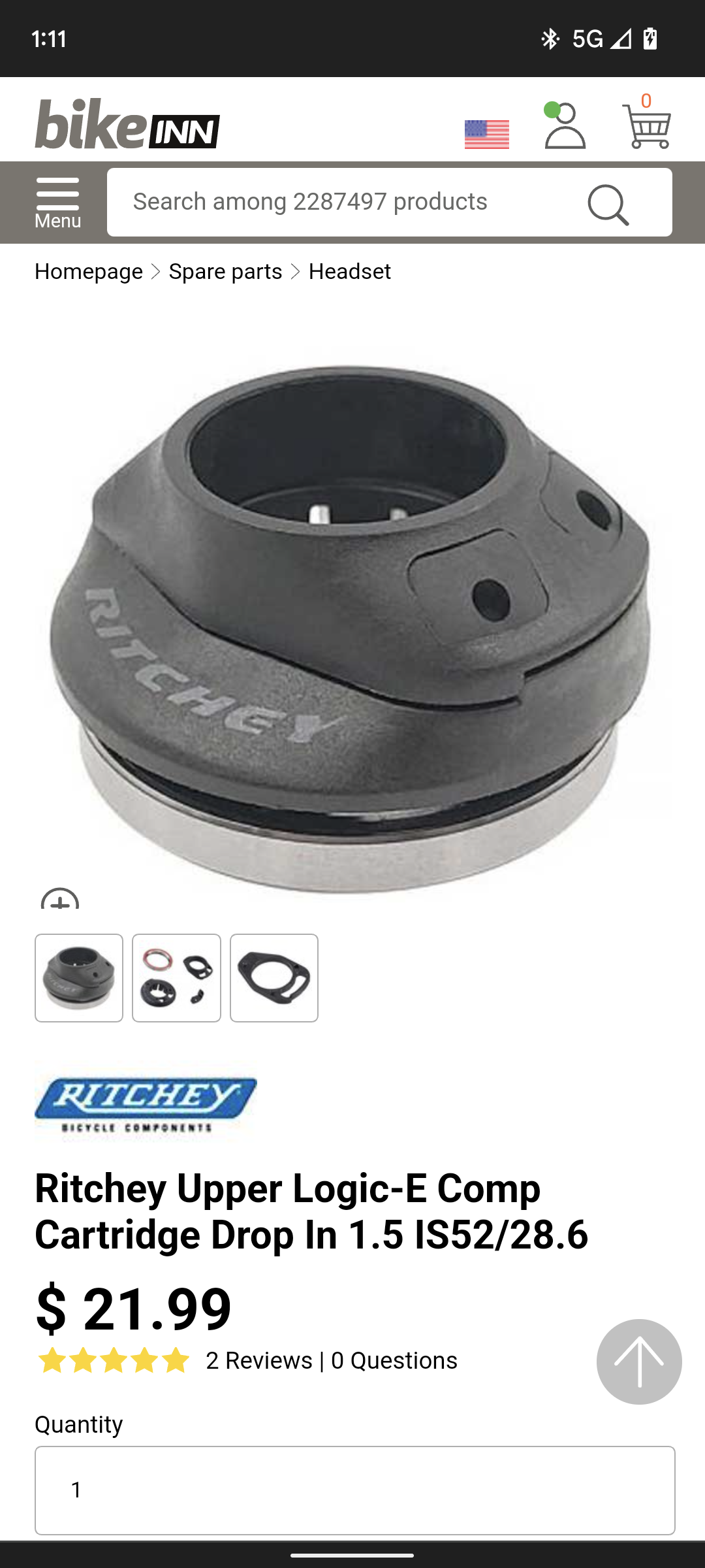

Just FYI on another IRC headset option. Here's a more traditional Ritchey that's likely better than stock:
Edited: 12/09/23
Looks like this one can't be used...its IS (integrated bearing system into the frame, no cup with a raised lip) not ZS (with cup) so the top cap probably wouldn't seal over the ZS bearing to be water tight.
If someone is able to somehow adapt it to the newer/smaller 52 mm top bearing CEF50 cup, it would interesting to see how well it works. But even if it did you'd have ream a bigger hole out for the chunkier cable plug.
The upgraded SZZS has got a nice custom display cable port on the top cap already, so would be lots of work on the Ritchey cap to make it functional.
Top picture looks like it has a chainstay port.

IN the top picture you can see it on the outside of the driveside chainstay. I don't think wired is dead quite yet.
But it does look stout so cross your fingers.
TCFlowClyde
Feb 26, 2022
1,335
863
Mesa, AZ
I saw it. But it's not. All 5 of my carbon frames have driveside ports dorsal not lateral. It lines up derailleur on top of chainstay with a friction-free path. Plus, the Orbea Wild has no cable ports either...anywhere.😲 Update: the Wild carbon does a derailleur side cable port...but dorsally.

If there are open paths to use inside and their is no deadends.
The frame motor mount will have a slot for both the brake hose and speed sensor to feed shifter cable through. Both sides of chain stays should be hollow. Then just drill entry and exist port accordingly.
It should be easy for them to do it...just tell them you want it done prior to their custom painting. They should just make two versions of the chainstay, or at least offer as customized feature.
Logic, that many potential customers will probably want the same traditional cable derailleur setup. Also, now that Shimano has wired electronic shifting powered from the motor only, there would be a new demand.
BTW SRAM has a new motor powered wired version too on some higher-end builds in order to reduce the bulkier battery mounted system....never run out of juice, but I guess no off-powered pedaling either if battery is out as well. (411: just happened to me last week mid-ride in easy gear😜). Was my fault, they need only monthly charging.

there certainly seems to be a driveside hole on the stay for derailleur cable in the very first picture of this thread. You can also see it very clearly on this picture they sent me of my paint mockup
To be fair...this is the clearest and best angle pic presented that can be magnified on my cell...sorry no gotcha moment here, if that was also part of your point🍻
Either way good find.👍

Cane Creek makes a ZS56 28.6 top assembly but it is unlikely that they use the exact same bearing seat as the SZZS unit.
